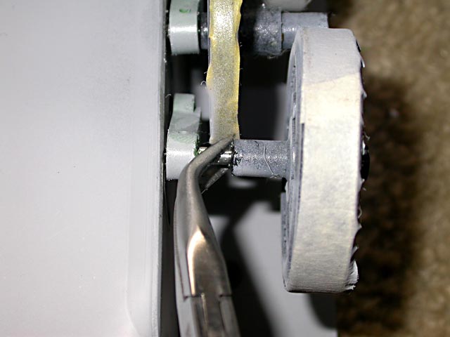

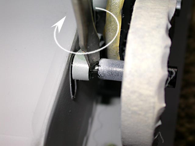

Q: How do I remove the road wheels from an HL Tiger I?
A: Insert a wide flat blade screwdriver between the suspension arm and the back of the road wheel. Then twist the screwdriver to pry out the road wheel. Once the wheel axle is loose, hold the suspension arm with the fingers on one hand while pulling the wheel straight out with the other hand. It is important not to exert any pulling force on the suspension arm because it might break. You can also use a small pair of bent nose pliers to pry the wheel out from the back.
