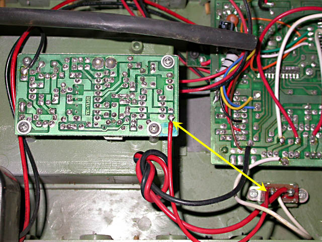

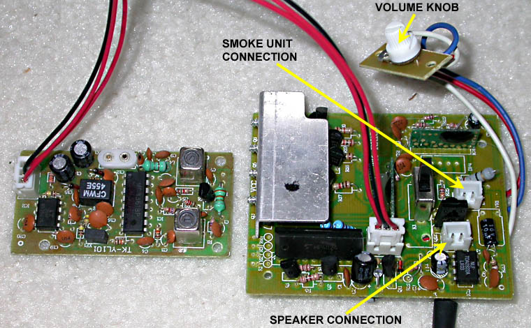

Heng Long Tiger/Panther smoke & sound board wiring. Apparently, it's OK not to connect the wire from the power switch to the receiver board, shown in the middle picture below, as reported by some people.
