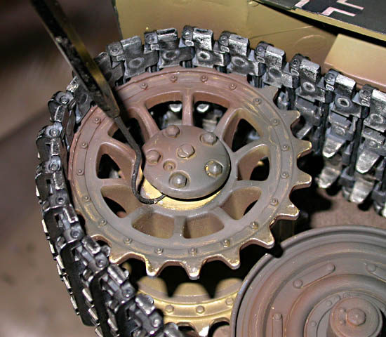

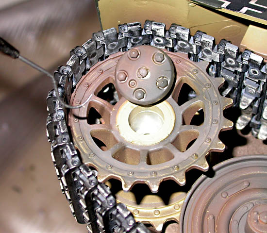

Q: How do I remove the drive sprocket from a Heng Long Tiger/Panther tank?
A: Use a small pick to lift out the center cap, then use a phillips head screwdriver to remove the 3mm center screw.
