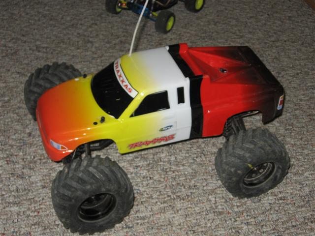

ORIGINAL: Thorough Hobbyist
I want to make the body on my Stampede a little lower. A website suggested cutting off a certain length and carving new nipples for the body pins to go through. But I'm not sure if I can pull that off without messing up and it will put my spare body posts to waste. Are there any aftermarket posts available with adjustable or lower height posts?
Is this low enough? All I did is take off the rear bodymounts and bought some front rustler body mounts like [link=http://cgi.ebay.ca/Traxxas-Stampede-Rustler-Body-Mount-Set-1914_W0QQitemZ260124398305QQihZ016QQcategoryZ44028 QQssPageNameZWDVWQQrdZ1QQcmdZViewItem]this[/link], and mounted that as in the picture. The rear of the body mounts with the body mount nub on the shock tower.
