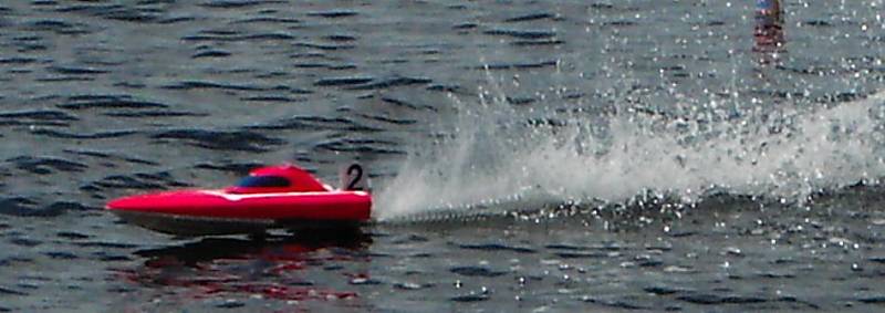

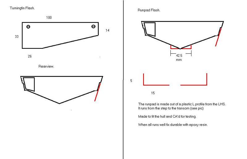

Here's a picture of the bottom of my Flash and a sketch, the red TF is my son's boat.
The runpad is made out of angled plastic from the LHS or building market.
You can tape them on to try it and epoxy them in place, if you like how she handles.
Keep me posted.
Regards, Jan.
