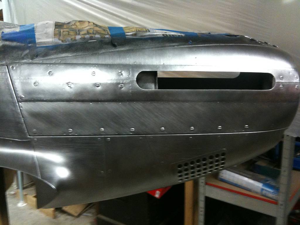

Hi I just painted a large P-51 mustang with Alsa Killer Chrome spray cans. It works great and gives a very nice finish. Basically you use gloss black for you undercoat and spray a very light dusting of killer chrome over that. I chose to steel wool the different panels at all directions to simulate a certain finish but this product would be worth checking out.
