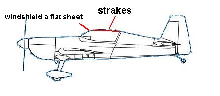

The next "usual suspect" would be the exaggerated bubble canopy.
There was a sport plane around here with somewhat of an Extra look, but slab sided.
The canopy was flat across the fuselage, although looking normal in the side view.
The plane got passed around thru a few fliers, as it was a very poor flier. Difficult to land,until one guy put strakes on the sides of the canopy at the top edge. About 1/4" square and not very long. This made all the difference in the world.
The cowl bulges are quite noticeable on the GP CAP 232 I have, and along with the bubble canopy could be disturbing airflow at high alphas.
So now there's two things to change... the cowl and canopy.
Yesterday while talking to Tony, I was observing his sport plane, the Top Flite Contender has a layout similar to the CAP; low wing, high horizontal. No ballooning problems.. and no fat cowl or exaggerated canopy.
#37
Joined: Dec 2002
Posts: 840
From: Ashland,
VA
Hey Paul tell some more about the strakes. Do these go on the side of the cowl and canopy longwise, and how big would they be? Also you said high alphas, when landing , this would not be a high alpha?? I'm not exactly sure what this means, I think. Thanks Kent
#38
The strakes were positioned here...
Flat fuselage sides all the way up to the top of the canopy.
The plane won 1st in a Novice pattern contest after the mod.

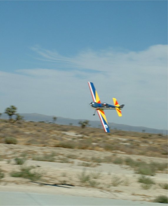

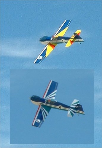

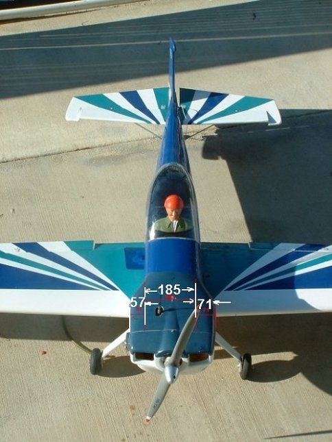

I'm prepping my GP CAP 232 for flight...
Measured the cowl width... the cheeks are 60% of the fuselage width.. there has to some effect, if only a burble along the fuselage sides.
OS 70, 102 oz. 23 oz/ft^2.
#40
Here's the way my CAP measured out..
I was surprised at the amount of downthrust!
Flew it today.
Wind 15-25 gusty.
Mostly slow stuff, low passes and touch-and-goes. Didn't oberve anything remarkable at all.
There was some ballooning, but only when turning from base to final, and that depending on the altitude... higher up it was less noticeable.. I attribute this to my not pulling the nose up to adjust the glide angle.
I did determine a 35% c.g. is too far aft.
Snapped out of a spin recovery! Too much elevator even on low-rate!
The c.g is going forward...
Here's a dimension photo....
And a few other shots...
http://www.angelfire.com/indie/aeros...CAP-232-12.jpg
