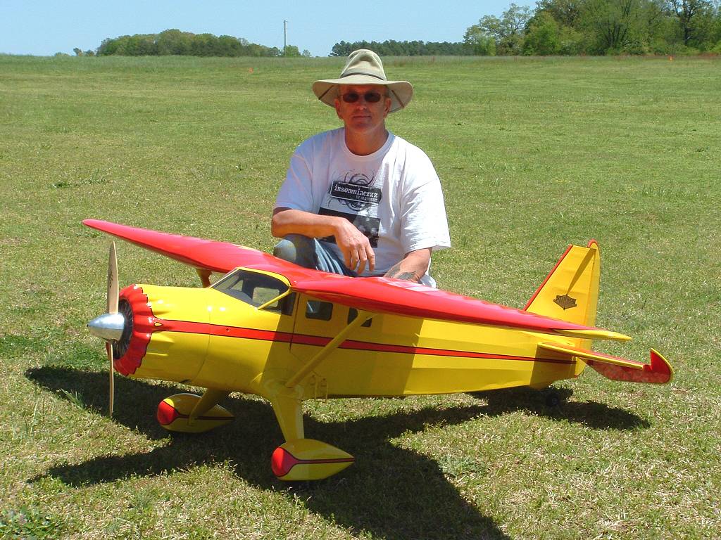

okay, if I have a 22lb scale plane with a O.S. 160 twin swinging a 18x6 "classic" prop putting out 7500 RPM and 11 lbs of thrust..pull if you will...will it fly? is there a general rule of thumb for thrust to weight? like minimums and maximums? [sm=confused.gif]

I assume you have this fair lady: http://www3.towerhobbies.com/cgi-bin...XNW28&P=FR
That being the case, I think you are pretty safe with that engine (and it is a beautiful one). The wing loading for the Stinson at 22 lbs is 34oz/sq ft which is high, but not tremendously high for scale flight (it probably won't snap roll
). It has a Clark Y airfoil at the root, which is a decently high lift profile, so you should be alright. Not meaning to insult your intelligence, but adding the flap option would help the groundroll too. Most of the easy flight calculations are for cruise, so getting to that speed may be a whole different problem. Either way, heavy planes eat runway.
These are all just estimations, but the reviews with that engine seem to be positive. Sounds like a pretty good match. That seems like a good RPM range too. We always say a stump-puller is better than a race horse if altitude is all you want

It should fly beautifly! Maybe as good as it looks static on the ground. Sounds very similar to a heavy L4 Cub I used to fly in terms of wing/power/weight. I loved it.
