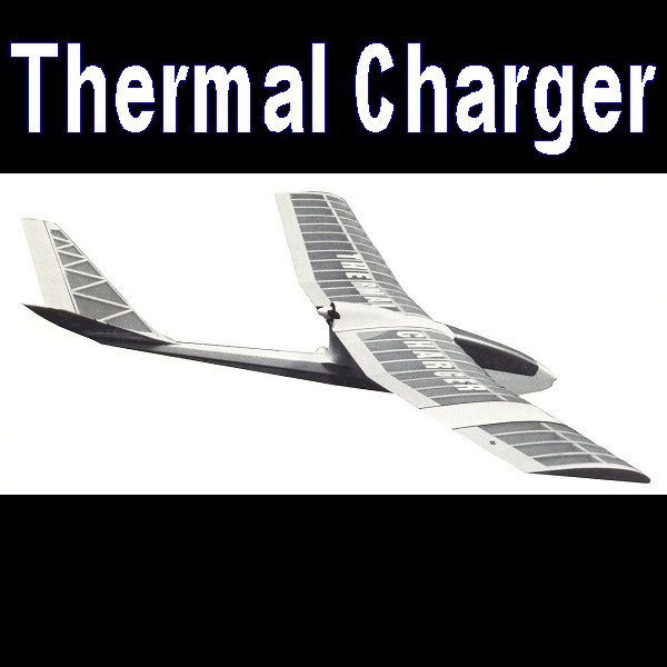

Where is the engine on that thing anyway? Looks to be high mounted on the front of the wing.
I'm right there with ya though. I'm converting a Bird of Time to a pylon wing with a rear mounted motor off the back of the wing like the Thermal Charger.
