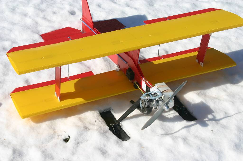

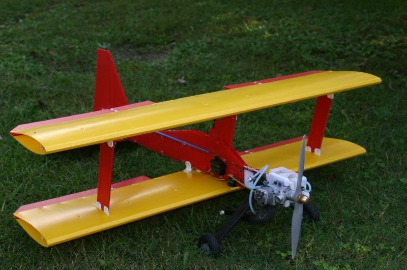

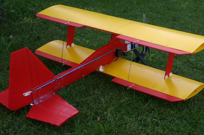

Hi JoelStolarski
I had the same problem with my SPAD Profile Biplane. I made a mistake with the CG and was forced to move both wings back to get the correct CG without adding a lot of weight to the nose. Plane flew perfect for about 5 years.
