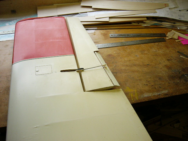

Old 08-02-2010 | 09:40 PM
Posts: 4,925
Received 5 Likes on 5 Posts
From: Kingston, ON, CANADA
Default RE: Boost Tabs
These are the tabs I use on a 1/4 scale Corby Starlett. Didn't know how much throw to use so I gradually moved in on the tab horn. When I hit the magic spot, it was like I put the next size bigger servo in it.

Old 08-05-2010 | 10:06 PM
Brandon15's Avatar
Joined: Dec 2009
Posts: 42
From: Glencoe, AL
ORIGINAL: MaxAdventure
ORIGINAL: wobblewobble
I put a Hitec HS 55 on my 40% rudder on the boost tab and I have had the best rudder authority ever!
This is the one I'd really like to see a photo of!
Very educational thread for me.....
Yep I'm working on 40%r with a DLE111on it that should be around30lbs and I chose to use HS-56HBswithBoost Tabs on all the surfaces.......
