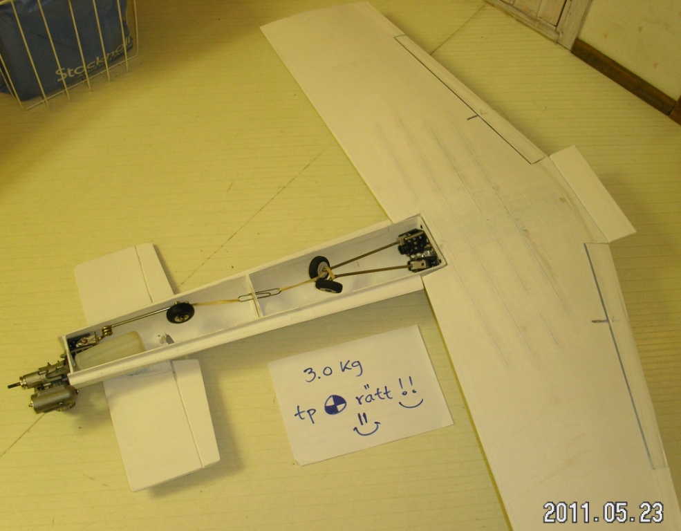

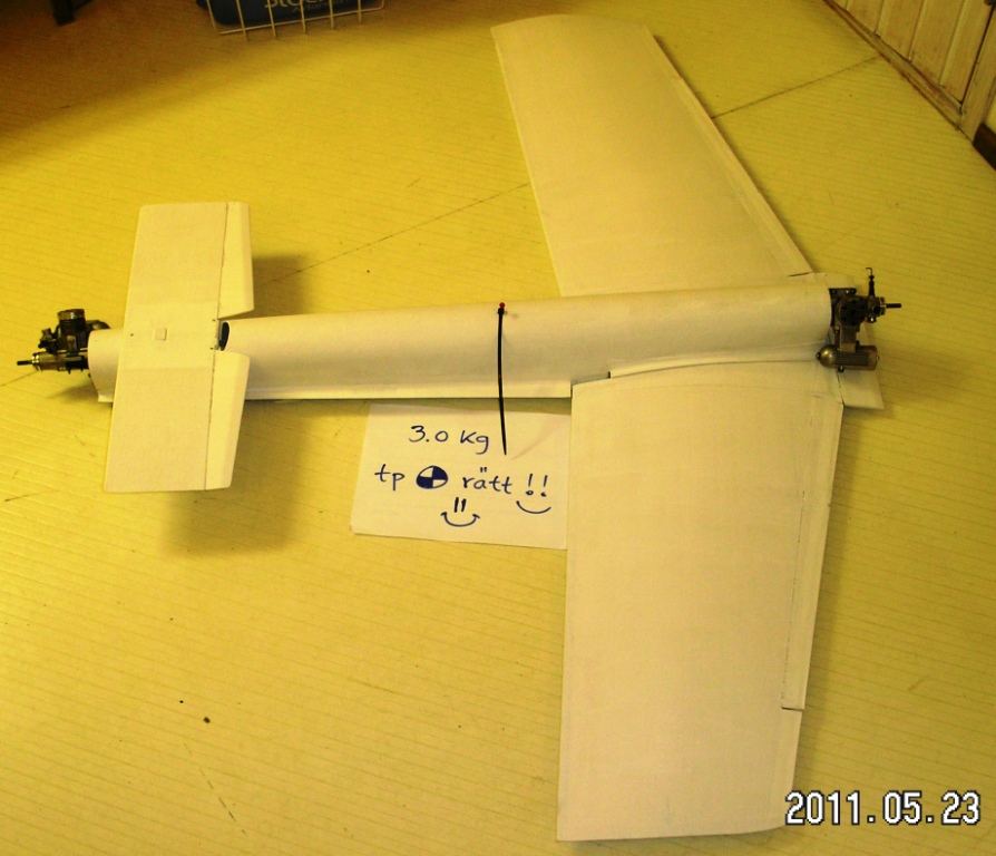

Hello out there, as a keen canard-designer I usually follow ”conventional canard wisdom” which goes something like this: ”...the canard foreplane MUST stall before the main wing to avoid the airplane to enter a superstall….” and further….” …usually the foreplane area loading of a canard should be about 150% of the main wing loading…”
Fair enough - this works pretty well if your canard relies solely on the foreplane flap to achieve pitch control. The backside of the coin is that with that high foreplane loading the prop wash of a tractor engine is instrumental in keeping the nose up. As soon as you approach for landing and shut down the engine the nose drops at a critical moment. Ask me, I have bent quite a few nose gear legs before learning the technique to land such a ship.
OK, after this little “lecture in canardology” I come to my real purpose of this thread which is to get your input on my new canard design taking shape in my shop (see pics) This is a different bird resembling the famous X-29 or Su-47 Berkut and having both a front and a rear flap for pitch control. In addition to that of course the possibility to use elevon mixing on the ailerons for additional pitch control.
Now to my question to you: What foreplane loading would you use on a machine like this and how would you configure the different flaps to achieve an airplane with a large speed envelope, good turning performance, no bent nose gears and no superstalls…???
Please let me “pick your brains” on this one before I decide and set her up for the maiden flight….Thank you…Cheers/Harald

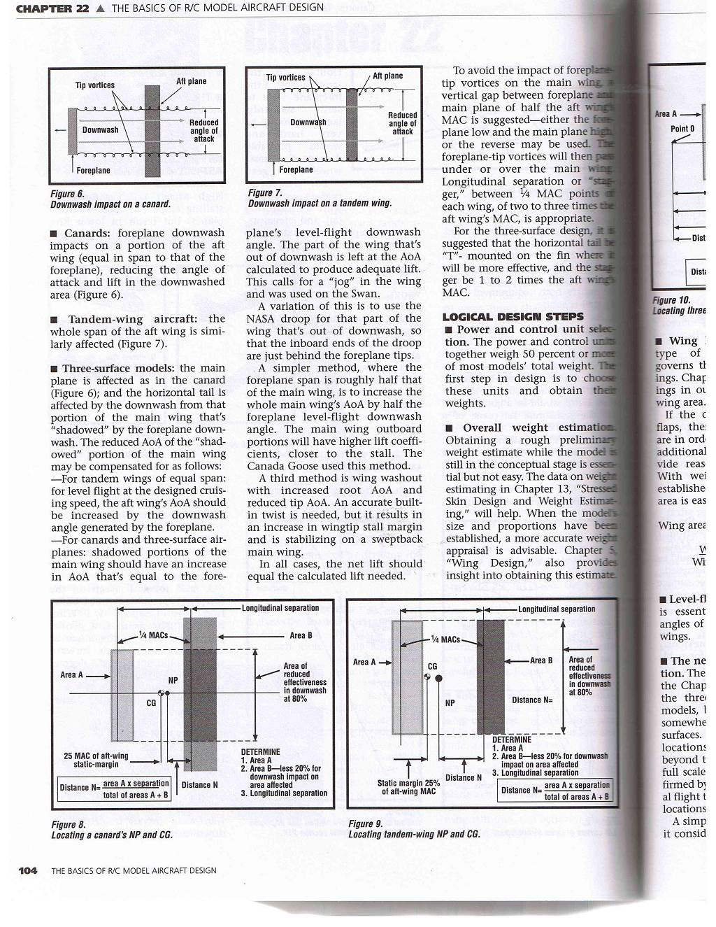

Hi all and thanks for input and for replacing the thread.
DAN: I already have Andy Lennons book and he prescribes a "static margin" of 25% MAC of main wing (Fig.8, p.104) which is heavy loading.
The calculator is a bit more "daring" with a static margin of only 5-15% of MAC, I have that one too in my ´puter.
Lnewqban: I have most of Andy Lennons articles already and he elaborates only very little on static margin in there.
So we are stuck with "conventional canard wisdom" so far.

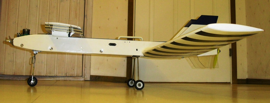

Let me give you an example of one of my creations (see pic) which superstalled twice for me at a foreplane loading of 180%....[:@]..! One of the superstalls was even inverted..Quite a show but only two broken fins. Had to increase up to 200% loading before that monster stalled with a "mush" of the nose.
And that behaviour is exactly what I want to avoid with this new FSW canard - hence this thread and the aft flap.

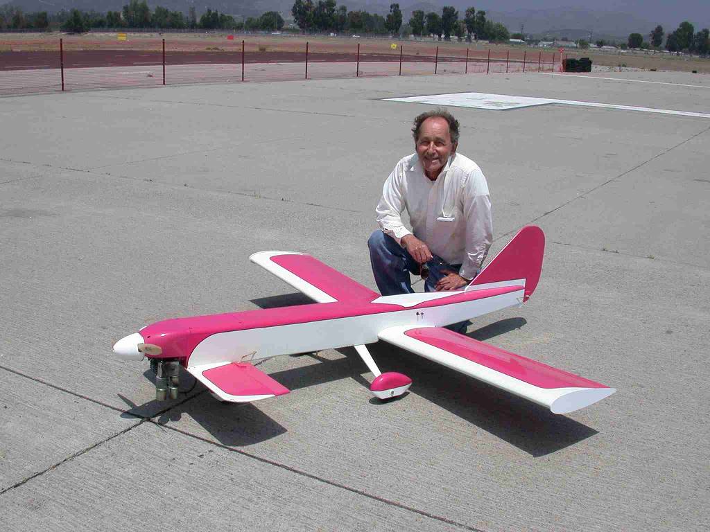

Harald, Thank you for the compliment. I put the canard on the bottom at first for ease of construction. Whenever I pitched the nose up, during landing, the model always lost altitude. I thought this was because of blockage of the wing surface. I eventually relocated the canard to the top of the fuselage and got some better results but not much. The real trick was to land faster. I also had the canard set at +2 degrees. The wing was at 0 degrees. Here's an image of another one I designed. This was a great flyer. Unfortunately a midair led to an early demise. Dan.

Thanks all for more input. I think I will try 130% loading next time - good suggestion allanflowers..
And then I will skip elevons and just use the fore and aft flaps in parallell with a Y-cable for pitch control. I usually have main wing at +1 degr. and foreplane at +3 degr.Will start out without deplyment of landing/starting flaps. And then fly initially without forcing a stall until I get used to the ship.Waddayathink about that guys..???

I don't think the foreward wing is made for lifting More for control.But, If you were thinking about loading you would have to increase the size of the Forward wing and actually treat it as a seperate wing.To eliminate a stalling problem front Wing may have to be Larger than Rear?
Dan: it appears from pics above that all three canards of yours have rather high foreplane loading..! I deduct that from your placement of the main gears. In particular the big one on the left in post #2 - still with the nosewheel on the ground..!! Is there any possibility for you (or me) to calculate your foreplane loadings..??
Regarding placement of the foreplane vs. the main wing "conventional canardology" maintains that a high foreplane is better since the downwash goes over the wing rather than under it.
Further as you so correctly said it: "the trick is to land faster"....I fully agree but I do not like that. Would be nice to be able to land it like a delta with very high aoa but that is not easy to obtain.

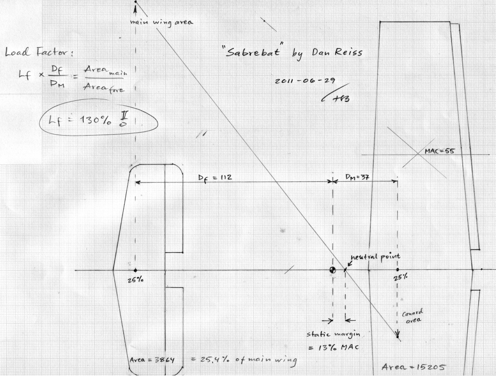

Dan and Villa, if you have plans/drawings of your canards and know the c.g. position I can easily calculate the foreplane loading my way and share the results with you..?!?!

Villa, thanks a lot for your plans which I have missed. Made a quick calculation on the "Runard" and found that your foreplane is very lightly loaded. With the proposed c.g. at 3" ahead of the main wing L.E. you have a "static margin" of 3% MAC and a foreplane loading of 110% (see attached drawing) I hope I made it correctly it is sack time now here in Sweden.
Dan: would it be possible to do the same with some of your canards..?...Good night/Harald
Dan, here is my calculation on your Sabrebat. Rather conventional but on the light side with a foreplane loading factor of 130%.
The problem with most calculations - mine and the linked calculator given by Villa - is that they do NOT take the lifting force of the fuselage into account. And most of the fuse is in front of the c.g. which means that Lf must compensate for that also. No problem with you Villa having an aluminium spar as fuselage...
That is the reason why Dan (and others) must load the foreplane more.
Now sack time again...Good night./ Harald

Here's another drawing if you want to calculate on it. The grid is 100mm. The CG is shown on the side view at the leading edge of the wing. It has a full flying canard, leading edge slats and flaperons - the last two features couldn't be used because I would run out of elevator to match the additional wing lift. This model was much too heavy (the wing complications and retracts didn't help) and, after a few flights, found its rightful place as a hanger queen.
