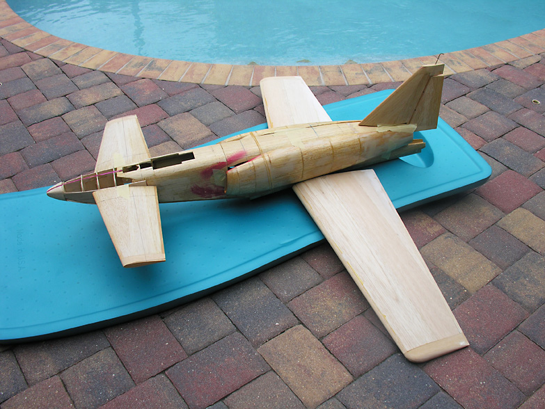

Old 07-28-2011 | 06:33 AM
  #29
Posts: 3,157
Received 6 Likes on 6 Posts
From: Jupiter , FL
Default RE: canard foreplane loading..??
Canardlover,
Nice models!
Hey! Does this have potential?
ID:	1641229   Click image for larger version
ID:	1641230   Click image for larger version
ID:	1641231   Click image for larger version
