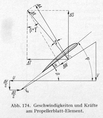

Well Evan, that kid's stuff has been proven full-size. You could try yourself with a single-engine Cessna (it helps if it's one with a big prop). Run it up statically, change flap deflection and watch the left-tendency changing as well. Precession of the helical propwash isn't limited to twins.
The first drawing from the book shows what happens pressure-wise and speed-wise and why the propwash is constricted. The "outside" pressure should make for constriction and centripetal force.
The second drawing shows what happens on a blade. Lower left shows axial (thrust) and tangential (spin) speed difference caused by the blade. I wouldn't expect that on the tips, though, and put streamers inside the propwash.
Third drawing shows maximum effect at 75-80% of radius, zero at tips.
How far behind the prop the slipstream vanishes is another question, as well as how it's spoiled by wing and fuselage. Anyway, I respectfully stay away behind an airplane running up its engines. By the way, the picture of the Hercules shows what happens to the propwash when it's "cut" and deflected by the wing.

Tomski,
The idea that spiral slipstream is just something dreamed up by modellers and 'stick and rudder', is something that in reality you seem to have 'made-up'. Spiral slipstream effect is mentioned in many authoritative sources.
For instance Don Stackhouse used to design propellers for a living, including such famous props as that which powered Rutan's Voyager around the world.<a mce_href="http://www.djaerotech.com/dj_askjd/dj_questions/propeffects.html" href="http://www.djaerotech.com/dj_askjd/dj_questions/propeffects.html"><font color="#0000ff"> Here' a quote from him:
</font></a>
Perhaps even more convincing; Dr Martin Hepperle, whose doctoral thesis was titled "A Contribution to the Aerodynamics of Propellers, taking a Free Wake into Account" and whose Senior Thesis (written in conjunction with Prof R. Eppler) was titled "A Computer Program for the Design and Analysis of Propellers" <font color="#0000ff">says the following</font>:
Readers of this thread can make up their own mind but personally I'll go with the learned opinion of those acknowledged as world experts in the field of propeller design, Plus of course my own practical experience (and to be honest basic common sense).
On the other hand we have your opinion which is backed up by....errrr...nothing
Steve
</font></a>
.....the torque of the motor, applied to the air by the propeller, is what makes the air in the slipstream swirl, and that swirl is ultimately responsible for many of the slipstream effects................................
Rolling and yawing slipstream effects are due to the helical swirl that the prop imparts to the slipstream interacting with the various parts of the airplane behind it. The classic example is the slipstream of a right-handed prop swirling around the fuselage and then striking the left side of the fin and rudder. This tends to shove the tail to the right, which therefore yaws the airplane to the left. Slipstream effects are influenced by power and airspeed (these influence how much swirl the prop imparts to the airflow)
Besides the contraction of the stream tube, a propeller also adds a swirl component to its outflow (wake).The amount of swirl depends on the rotational speed of the engine and eats up energy, which is not available for thrust anymore. Typical, well designed propellers loose about 1% to 5% of their power in the swirl of the propeller wake. The swirl angle (about 1°...10° ) may cause non symmetrical flow conditions on parts behind the propeller, e.g. at the tailplanes.
Steve
