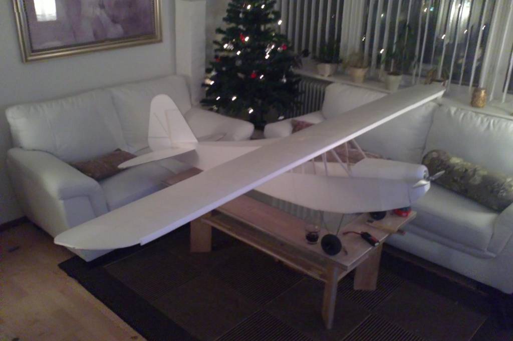

Anyone knows some freeware program, for calculating stallspeed, by input data as airfoil, span, corde and weight?
Or - can anyone calculate expected minimum stallspeed for me?
Known data:
Airfoil Clark Y 13%
Span 276cm / 108"
wingcord 43cm / 17"
total area of stab 10dm2 / 155 inch2
expeted weight 2kg / 70 OZ
the project is a 1/4 Cub in depron. Pictures can be seen here ( sorry, all written in danish)

You need to determine what is the minimum air velocity that will sustain the weight of the model in horizontal flight, solving V from the lift formula.
Since that flight condition will be possible only at the maximum practical angle of attack (just before stall starts), the max CL needs to be found and used.
Vstall = Square root [ 2 * weight / (wing area * air density * CL max)]
For exact results, you need to know the maximum coefficient of lift for that wing at the speeds it will fly.

As lneqban says, but for model airfoils, Cl max can be taken as 1. It don't seem to matter what shape the foil is, at our sizes there is little to choose between them so far a Cl max is concerned. Most of the airfoil data available is for full size sections and does not relate well to model sizes, for example. Cl max for this sort of wing occurs around 14 to 16 degrees AOA, but the model foil will stall around 8 to 9 deg. AOA so will never reach the published Cl. The other question I would raise is; what use is the information going to be? Unless you have very accurate telemetry from the model to you, you will have no idea how fast the model is flying. Knowing the stalling speed will not be much use otherwise.

Thanks for replys.
I just wanted to know how slow it will proberbly fly. So I could get an idea about, is it possible to fly in our gym
I didnt need to know it very precisly.

While I agree with this in general terms for smaller models (in fact Clmax can be as low as 0.6-0.7 due to low Reynolds numbers) bear in mind that with a span of 43cm at 5m/s the Reynolds number is almost 150k.
I have experimental data from Selig which shows Clark Y acheives a Clmax of 1.3 at Re 100k.
Using Clmax of 1 won't be far off as a conservative starting point, but CL1.2ish may be possible - ie slower still.
I have a feeling that the airfoil on Polle's Cub is not proper Clark Y though? Maybe flat bottomed 13% instead...

A few more explanations on this aircraft and its construction / weight:
It is built with the aim to fly outdoors with a 800w setup. For the casual flight, but also for 3D.
If I only was going to fly indoors, it was obviously built differently
And I just wanted an indication - will the speed be 10 or 20mph.

This evening the Cub was in the gym. We got access to 2 gyms, and this was the small of them, so I was just going to try out the groundhandling, or should it be floorhandling in this case? Perhaps let it rotate and lift a wheel.
At very slow speed the tail lifted, and I almost P in my pants when it short after was airborn - that wasn´t intended. Here showed up a problem: the long offrun when it touchdowned again.
I did a few of these short take-offs and touchdowns, and that should have been that.
The other guys had other opinions, and it went out with some half and full cirkels.
It was all with shaking knees and fingers, and true chicken flying, but it flew.
