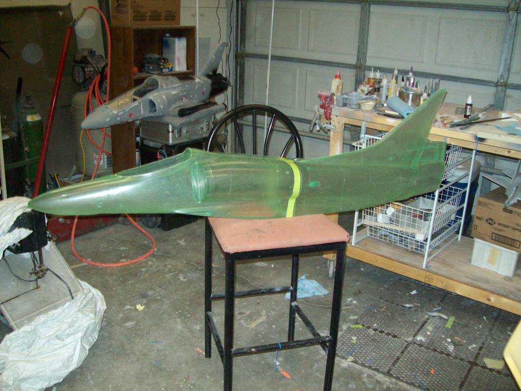

REPLACING A BYRON A-4 WING SET. DONT LIKE THE FOAM THEY USE. I THINKING OF USEING A NACA 9% SYM.AIRFOIL.. NOT A CAMBER ONE. NEED LESS DRAG. BUT ALSO WOULD LIKE TO HAVE IT PULL TIGHT TURNS.. MY SECOND CHOICE WAS A- RG 9.3 AIRFOIL. .045 NEG.MOMENT.. MAY NEED 1 DEG POS. IN MAIN WING OR .5 NEG IN STAB.. ANY OTHER SUGGESTIONS?? THANKS LOOKS LIKE EPPLER 193@ 9.1%1.5 %CAMBER. DONT HAVE DRAG INFO YET..

To both go fast AND be able to pull tight turns you are best off looking for an airfoil with some low amount of positive camber. When you look at the Cl vs Cd chart look for airfoils that have the more vertical portion of their lift where the drag changes but little centered at around the Cl=0.3 region of the vertical axis. You want an airfoil which extends this more vertical portion down to the Cl=0 like and up as high as possible but which still gives you a good thin airfoil to work with.
I'm not familiar with the airfoil used on the original model. But it's highly likely that you can put the new wing onto the fuselage at the same angle as the old. Then play with the CG location to achieve as small an amount of pitch stability as you can manage. Doing so will aid in allowing the model to turn as best as possible.
A degree of washout would likely not hurt either. But if you use too much washout then the tips will be flying at a negative angle of attack at high speeds and produce more drag than you want. But around -1.0 to -1.5 degrees of washout SHOULD aid in avoiding tip stalls in high G turns.

I tried cambered airfoils-{1-2%}- in the simulator. ,,on jets only.. I can feel the change alot. But they are slower.. 22 inch root,6 tip ,span 19 inches..1.4 Aspect...tip stall to death!!! lol.. I found on my F-22, planform, over rides, airfoil..Like ,F-15..Reflex helps with C/G on this crazy planform.. I have had 3 YELLOW AIRCRAFT A-4.They use some kind of cambered airfoil,..Pulls great through high banked turns.. May go more span ,and less L/E sweep. Then, i will feel better about no camber.. Thanks for building tip..

Thanks for info. Can you show me a "WIDE" drag bucket airfoil or a pic.?? I never added camber and made less C/L..?? I did some crude test.. A.O.A ,adds C/L faster,per deg., than camber does. But camber stalled, slower and later. ?? Also, L/E radius. was super critical.. You can see how crazy this wing planform is from pic...Thanks for info. and time...

Yep . I cut new cores , with more span,less sweep and wider tip.... Im still not sure what to do yet.. Im sorry ,but i found the,little "magic" we use on the wings do help.. Fences,vortex generators, L/E RADIUS for sure. Crow also on many aircraft.. T-45 is a DEMON ,without these design patches.. what planform wings do you fly?? Thanks for info and time

Found an airfoil that you can add camber and still has- 0- pich moment. Used 1.5 at root anr 2.5 at tip. 2 inch more span per side.
