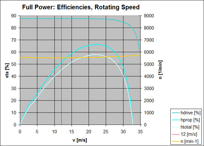

#109
Did only a quick check and it showed that the prop pitch could be too big (the Graupner 20x12 would be better) and the NEU drive could be too powerful with a 10s battery (8s would be better). The drive's efficiency would be below 50% but 18k ft could still be made with a 12 Ah battery.
Yet the whole mess has to be re-thought again. (Maybe even less pitch, maybe even bigger prop or, since there is no such prop anyway, BMatthews' idea of a twin.) After all this was only a quick check, not a thorough one.
By the way, if you define two different mission profiles it could well be that for the 18k ft mission, which is determined by climb, a low-pitch prop is best and for the 5k ft mission, if it's determined by cruise, a high-pitch prop.

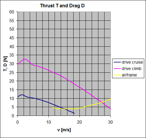

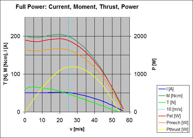

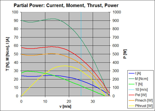

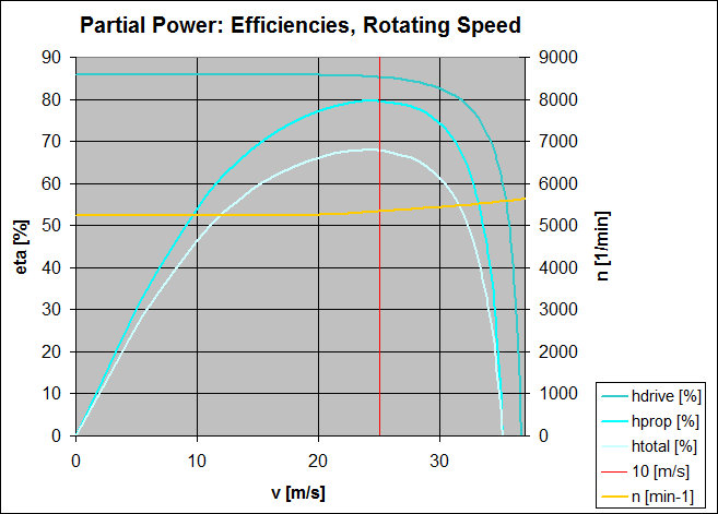

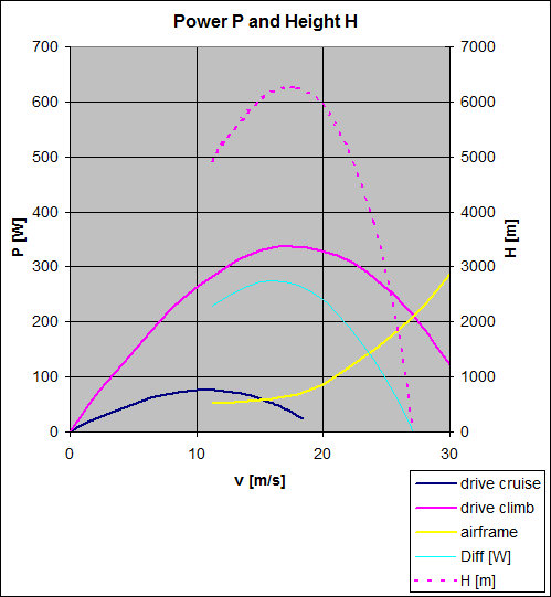

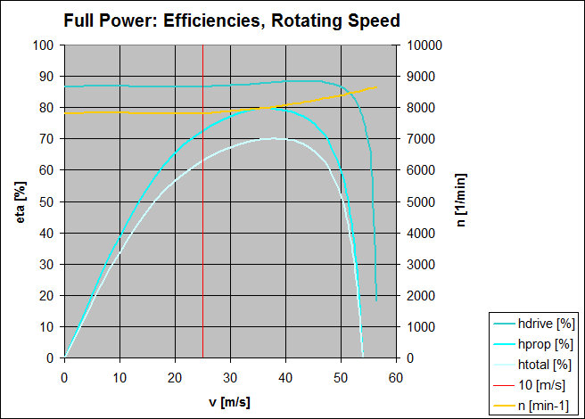

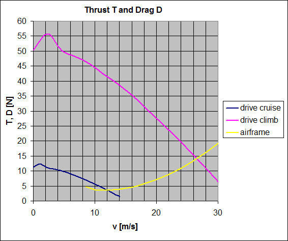

Thanks, now it's clear.
Just to show what "quick check" means a few diagrams. I know it's not really an explanation, at least for non-engineers, but anyway (because it's fun for me).
The NEU-F3A-1 (1300 kv, 6.7:1 gear) was assumed with the data published on the website. Impedance of ESC, battery (8s 12 Ah LiPo), and so on is only estimated. The data for the Graupner CFK 20x12 prop are calculated with Martin Hepperle's program and quite reliable, except near static. A rather simple airframe was assumed with 20 lbs weight, 2200 sqin wing area and 5m (197") span, giving 17.6 aspect ratio. (Quite ambitious, and seems no case for a composite construction, at least for wing and tail.) Horizontal stab is 20% of wing area and vertical stab 10%. Tail moment arm 51". Airfoil is Anderson SPICA flat bottom (sorry BMatthews) because it's quite cambered (4.62%) and I have data.
Now all is put together in spreadsheets. I made these 10 years ago and unfortunately didn't automate them so far because I dislike Excel programming. So they are virtually useable only for me. I will share them anyway if requested.
First a comparison of drive rpm and efficiencies at ground level (standard atmosphere), full power and cruise power. Yellow is rpm, dark blue motor-gear efficiency, medium blue prop efficiency, light blue total drive efficiency, that is the power effective on the airplane. All dependent on airspeed. The airplane's minimum power demand is at 12 m/s (27 mph) airspeed.
At full power the drive's maximum efficiency would be at 23 m/s (52 mph) so in this case the prop's pitch is too big. Second diagram the same except at partial power (0.465 of full power). That's just enough to cruise at 12 m/s which is not the absolute minimum speed/power but still gives a small amount of speed stability. Now the drive's maximum efficieny is at 10 m/s (22 mph) so the prop's pitch is a bit too small. That's what I meant in my previous post, but it's merely a "theoretical" comparison. What really matters you'll see now.
Yellow is drag of the airframe, pink is drive thrust at full power, blue at cruise power. It's not easy to imagine at which speed the height will be maximized. Next diagram: yellow is airframe power consumption, pink is power delivered to the airframe at full power, dark blue at cruise power setting. Light blue is difference between full drive power and airframe power demand. This difference is climb power. Dotted pink is reachable altitude/height with maximum 6700 m (22k ft) at 16 m/s (36 mph). Climb rate is 5.6 m/s (1100 ft/min). Of course that's ground air density.
But next two diagrams show the case of about half ground density, that is 18k ft. Because the air is thinner the airplane flies faster (airspeed 17.5 m/s, 39 mph) for maximum reachable height. This reachable height is slightly reduced (6300 m, 20.6k ft) because the power delivered is lesser and a bigger part of it is needed to overcome drag. Here you see that the airframe's aerodynamic quality is still of minor importance (maybe except aspect ratio). But cruise flight requires a higher power setting (0.605). Climb rate is 3.1 m/s (610 ft/min). So even though some parameters change with altitude and climb rate gets lower and lower, target altitude could be reached with even a bit charge in the battery for some loitering and landing approach.
There are no reserves which means the accuracy (not to mention correctness) of this calculation would be crucial. So no responsibility is taken for the correctness of this information.

Very good job!
You deserve credits for that.
Also nice to make graphs of it in excel.
If i were to do it, I would just stick up the calculations in plaintext.
Making graphs makes it a lot more readable, especially for those not so into mathematics.

Thanks! As to mathematics - count me in! I can't imagine these things in abstract form (equations) and need something visual. That's exactly why I made these spreadsheets. And once I had them I found them very enlightening.
The 18k ft case has been adjusted (Reynolds number, airfoil coefficients) and isn't quite as "quick" as before. Looks even better now, but still more drive efficiency is needed, that is less power per prop disk area. The airframe's power demand is a given so more prop disk area is needed.

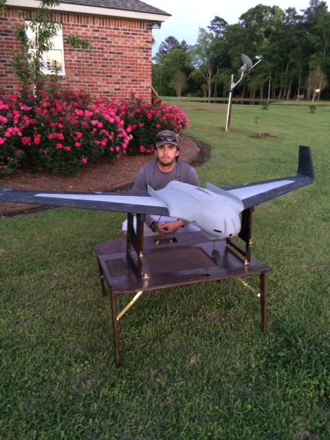

After two years since the last post to this thread, I've finally made full circle on this project. The pictures above shows an x-8 that once was a foam FPV kit that has been modified heavily in order to be able to serve as a platform for my senior design project on bioprecipitation. In addition, I've teamed up with other professors at my college to use this UAS for land erosion studies and general agricultural remote sensing.
As for constructing the airplane, all surfaces were fiber glassed with .6oz cloth. The vertical fins on top were added to aid in yaw stability. Lower rails were added for attachment points for gear. Both rails have two servo hook-up channels for auxillary purposes. Leading and trailing edges are laminated with carbon tissue to minimize wing flex at the tips and to increase overall durability. E-flite 60-120 retracts were installed. The center portion is a 2 axis camera gimble. The front nose rails were added for a crash landing bumper. The list of modifications goes on...
Thanks for all the previous interest/comments. You guys aided in motivating me to fulfill this project. The first flight is just around the corner, which will be a normal R/c piloted flight. Subsequent flights will be guided via GPS and on-board microprocessor. Only take off and landing will be flown by traditional R/c methods.
With respect to the original thread's purpose, 3x5000mah 5S packs are going to power a 2Kw motor. Hopefully this can carry us far and high enough to do all that is needed. I believe max prop clearance is 16 inches.
Brandon Landry
