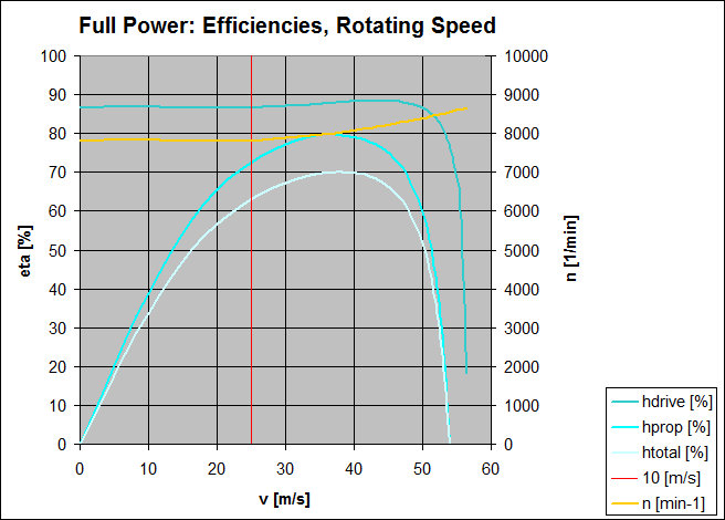

Let's be helpful - very good idea. Seems to be not that easy though...
To throw in my 2 Eurocents, I think the general concept is a given and requested is only information helpful to put it into practice. Shoe showed on the back side of an envelope that it can be done, so we think about how it can be done.
Climbing to 15k ft and cruising there is possible with an airframe as already suggested. For me the discussion showed that a narrow (high aspect ratio) wing is most important, but not planform or streamlining. Airfoil may play a role. The airframe's overall design determines how good it climbs and at what speed.
Now the electric drive has to match it to get the high efficiency required (65%) at that speed. It has been said here several times that an as big as possible propeller should be used. That's far more important than pull/push or other design features.
There are some well-designed (basically efficient) carbon folding props, just the suitable diameter and pitch has to be found out. High efficiency at low speed requires a slow-turning prop and drive. There are some low-kv outrunners, but maybe a more conservative outrunner or even inrunner with a gear would be better. (Gear has been mentioned before as well.) There are ready-made outrunner/gear combinations (e.g. AXI).
Attached pictures show characteristics of an F3A drive by AXI. They go to show that the prop determines the drive's overall efficiency (prop, gear, motor, ESC, battery, cables, connectors). And that efficiency has a marked maximum at some speed (the light blue line in the second diagram). In this case, though, the required 65% are achieved between 27 and 46 m/s. That should be too fast for this project but that just means one has to choose/layout the drive differently. (That can't be done on the back side of an envelope, but it's not that hard, either.)
Another small but maybe important aspect comes to mind. Climb and cruise are quite different modes for the drive. To get better efficiency in both modes full-size airplanes have variable-pitch propellers. There is even an automatic variable-pitch hub for model folding propellers, as presented in the glider forum a while ago ([link=http://www.rcuniverse.com/forum/m_10815942/tm.htm]here[/link]). Might help a bit. (Dang. Seems to be no longer available.)
Last picture a typical pusher configuration, for aerial pictures in this case.

#71
Good post UStick.
I might add that full sizes also use variable pitch for much the same reason that a car uses a gearbox:
To allow the engine to spin within its useful operating range, across the whole speed envelope of the car.
Electric motors has much broader and efficient operating range than any combustion engine, and hence is the benefits of variable pitch much reduced.
Ex. Lotus Elise, the "mother car" has a 5 speed gearbox and combustion engine, while the Tesla Roadster "daughter car" has a 2 speed gearbox and electric engine, and still outperform it in a straight line.
So the question is wether or not the extra complication, weight and "source of things that can go wrong" with a variable pitch propeller is worth it, when mated with an electric motor which has much less benefit from such a propeller.
I believe this project is complicated enough as is, and that keeping things simple (or as simple as possible) is important.

I'd have to bow to those that know more about how propellers are affected at lower altitude density. But consider that this is pretty much a climb then glide style flight pattern. To reach up to 5000 to 15000 feet with this craft about half or more of the flight time will be spent in the climbing. So for THIS case it is the climb phase rather than the cruise phase that will be the mode that shapes the design of the craft.
There's been some mentioning of the idea that there may already be suitable craft available from other universities or research groups. It would certainly be worthwhile looking into what they have already.
There is also a lot to recomend the idea of twin tractor motors over the idea of a single motor pusher. The tractor motors could be out on the wings where they can still have a good size propeller diameter for good climbing efficiency while keeping the nose of the fuselage clear for sampling intake openings and camera lenses. Such a configuration also gets away from the rather cumbersome twin boom layout that is needed for a larger diameter pusher prop. I know it doesn't mattr much when at the field or in the air. But at some point you need to pack the whole thing up and take it back to the storage area. It also reduces the need for additional strength in the tail surfaces since they are no longer a structural element that joins the two tail booms.
#74
ORIGINAL: BMatthews
