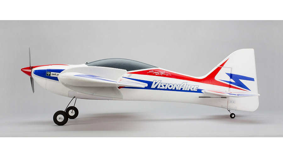

For really forgiving but maneuverable flying - a low aspect ratio very thick wing is also good - it is pitch insensitive
The new little VisionAire by Horizon is a prime exampleof this approach.
