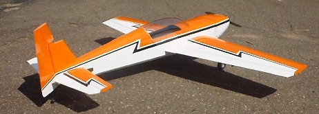

Holds KE fine at 3/4 to full throttle with little rudder deflection. Its when I slow it down and add more deflection that things get strange. Flew it again tonight...acts like when you apply rudder to pitch the nose up, the fuse has a reaction and wants to bounce back to level flight. I suppose it could be the very long tail moment, lots of fuselage side area behind the CG. This is only a 24% plane. Have a JR 8411, 155oz servo on kevlar pull-pull, no gyro.

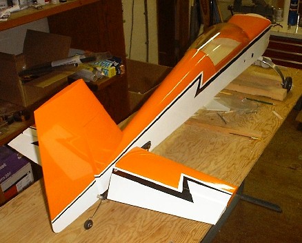

Here's a picture of the fuselage, and the big rudder...is this considered a sharp trailing edge?
Kevin
Kevin
My Feedback: (44)
Its a rounded airfoil tail, if thats what your asking. I think a flat plate tail is also considered symetrical? Its the same on both sides.
Plane is a Colombo Anderson 24% 300L kit. Balsa sheeted foam surfaces. I'm calling it a Extra stretchy.
I'm starting to think its a very sharp trailing edge, considering how long it is. I could try a fuel line on the trailing edge next flight.

From your picture, the rudder deflection seems to be around 40 degres from the center?
If we put those number in servo calc software we have:
Rudder
Average control surface chord (cm) 23
Average control surface length (cm) 36
Optional: Maximum available servo torque (oz-in) 155
Maximum deflection of servo arm from center (degrees) 42
Maximum deflection of control surface from center (degrees) 40
Maximum required torque at maximum airspeed (oz-in) 155
That rudder is so huge that we would need 2 servos in parallele to maintain 45 degres deflection at full speed. Amazing!
I think your servo is not enough strong to maintain its position at 3/4 throttle.[8D]

How are you coming up with the average rudder control surface cord length of 23 cm?
My rudder measures 35 1/2cm tall at the hinge line
18cm at the bottom cord, back of hinge line
10cm at the top cord, back of hinge line
I think that gives me a average cord of around 14cm
Need to remember the rudder area forward of the hinge line is not loading in the same direction as the rear.
What do you think??

Thanks to everyone for your responses. The full scale input is especially interesting. One thing missing from our models is the control surface feedback you only get while hanging onto the controls in a full size plane.
Got in a couple more test flights earlier this week. First up was a 1/4" balsa stick taped up the back side of the rudders trailing edge. No real improvement in KE angle of attack control, but it did dampen much of the waggle out . Plane seemed to track better in general. Most noticeable was how well the down side of a stall turn tracked. Also noticed less pitch coupling to the belly while in KE.
Next up was a rearward cg shift of about 1/4". This change along with the trailing edge rudder stick was indeed heading in the right direction. The plane would now maintain KE at about half to 3/4 throttle. Adding power, it would climb. So, it seems that cg is the major factor in how well this plane will high alpha KE. I have a feeling that because of the longer than scale tail moment, the KE cg is shifted farther forward from the canopy area than is normal for an Extra. Seems the long fuselage makes the plane so stable, that it resists any yaw control inputs. Could be the reason the designer used such a silly large rudder area? It looks impressive, but its really just balancing out the long fuselage, and just breaking even.
