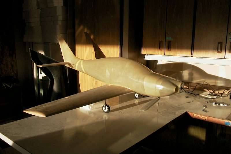

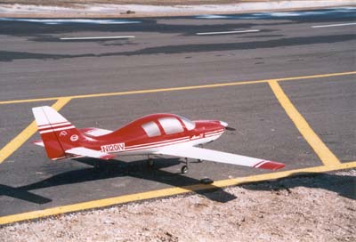

It is for an 80" Lancair IV. I am currently looking for a foam cutting company that can cut cores for me, so I would like to give them the airfoil in electronic format. I've attached a couple of pictures of a finished plane and one I have almost ready to paint. I am also working on a Lancair ES version with a 96" span, the test flight should be in the next two weeks or so.

Thanks for the information on the 2048. I am planning a scale model of a Cosmic Wind and was thinking about using a S8036 for the root, and S8037 for the tip.
You've done some fantastic work on that model. I'm jealous! I don't think I could make a plug like that. Mine will have to be the 'old fashioned' way of using formers and sheeting.
Really nice work. I'm just getting started in scale and my techniques could use some work. Hopefully I will get to your level some day, judging from your model...
