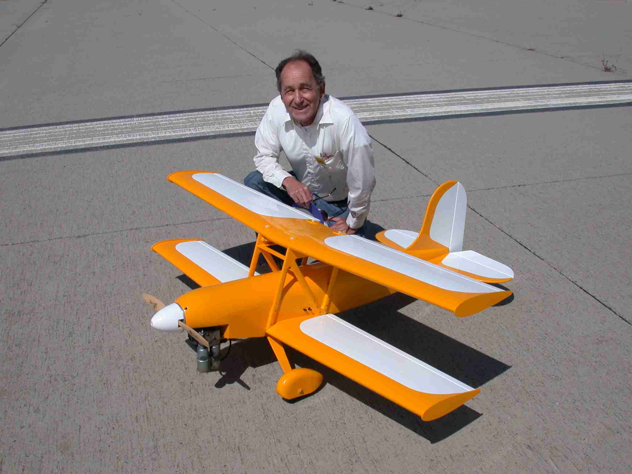

I did the maiden on my Pitts today and it took about 4° of down elevator to fly level. The plane is a tad nose heavy so this should not be. The H stab is a set 2°, the wings are set supposedly at 0°, with no down thrust on the engine. Which area should I be looking into for adjustment to correct the elevator?

Just spent four hours at a friends garage going over everything. The wings are 0°, stab 1-1/2°, and the engine is just a tad down maybe 1/4°. The only thing I can figure is it is either tail heavy or needs more down thrust on the engine. The balance will get checked again tomorrow. Down thrust is not the direction I want to go if it can be helped, way to much disassembly to get to the engine mount bolt nuts. I am considering adding a lb to the nose and see what that does. I will figure something out and with the suggestions here I have plenty to think about.

Woo Hoo! I have figured it out, you know, why the ele is trimmed down. I have been racking my brain over this as it just did not make sense to be with it not being tail heavy. Well, turns out, it is tail heavy. Here is what happened. I was trying to figure out how to send the spreadsheet to a friend where he could open it, turns out it is his computer and not the spreadsheet. Anyway, while I was working with it I decided to run the numbers one more time. Yea, I'm anal enough to have wrote down the figures. And the first time I looked at it and thought "Yep, it says I am nose heavy". And just as I cleared it something went "Whoaa dum azz". So I punched them in again and it turns out I was reading the results wrong, the spreadsheet was telling me what the tailwheel should weigh and for some reason I was reading it as to what it does weigh. I have no idea why, I mean come on, I just typed in the actual weight, but somehow. Duhhhhh!!! It is a tad bit tail heavy which for this plane is very tail heavy as it really needs to be nose heavy. So, next week I will move as much possible forward but until then I will add some nose weight and see how it goes.
Argggg, I'm an idiot.
