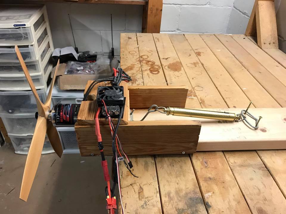

Ok, so I have been working on a power set up for my 160in C130, I have not weighed it yet, but I'm expecting 55-65 pounds.
First I know having 4 motors making x amount of thrust is more efficient than 1 motor making the same thrust as the 4 different motors have more disk area to grab, and they blow over more wing area.
I'm going with a scale size 16.5 x 12 pitch blades x 4 like scale. I know in full scale they are able to turn there pitch way up as they are not spinning massive rpms.
So using a SK 6374 192kv motor (huge) on 8s 5000 40c lipos, I was getting around 13.5 pounds of thrust on my make shift pulling testing rig. I measured the rpm at 5100-5200 rpm pulling a massive lol 45 amps at WOT and 20 amps at 1/2 stick.
At this rpm I was at 58-60mph prop speed, and a C130 is not the most aerodynamic(and I don't have retracts so wheels are always down-not far on a C130)
Full scale flying speed is 368 MPH and at 133 feet ws x 12in = 1596 round up to 1600 for easy math and my 160in C130 is 10th scale. So .10 of 368mph is 37MPH
There is no way this big plane is going to fly max speed of 37mph and still stay in the air! or I'm
My current prop speed on 8s is 59 mph, my boy suggested I move up to 9s vs 8s, but this will roughly give me 625 more rpm with a prop speed of 66mph vs current 58-60mph prop speed.
The extra thrust will not be a factor as I think I'm way over thrust as it is, currently with my 13.5 pounds x 4 = 54 pounds of thrust for a 55-65 pound C130 with a huge wing, Ill have more than enghof thrust as is, the extra lipo cell if all fallows the same lines will move me up to 15 pounds of thrust per motor with a total of 60 pounds, I'm not trying to hover here LOL
What would you guys do?

Its a 16X12 4 blade prop, at current 8s its Pitch Speed is 59.5mph - 54 pounds of thrust, I have decide to go with the 9s set up, for 60 pounds of thrust and around 64.5 Pitch Speed, this will really help with my jato rocket take off in a 55-65 pound plane. Im still concerned about the low 64.5 pitch speed, I don't want to be flying full power just to keep her in the air.

Getting back to Mike's C130....
Mike, you need two things to get up to speed and climb.
You need enough RPM and pitch to reach speeds the model will fly at comfortably. And you are right that on a large and fairly draggy model like a C130 that the model will not reach the actual pitch x RPM airspeed other than in a dive of some sort. So finding the speeds you expect to need to fly at for stall, cruise and max speed then proping and powering for a pitch x RPM that is about 20% higher at full throttle than your desired maximum level speed is good.
Your thrust rig being used to test for static thrust is misleading you. A 12 inch pitch prop is operating at a stalled condition when running static. And that means it sucks current like crazy. Far more than it will in the air at a reasonable speed. So during the takeoff run it will reach a speed where it stops being stalled. When that occurs the RPM will pick up and the current will actually drop. So for flying and climbing at a reasonable cruise speed in the climb you can expect more from each motor and prop than your testing indicates.
To lift off and actually climb you are way over powered for a scale like lift off and climb angle. You could achieve a scale lift off and climb angle with more like a thrust value that is down around 60% of the model weight. And even that would likely still be a higher thrust to weight ratio than the full size Herc when loaded. So even with your "lower power" setup you'll likely find yourself only using part throttle for a nice scale like takeoff. Full power takeoffs even with your lower cell count packs will resemble a hot fighter sort of takeoff. Or the takeoff of the real thing when unloaded and doing one of their impressive air show short liftoffs.
The only question now is if the 12 inch pitch and RPM that your pack voltage turns it at is a good match up for pitch speed to the speed the model will need. You want the prop to un-stall at a speed low enough that it will occur during the take off acceleration. But not TOO early or you might run out of top end pitch speed. I'm not familiar with the electric propulsion software out there. But one or more of these analysis and prediction packages might be able to tell you that sort of information. I do believe that most of them also will give you a good estimation on the stall speed. And given the cost and time in a project of this sort it might be worth looking into buying Motocalc or similar.

To me, the prop seems to be a good choice. It's even "scale" in diameter and the pitch/diameter ratio makes it efficient. The motor is just a too low Kv type that would deliver far too much power at a cell count needed to reach 65 mph flight speed (80 mph pitch speed). Motocalc is not needed to see that. I'd rather choose a 380 Kv motor and 5 or 6 cells. Power/weight ratio could be as low as 0.45 and would still give take-offs like an unloaded original.
