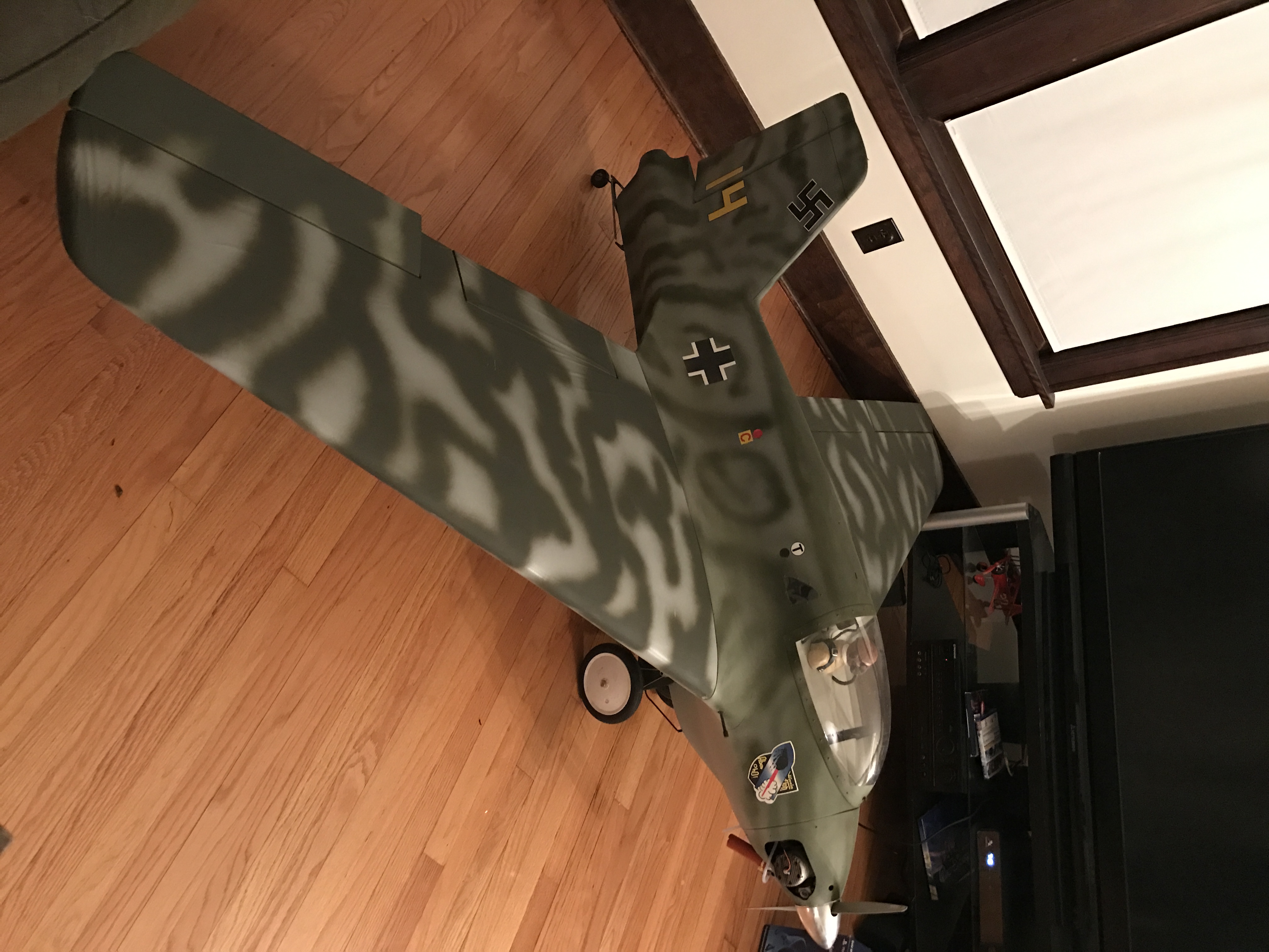

Ok so I picked up old Joe 105in ME 163 It has 2 controls per wing, and the owner said the inboard ali were used as flaps during landing.
This seems conflicting, can a tail less plane use flaps? or Would it actuly be more of a crow, as the inside ali/elv would be going down and the out board ali would be going up as in typical delta wing flight?
As all my delta wings need relex, or up ali/elv to fly level.

Ok, SO Should I just link them to the match the outside control surface for elevator movement only? That way the out side panels are programed as elevons, and the inside ones would just have a mix that would follow the elevator movement.
Im going to fiberglass the wing next week, so im making corrections now. I was thinking of adding the lower flaps but it looks like the servos are in the way. I also thought about adding the front leading edge slats, but I had a buddy at the museum that sent me some pics of the real one and the leading edge looks like it would be real weak as this is a foam wing.
