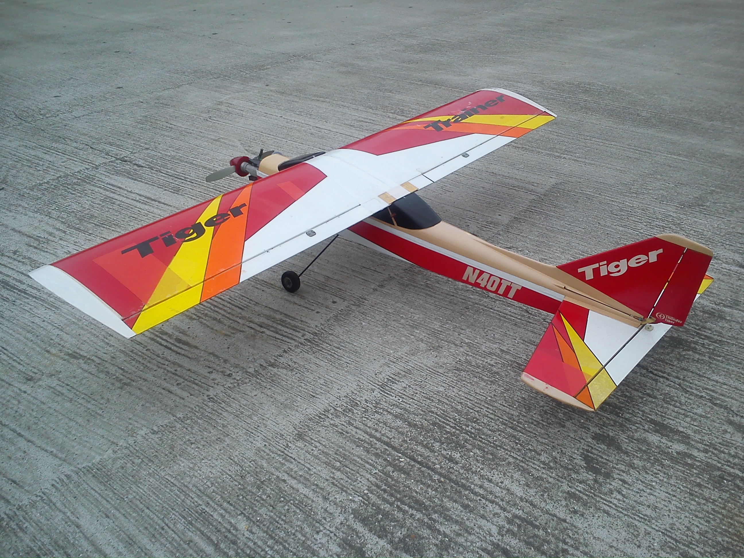

I have a tiger trainer for long .it flies well.But I feel it is some kind of sluggish.I was wondering If I remove dihedral from the wing(straighten it).will it become more agile?

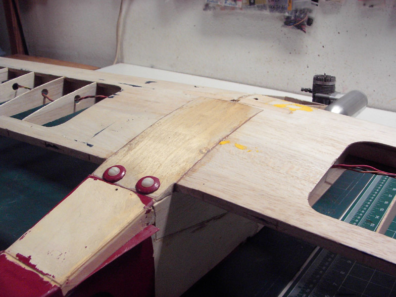

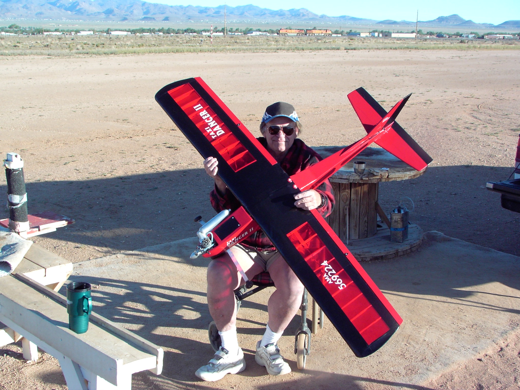

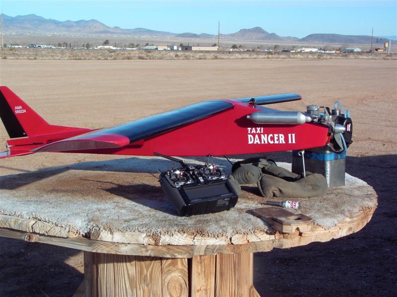

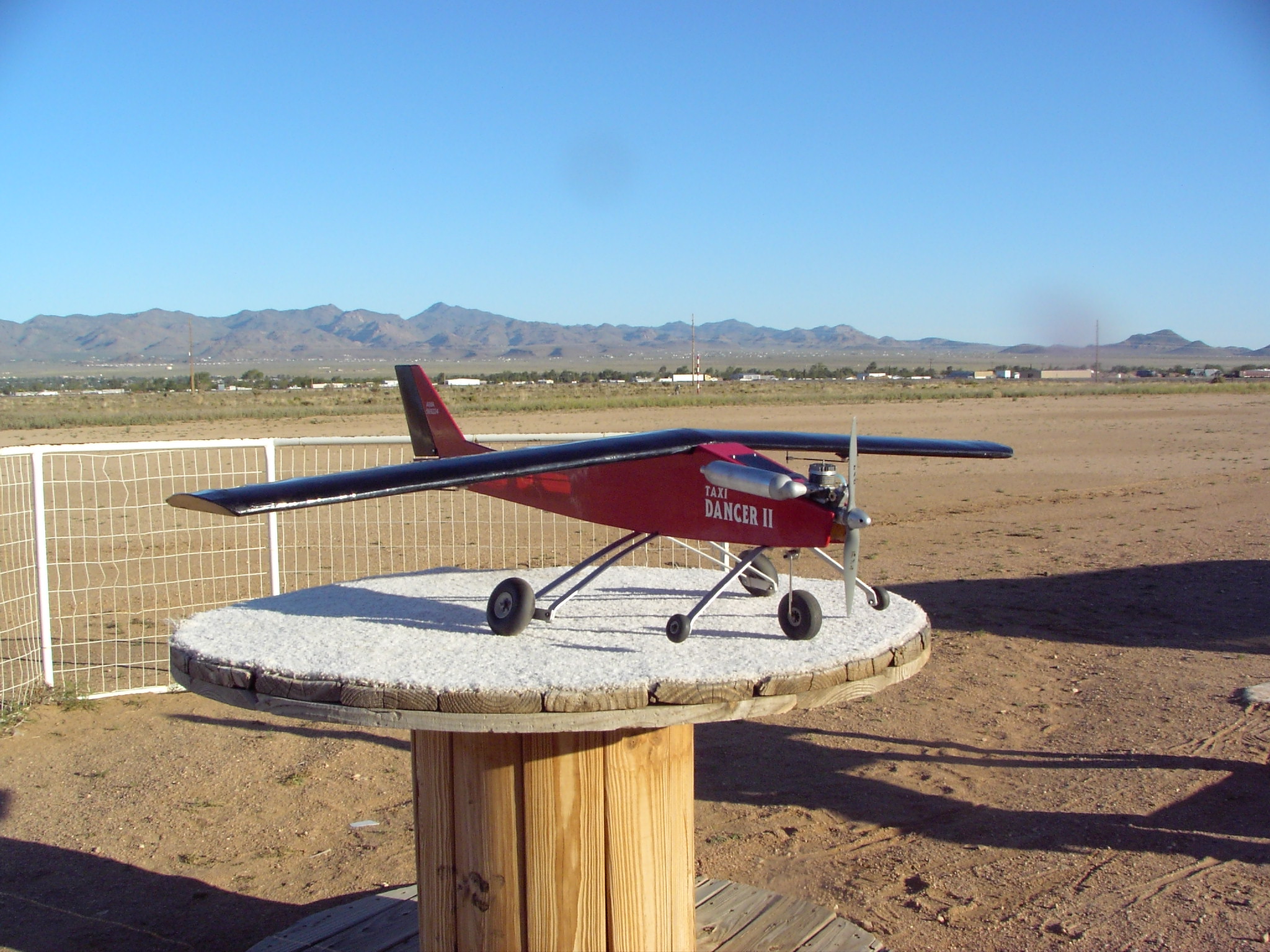

Yes! but don,t stop there and go to a full anhedral drop the wings about the same amount as it formeraly used in dihedral. That will result in a very neutral roll stability and that fabled "stays where you put it" feel that is sought after by so many.
This is only for high wing cabin types and it fungreat fun. Yes I have done this on four generic trainers over the years. The problem with it is people keep talking me out of them.
John
The reason for the curious gear in the second photo is I also used the same airplane at times in in our wingless trainer races.

Just to add to John Buckner, above, a high wing plane without dihedral will fly like it has some, i.e., give it rudder and it will bank as well as yaw. That's because in a skid, pressure increases under the wing at the fuse junction and tends to lift. In a slip, it is the opposite...pressure increases next to the fuse under the inboard wing.
Most high wing planes also have some dihedral, which makes them pretty stable, meaning they resist rolling a little and if rolled, they tend to self-correct. So if you take away the self-correcting tendency, they will roll faster.
So John's unusual airplanes above counter this tendency with anhedral. Good idea! Looks kind of weird, but I can see the sound thinking behind it.
With low wing planes it is the opposite. Some people take all the dihedral out low wing planes, but if you do that you have an airplane that prefers to be upside down! That's why designers always use some dihedral on low wing airplanes. The purpose is to achieve something like neutral stability. Neutral stability in this case meaning that a rudder input does not cause roll either way.
Note that a high wing with anhedral and a low wing with dihedral are sort of mirror images of each other. Both of them, if the angles are right, can be neutrally stable.

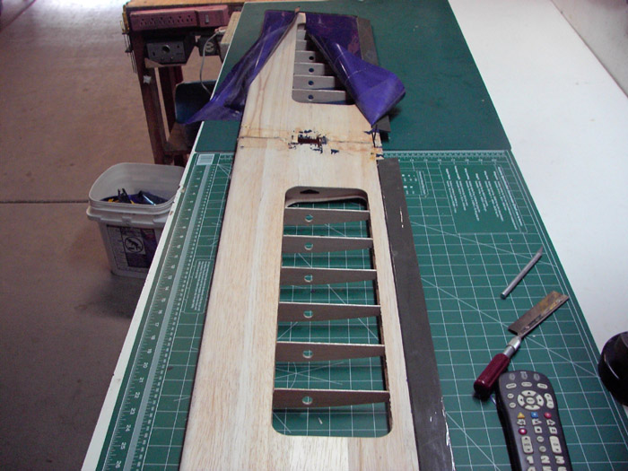

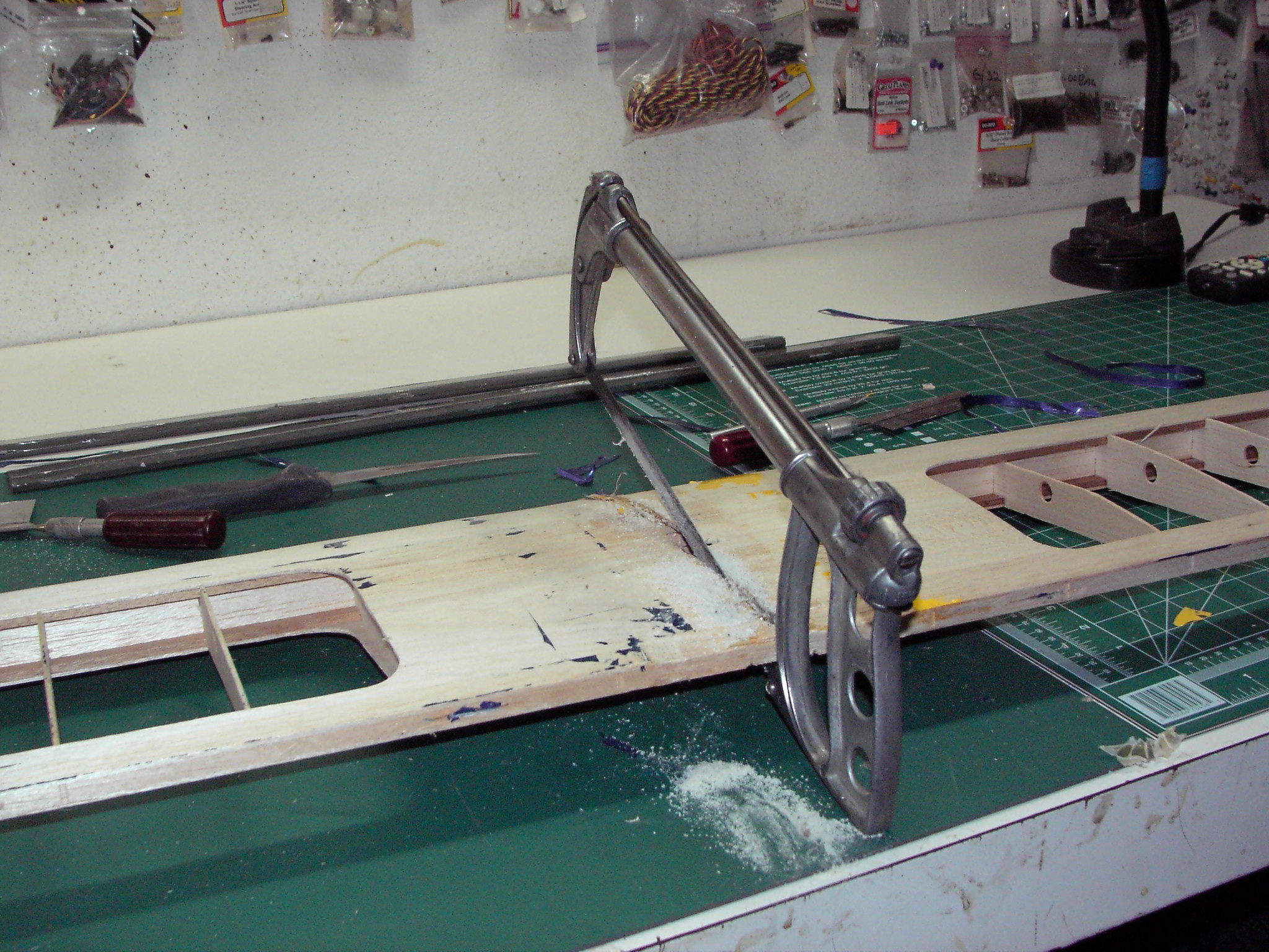

Foodstick on the four I have done over the years, the first back in the sixties I just used generic trainer wings and what ever degree of washout that may have existed. They all became very aerobatically inclined trainers however that were a joy to fly. Never have understood the resistance to this simple kit bash. There is however one draw back and that is it is more difficult to maintain orientation at first until one becomes more used to the unusual visual configuration so suggest keeping close on first flight even though it is a trainer.
And indeed what is pointed out above by buzzard bait, this is not for a mid or a low wing airplane. If this is done to a low wing the stability will diverge away from that neutral ideal.
A low wing always needs a small amount of dihedral or dihedral effect from airfoil taper and wing tip design. A mid wing needs no anhedral or dihedral, a midwing airplane is the only configuration that is already near that totally neutral ideal. Perhaps maybe that's that's why all the many great flying sport aerobats are midwings

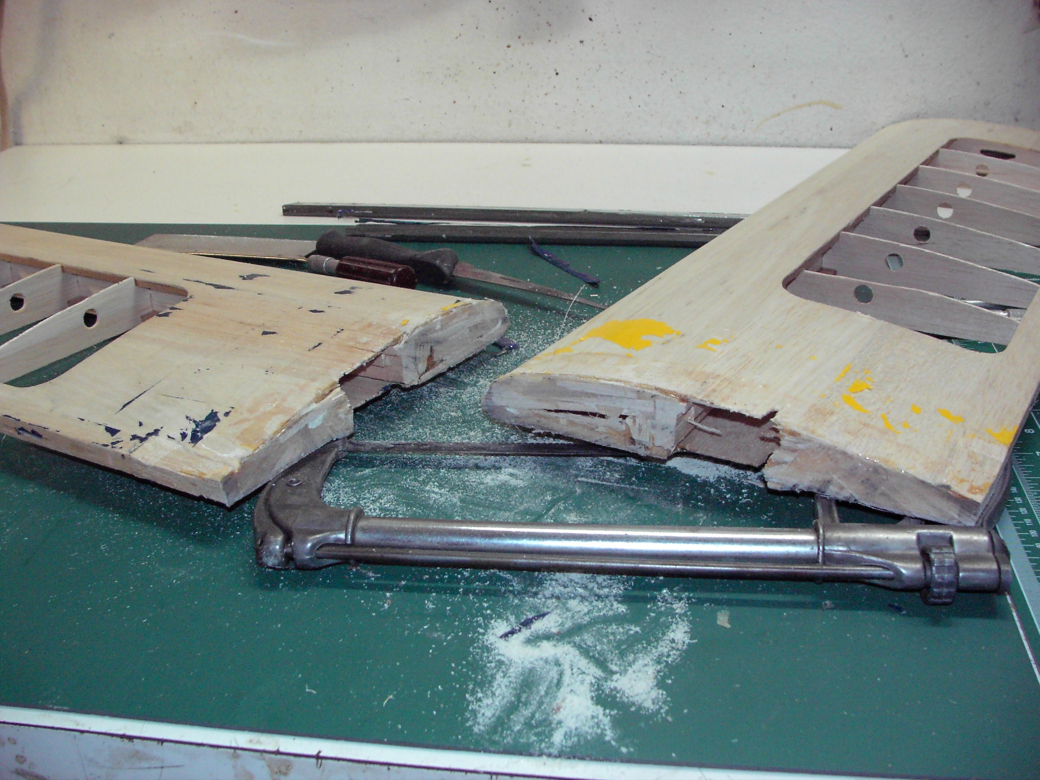

Here are some random photos during the bash of this last one with the hacksaw (the trainer is a Midwest Aerostar trainer mostly stock except the wing.

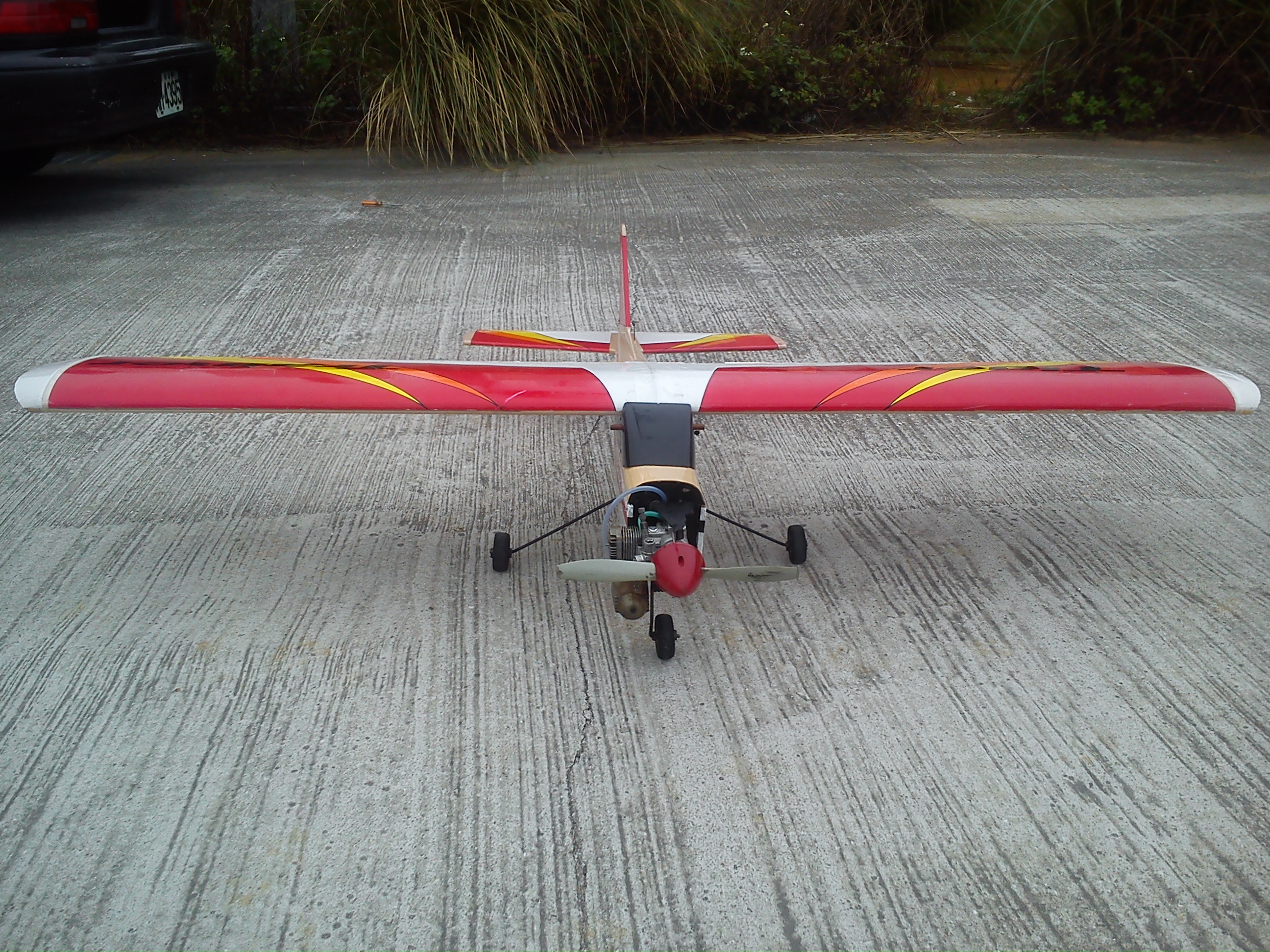

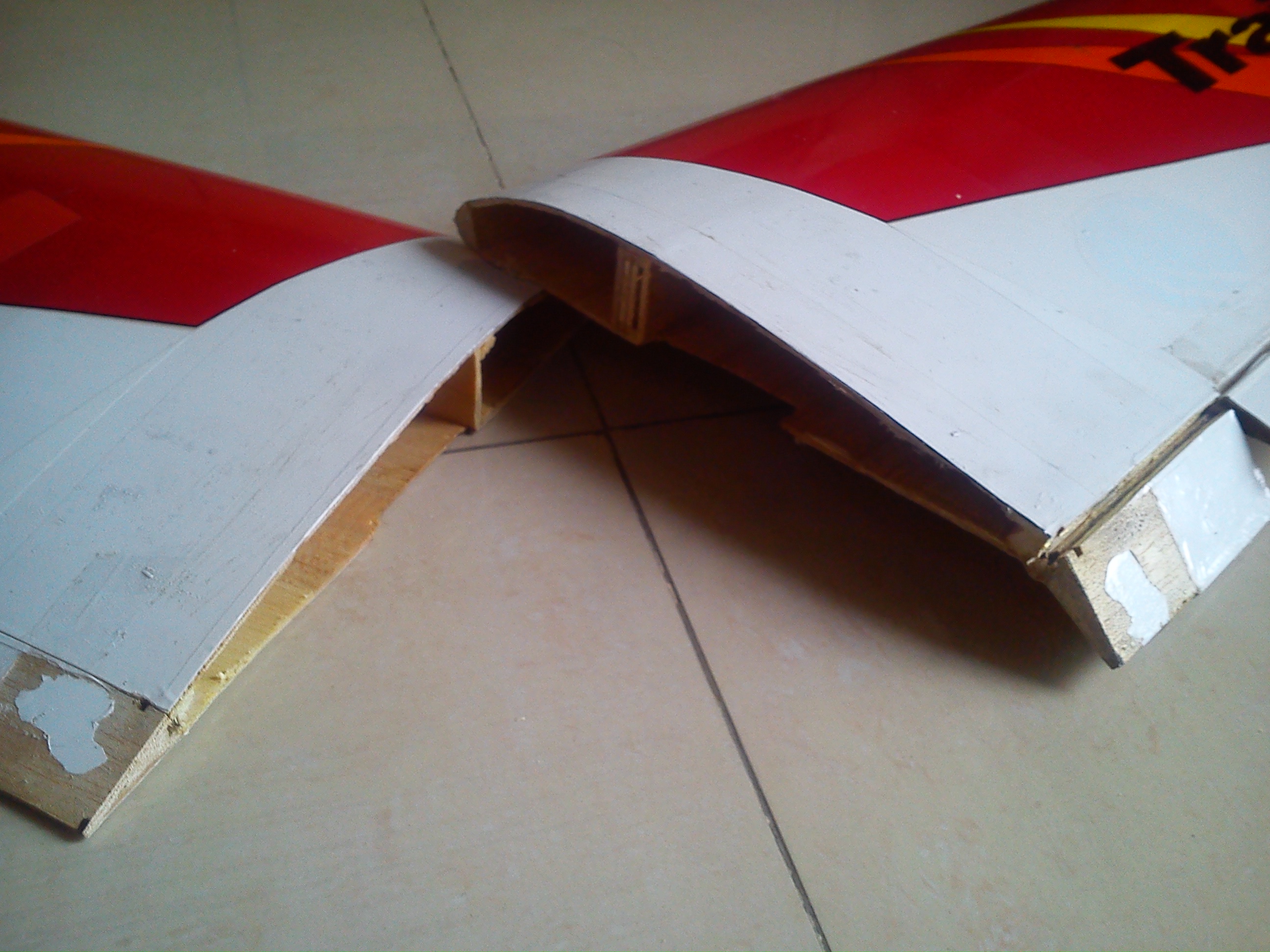

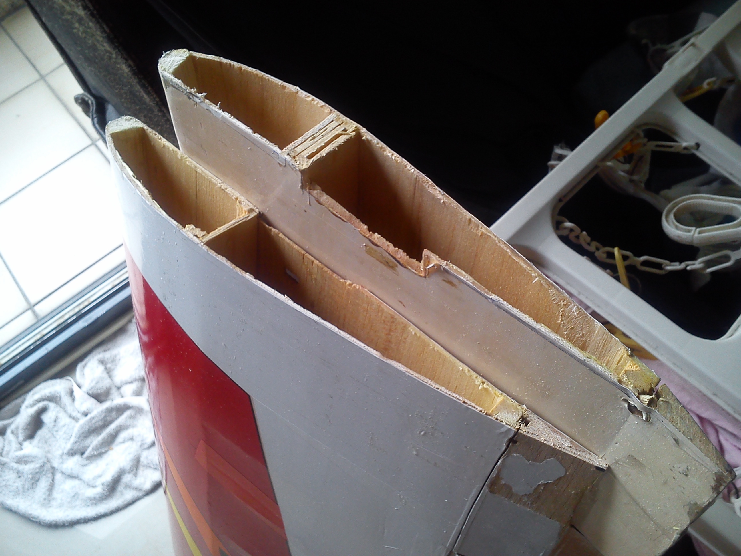

Old 02-10-2017 | 05:07 AM
Joined: Sep 2007
Posts: 91
From: Lin-Kou, TAIWAN
I made it.Now it is a real tiger.

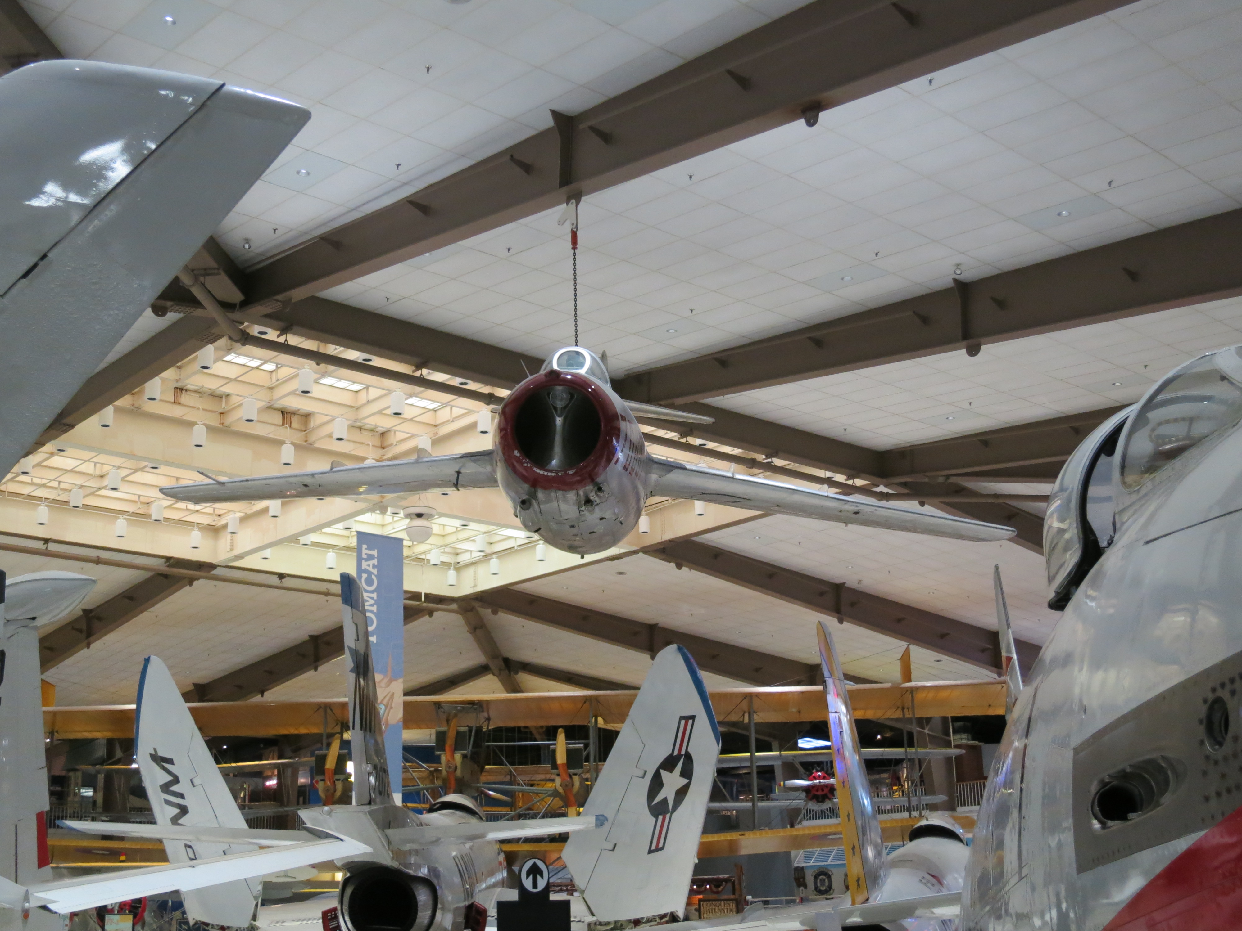

Old 10-07-2017 | 12:57 AM
Hydro Junkie's Avatar
Joined: Nov 2004
Posts: 10,629
Received 139 Likes on 132 Posts
From: Marysville, WA

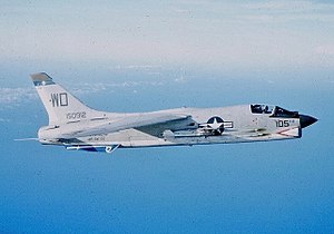

If you want to see the effect of a high wing with anhedral, just look at the A-7 Corsair and it's big brother, the F-8 Crusader.

Old 10-08-2017 | 03:02 PM
Posts: 3,286
Received 5 Likes on 5 Posts
From: Ithaca, NY
The Mig 15 had anhedral too...
