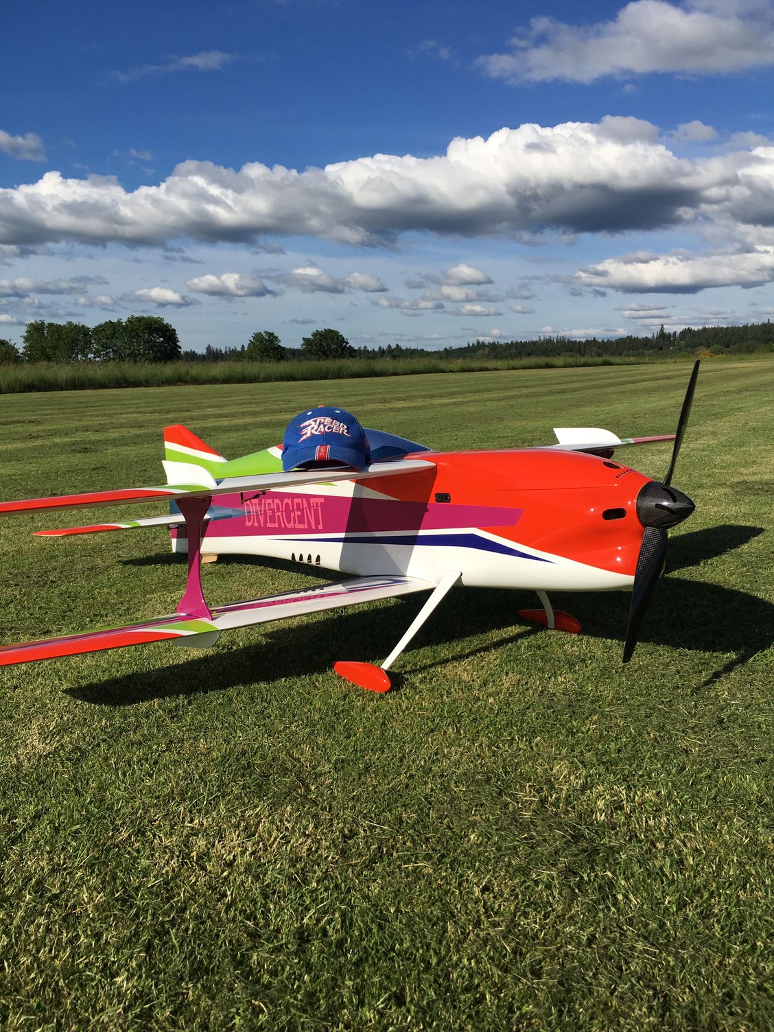

Very few models can flat turn with zero aileron input, this one can as well as doing knife edge loops, vertical eights and knife edge Cuban eights rather easily.
