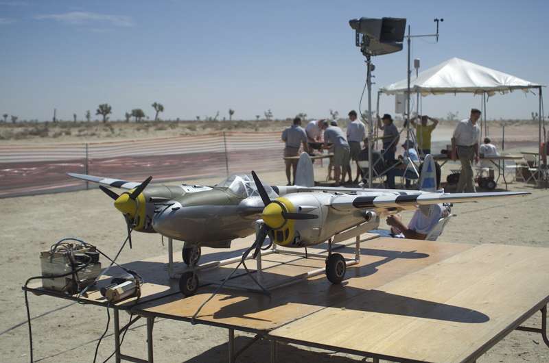

The first P-38, about 70 inch span, crashed in level flight after a 180 turn from takeoff. Probably poorly constructed.
The next 2 were large Ziroli's. The first of these died when throttle control was lost on one engine, which couldn't be turned off.
When the other engine quit, it rolled over and died.
The 2nd died due to one engine failure.. same thing.
Outthrust on a larger airplane is certainly something to consider, but if you're into scale, only the Ju-52 and Sunderland used it!
P-38s, Mosquitos, Comets... all poor choices for models which are not electric.
Speed must be kept up to maintain directional control.
Some means of engine cutoff isn't a bad idea. This could have saved the Zirolis, had a seperate remote kill-switch been available to the experienced pilots stuck with flying those.

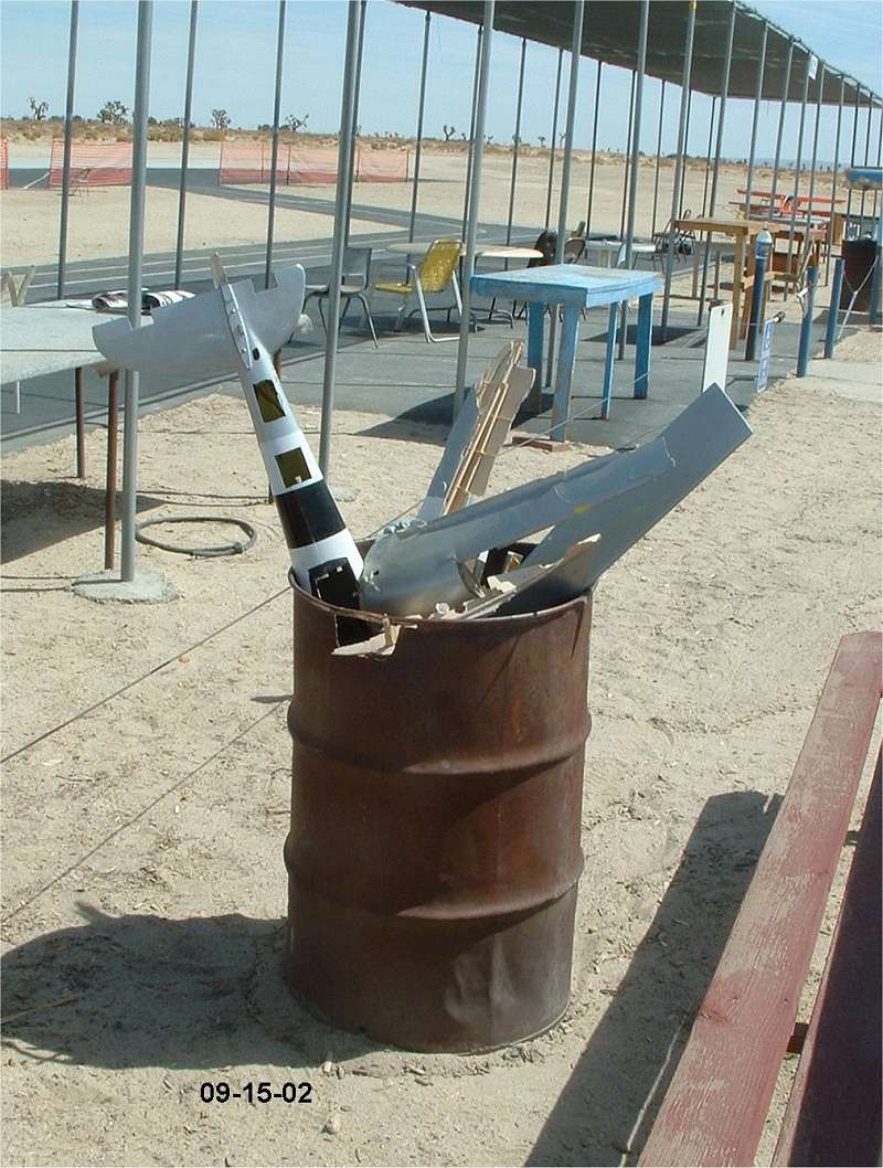

Before and after..
Before and after..

Oh damn, that looks like a nice model. It hurts to see it in the trash and its not even mine. I guess thats true about the scale factor. I dont build for scale looks so I do what would make the airplane fly acceptable without sacrificing too much. Shame you couldnt get engines to spin backwards like the cox ones. That would take care of the torque that creates the rolling motion when one engine goes out.
