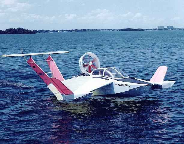

Posts: 1,946
From: Summerfield,
NC
THEY SNICKERED AT THE WRIGHT BROTHER,IN THEORY, THE BUMBLE BEE CANT FLY, HELICOPTERS WILL NEVER WORK (IGOR S.) WAS OUT OF HIS MIND, AND THE THOUGHT OF A FORWARD SWEPT WING FIGHTER WILL NEVER WORK (X-29). I SAY HOG WASH. GO WHIT YOUR DESIGN. I'M NO ENGINEER OR AERODYNAMICIST, BUT I THINK YOU HAVE A WINNER. IS IT POSSIBLE TO BRING THE BOOMS IN ENOUGH TO MATE THE HORIZONTALS, OR IS THAT TO MUCH P-38ISH IF YOU KNOW WHAT I MEAN?
Posts: 958
From: Punta Gorda, FL
The Wright brothers invented the windtunnel to collect the engineering data that would allow them to design their first airplane rationally on the basis of physical principal rather than as an exercise in "novelty." Novelty in and of itself isn't necessarily rational. The bumblebee's wings operate in a different flight mode (clap-twist-snap) than an airplane's wings and applying airplane wing theory to a bumble bee is just a misapplication of that theory. To imply that a misapplication of a theory invalidates that theory is not an example of rational thought. The X-29 only became practical with the development of fly-by-wire dynamic stability and control systems (another engineering triumph of rational thought).
Posts: 91
From: Champaign,
IL
Well said, Ollie...
This isn't snickering that's going on here, just rational criticism of a design concept that may or may not be sound. In modeling, design for novelty's sake is an acceptable motive - just realize that the airplane emphasizing novelty may suffer in mission capability. However, the mission may be novelty! Remember, there's nothing quite like showing up at the field with something *really* wierd and fun.
FSW is probably no problem for this plane - the modest amount of sweep extant in your drawings is not going to cause structural or stability problems. A bit of anhedral won't be too bad, either, as long as the wing is above the fuselage, and you're willing to stay on the ailerons allthe time. The one concern I have is the boom structures and the possible aeroelasticity that they may cause. If you use the surfaces on the horizontal stabs as elevons, you run the risk of experiencing aileron reversal, and elevator response may be more than you expect. If we think about what's going on on the wing-boom ineteraction, this may be clearer. for the wing that you want to go down, you'd deflect the elevon up. However, this long moment arm about the attachement point (wing) may cause the wing to flex tosionally - to a higher angle of attack! (uh-oh) Now it wants to go up. Which influence wins out will depend on the torsional rigidity of your wings and the speed at which the aircraft is flying. As I inderstand it, the 777 actually experiences aileron reversal inside its normal flight envelope (at high speeds, of course), and the flight control system knows how to compensate. Unfortunately, the only flight control system we have on models is the guy behind the sticks, and we're notoriously bad at dealing with aileron reversals.
To prevent this, you're going to need to make sure that the wing is very torsionally stiff. This probably means fully sheeted, as wings get much more rigid in this axis when you "close the section" with sheeting. Also, the tailbooms need to be quite stiff to avoid elevator reversal from a similar phenomenon., but this time the stiffness needs to be be in bending.
Good luck with it, and keep dreamin'. Just remember that there is a good reason that most airplanes have a wing up front, a tail in back, and a tube in between.

Going by what was said about control surfaces, i rember the British Vucan bomber had 4 surfaces, the outer two where mostly aileron, the inner two where mainly elevator, tho each had some or the other mixed in.
im a firm beliver on deltas and swept wings the elevator should be in the middle and at the rear, and ailerons at the tips and forwards, that way you avoid tip spins form uneven elevator movement and flap effects.
Thats why my own delta design had a swept forward TE. it either worked as i just explained, or it was the best set up delta i've ever flown.
in my mind, the surfaces on the wing in the center can only really be used as flaps, with maybe some aileron mixed in. the rear tail planes are elevator, again, maybe some aileron mixed in, and the outer wing pannels are aileron only.
reading back thats what you intend to do.
i like the rudder idea.
to help with strength and bending loads, you could have one full length tailplane maybe, but at the spans shown in your design that wouldnt be pleasing to the eye, which your whole idea so far is to me.
As for needing computers to fly jets, thats only coz the CofG is so far back the plane isnt stable + all the other bits they do. any model designed in our normal limits of weight and balance centers has potential to fly. i have a Spinsation and its very stable in flight.
Swept forward deltas are also self stablising in ground effect.

oh yer, i just remembered. you might have trouble taking off, the front wings will be in ground effect and sucked down, the rear wants to fly in ground effect, i can see a point as it just manages to get free from being sucked down the front section suddeny gets lift and it flips over. my susgestion is to have the gear longish ( wings out of ground effect), and a nose high sit. my Spinsation is too flat and it jumps into the air. i have to let the sticks go, wait for it to level on the rotation, climb a little on its own, then pull up.
DAMN! now i've got that WIG craft in my head again
i want one of these
