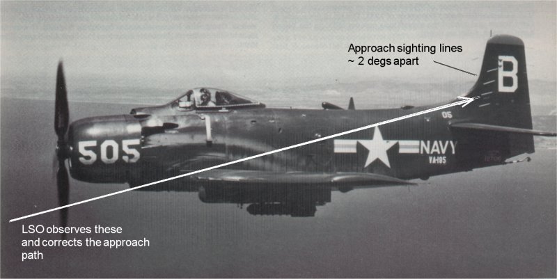

Tall Paul,
As LSO's get more experienced, they tend to look much more at the "big picture" to determine aircraft AOA rather than the indicator lights (green=slow, amber="on-speed", red=fast). By looking at certain features on the airplane (for a Hornet: top of the canopy lined up with the top of the right vertical fin, for a Tomcat: nosewheel centered on the lower edge of the right intake), they can get a good idea if the airplane is fast or slow. A good "eyeball calibration" is much more reliable than the AOA system on the aircraft (especially for an airplane that had been "jousting" with a refueling basket). I had never seen the stripe technique before. Very interesting, but it probably wouldn't work so well with today's approach speeds. At night, every airplane has a unique lighting pattern that changes with attitude. The one time that the lighting system has an advantage is "in close" at night, where the LSO's perspective changes pretty rapidly.
The LSO's eyeball is obviously giving him pitch attitude and not AOA. The reason why it works is that airplanes fly a fixed geometric glideslope to the carrier (usually 3.5, 3.75, or 4.0 degrees). The higher glideslopes are normally used with higher wind over the deck, with the result that a given airframe usually has about the same rate of descent for every landing. As long as the rate of descent stays the same, a given pitch attitude always corresponds to the same AOA.

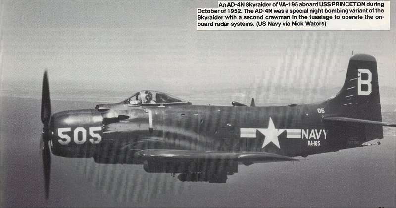

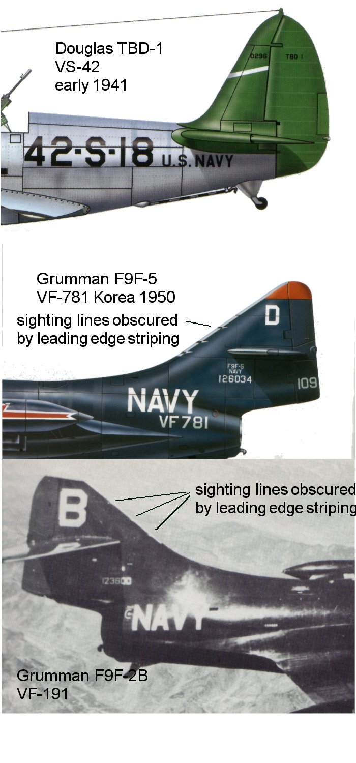

Shoe, there's quite a difference between a prop plane trapping and a jet. The sighting lines apparently were used early on with jets, but soon vanished.
And they were used sporadically on the prop planes, mostly early in WWII, and seldom seen in the latter parts, revived again after, to vanish once again.
Nowadays the plane has an alpha indicator in the pilot's field of view as well as the glide slope information from the Fresnel lens on the boat. And the LSO yakking at him.
I've seen glide slope indicators at non-military airfields at the approach thresholds, and one of our S-3 test pilots many years ago described what the USMC called the "POMOLA", Poor Man's Optical Landing Aid".... three flourescent ribbons arranged to show the pilot where the proper glide path was.
I simulated these on our analog video flight simulator at Rye Canyon for the S-3, and they worked quite well.
Did the Fresnel lens also, using a motor from a Brush recorder to move the "meatball" relative to the alignment lights as if it was responding to the plane's off-optimum position on the glide slope. Built up a scale model carrier mounted on a hinge which allowed the model to pitch like a real carrier.

Tall Paul,
Do you have the original photo without the annotations? I know some former LSO's from VA-195 (now VFA-195) who might be interested in the photo (I doubt they would be able to guess what the hash marks were used for).
