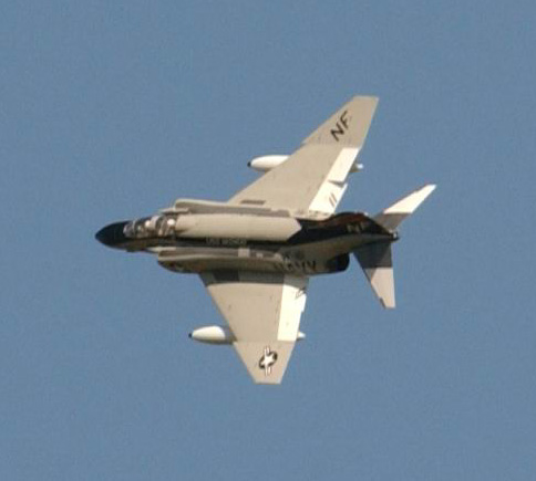

I used to work on F-4s and one interesting feature was the inverted airfoil on the horizontal stab. Also the stab leading edge had built-in slats. I am curious why the design took such drastic considerations. Would a symetrical airfoil for the stab develop too much drag while creating negative lift compared to the current design?

Well, I don't know the exact answer to the question but I think I can make some progress. The first consideration is that most full scale airplanes are built with tail down force into the structure. With the center of lift behind the center of gravity the tail down force equalizes the torque of the center of lift, putting the center of lift on the center of gravity can cause some unwanted flying stability characteristics.
As for the inverted airfoil, a fully symetrical airfoil cannot generate lift at zero AOA, if the the AOA of the stabilator in level flight is zero then you would decrease drag. With a "negative" airfoil, the longer route for the air to travel across the curved bottom of the stabilator creates a high pressure area on the bottom of the surface and creates the needed tail-down force. A non-symetrical airfoil can create lift at zero AOA, therefore decreasing drag compared to a full symetircal. There is still drag induced by the surface creating lift but it is not as great as an AOA other than zero.
As for the LE slats, they're there to keep the stabilator from stalling during maneuvers, a pretty self explanitory theory.

Inverted airfoiled horizontals are common. L-1011... C-130.. used to get the download without having the larger structure a conventional symmetrical shape would require, as well as the trim drag benefits from not having to trim far from neutral.

Thanks Paul, thats what I was thinking. Would the slats create multiple shock waves during supersonic flight? Seems to me not being a supercritical airfoil design would do that but I guess with enough thrust you can overcome anything.

I flew the C's, D's & E's in the Air Force. The C & D model had the non-slotted stabs. On take off the normal procedure was to hold full back stick and go full burner. When the plane rotated, you eased off the back stick after lift off when you reached the climb attitude. On landing you usually hit full back stick just at touchdown. For in-flight maneuvering there was plenty of elevator authority, but on and near the ground, you were limited.
The Air Force E model had the slotted stab with more downward lift. You could make a normal burner take off and pull back stick at take off speed. You could also land the plane normally with a flare.

Kelly you are double dipping. The aerodynamic center or neutral point of a conventional symmetrical airfoil planform is aft of the CG, however it includes the lift of the wing already. Make a drawing of wing lift and tail lift about the CG. The lift of the wing is forward of the CG and to balance it the lift of the tail must be up. You have used the tail lift twice. You can say either "center of lift" or "wing and tail lift" but not "center of lift and tail lift".
When you include airfoil camber effects, flap effects and fuselage effects (all which seem to pitch the airplane nose down) then many times the tail loads shift to down. There is where the supercritical inverted airfoil is a valid use to keep the drag to a minimum.
In the case of the F-4 with flaps and slats, etc., there is a big nose down pitch. With the slatted tail it is keeping the horizontal effective enough at the low speeds to keep the nose up. As was noted by Ed (now known as Lucky Ed who I am very jealous of for him getting to fly lots of one of the meanest, good looking, airplanes of all time (while I flew a desk to and from the coffee pot, big thrill!)) during normal maneuvering tail effectiveness should not a problem. You put up with the drag of the horizontal slats at high speeds because you need them more somewhere else.
