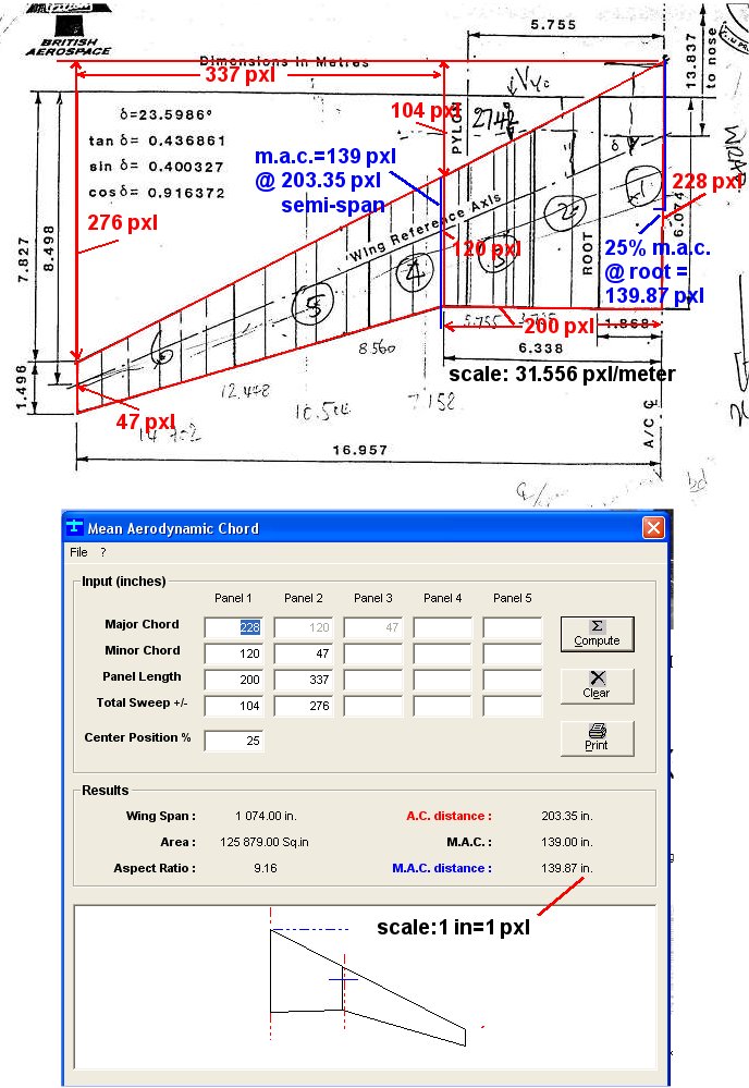

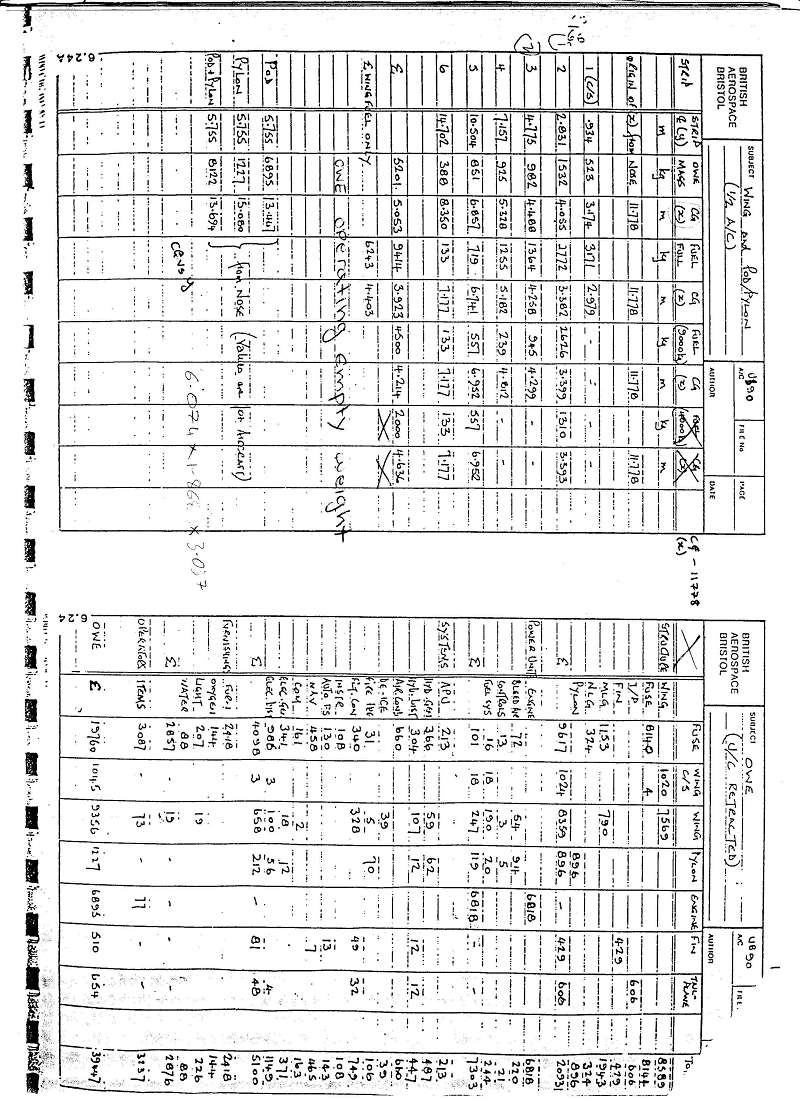

im new to this forum i was looking for a forum where someone might be able to help me with some work please.
i got some work to find CG(x) of a wing. Ive attached a image of the
info given what i wan to work out is on the second link the CG(X) of the wing. If u can help i would be very grateful. ive been trying to figure it out for ages.[sm=drowning.gif]

For a multi-panelled wing, use this method>
http://perso.wanadoo.fr/scherrer/mat...glish/mce.html

i need to find the CG of each section i dont know how to do it i cant seem to get the numbers for CG in the first table on the second image.

The basic method for a multi-panelled wing is illustrated at:
http://home.earthlink.net/~pjburke1/cg.htm
But the previously linked site is the best source.

Using the process at the Etienble site, it looks like this..
There's no real need to get any more complex, for a model.

Sorry guys, I just looked up the website Tall Paul quoted and realised that the question is nothing to do with CG at all. What Naz wants is to calculate the wing's Aerodynamic Centre. Nothing to do with weights or mass or gravity. Right.
I downloaded the program from the website and tried it. It didn't work at first when I left the "centre position %" box blank. I thought that was something it calculated. Eventually I realised that it wanted me to put in 25%, the usual position of the AC on the MAC. Now I get it.
