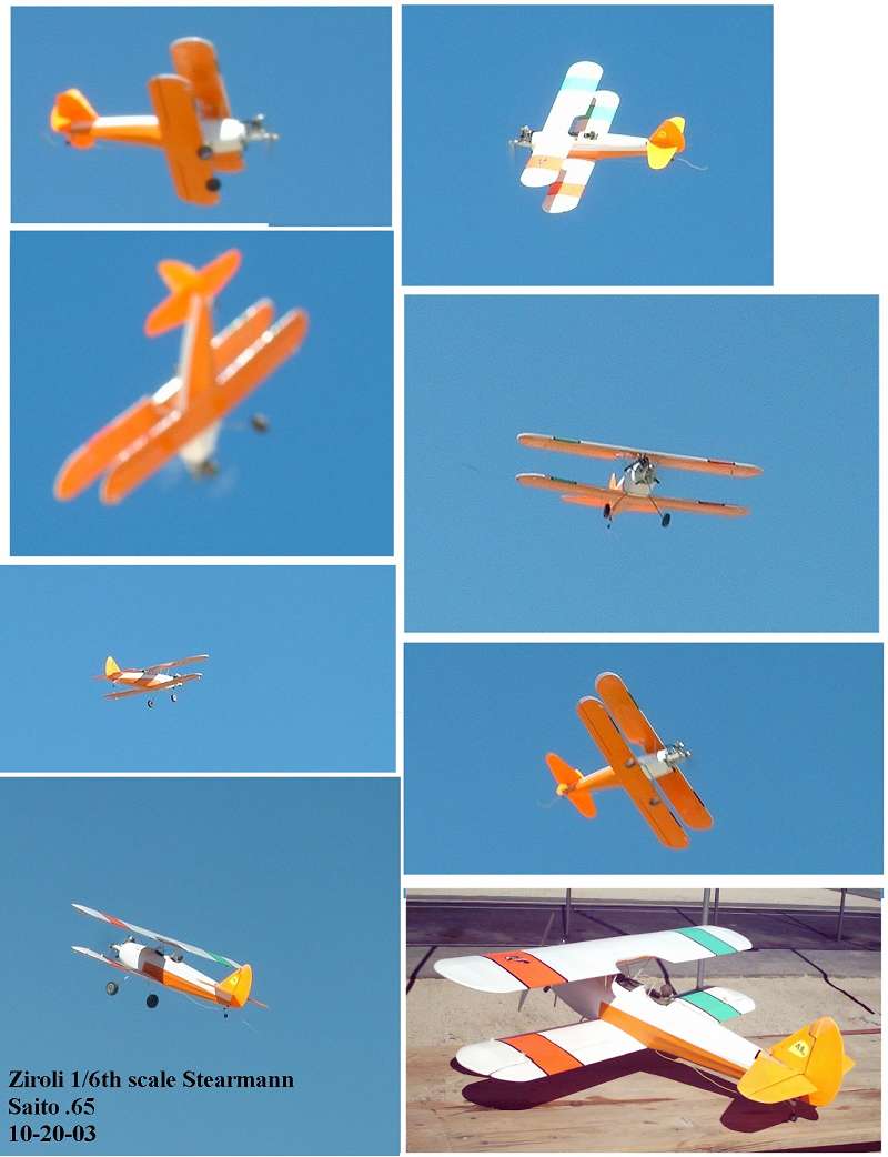

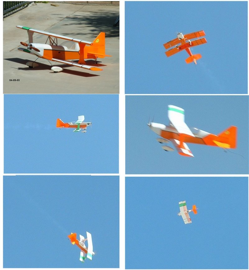

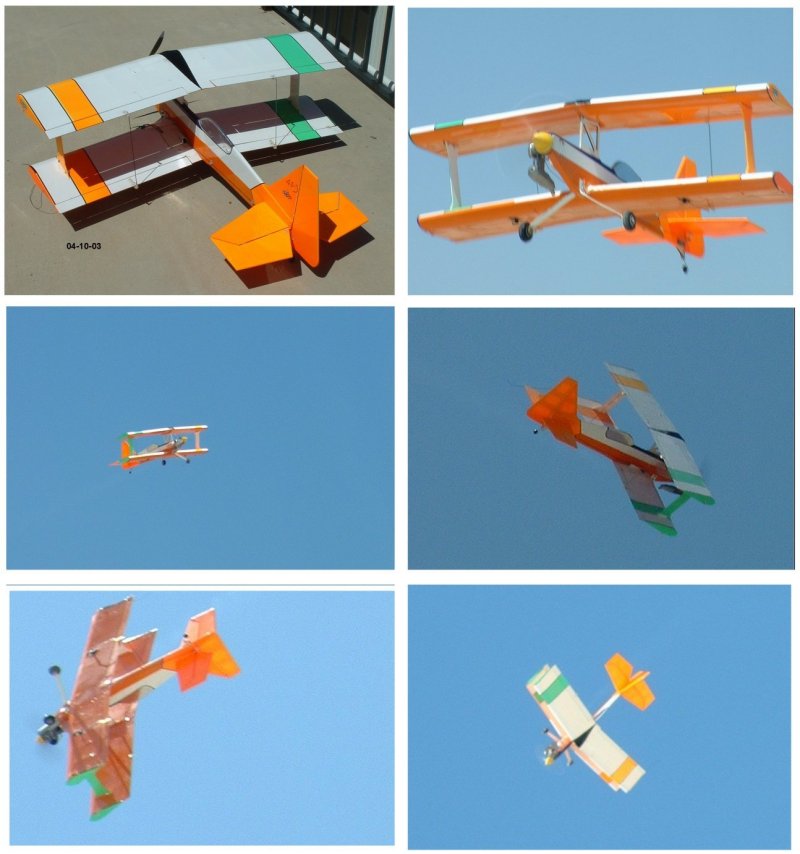

A scale Ultimate, which I fly, has the same brick tendency as the SIG Ultimate, which I also fly, with power off.
Both are a blast to fly with power on although the thin scale wings can't do much to overcome all that drag!
And the SIG has more drag than any two airplanes should!
The Stearmann... fine under power, must be on final when the engine quits...
Lightness AND experience make these things flyable.

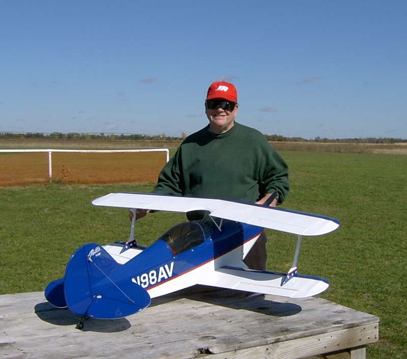

tonyc- You would probably agree that the Cermark is a easy flying airplane; take-offs and three-point landings at walking speed are easy, and they don't take a grey-beard on the sticks. TallPaul, I am sure there are lots of bipes(vast majority?) that are treacherous buggers, and my experience is probably less than yours, but all I can speak to is my own limited experience. I heard a lot of "How hard is it to fly?" from a lot of fellow flyers with a couple of years on the sticks; I let several try the sticks, and without exception they all remarked how gently it flew compared to my club's unofficial "mandatory" models, the Sig Somethin' Extra and the GP Dazzler. If anyone cares, I can furnish more info on the Cermark setup-incidence, design changes, etc...JIM
A couple years ago I lifted one of Mike Cross's Goldberg Utimates.... it didn't weigh anything! Probably the lightest plane for its size and type I've ever seen.
I asked him how he did it... "Don't add anything!" he said. We tend to "improve" the structure etc when it is already adequate.
This particular plane... on takeoff, just before rotation, he'd cut the power to idle, then rotate and it would go up about 50', then he'd add power and hover.
A .91 motor, if memory serves.
I have a Uravitch (from MAN plans) Fokker D-VII. Made it more scale, yet it's still very light. Dead sticks are of no concern, unlike my Dr-1 (scaled down Ziroli), which is a beast, taking off and landing! Deadstick, fugedaboudit! Lightness makes up for the additional drag on a bipe.
