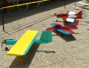

Hi Flyingwings,
I am looking for a plan with the small fuse, and rudder, but no elevator like the second picture from the left. I wanted to build it, but with pre-cut since I have never built one before. Short kit I guess. I have a hawk glider but it is on hold, because I don't know how to but the foam. They said from the plans to use something with heat to cut. Any suggestions?
But the flying wing- can you point me in the right direction?
I have a sig riser 100 sitting around. Can that be modified into a flying wing?
thank you very much.

Thermal runner, I trust you realize you just ressurected a 6 year old thread? The better option for this sort of old thread is to PM the person since they may not even be around any longer or may not be looking for their old threads being brought back to life.
A Sig Riser wing has the wrong sort of airfoil to modify it to be a flying wing without some major changes. The big one is that you would have to add a wide trailing edge extension that is angled upwards to produce enough reflex to make the airfoil self stabilizing. Then you need to locate the CG at around the 15 to 18% position of the new chord width.

Yeah, you are right! I PM'ed him, but nothing, so I guess I will start a new thread.
Thank you for your help.
