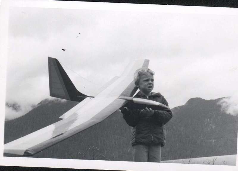

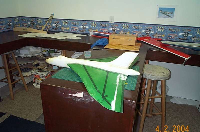

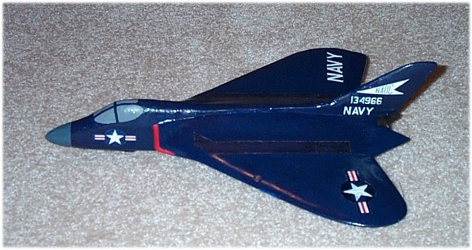

Flying wings can be designed the same way you design an airplane that has a horizontal stab and elevator.
I have taken a standard airplane and chopped off the horizontal stab and elevator, moved the CG forward to 15% of MAC and then had a great flying model. If you want dihedral, put it in. Do whatever you want. Just remember to move the CG forward.
Build a free flight profile model glider of your proposed design. Launch it using a catapult. That model will show you where the CG should be. Attached photo of some cat launched styrofoam free flight glider.
Rudders work fine on a flying wing. The attached model can do knife edge flight the length of our flying field.
If you want a trainer with rudder and elevator, do a flying wing glider as shown in the attached photo.
Build all models in foam.
My background is 30 years of designing building and flying Flying Wings made from Styrofoam.
Attached is my latest project. Vulcan Bomber with a 36" wingspan.

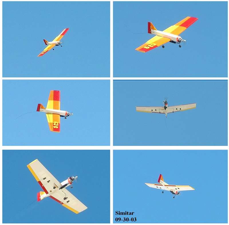

Hi DIGSY
I have built the Slow Motion 40 from plans of Model aviation, a plane from Bill Evans Simitar series.
Check the RC modeler site in plans site for Simitar, Polar Star , Desperado and Desperado Three Thousand.
The Slow Motion is for beginners, I am, you can buy the foam cores in USA and make wings , the fuse is very easy box, have only rudder.
Fly like a trainer with a Tower 40 engine and manage wind very well.
All the Bill Evans say is true gentle stalling only drop a bit the nose, sharp turns , good speed etc, I highly recommend you
Also you can see the faces and comentaries in the flying field.

The Slo Motion is a relatively tame airplane when underpowered. Put on a snortin' 40, like the piped MVVS on this one, split the elevons into ailerons and elevator, and it kicks!
Flown this with a K&B 28.. yawn!.. Johnson 36 R/C.. OK, and the MVVS...Ideal!

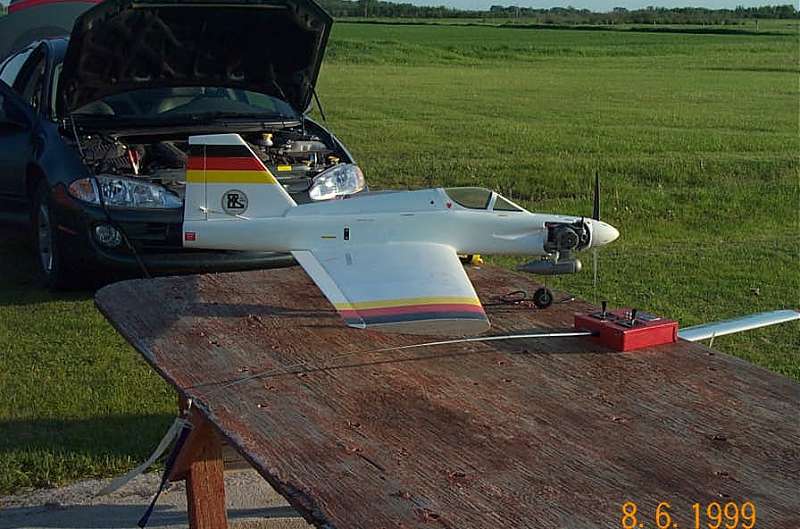

Here is a pic of my scratch built wing it loops very nice and tight but with to much elevator it can still be "snapped" out , it has a very fast roll rate. I have seen the zagi "death spiral" also, thats the reason the verticals are swept back. It should be fairly easy to design one for a ducted fan. go for it and have some fun.

HEY KENNY! That's a great looking plane! How big is it, and what is it powered with?

Its 48" with an OS 15. It was foam and sheeted wing. It has a very thin semi symetrical airfoil. A good 46 and a carbon spar might be lotsa fun

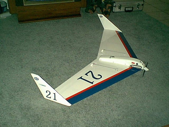

Hi guys I just finished a Komet 163 and am looking for any help in setting it up. ie up reflex in elevons? any an or all help much welcomed thanks C.G. I blew it up from 3 views so I dont have any of this stuff and it is my first delta wing
