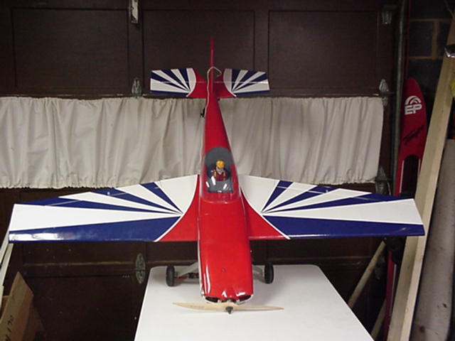

I have only been flying for about a year. I have only had smaller, .40, .46, .61 sized two stroke planes. I just bought the seagull 540 .61 or 1.20 sized arf. I have an O.S. 91 FS on it. I'm turning a 14x4 or 15x4 prop.
My problem is that it loves to roll when I give it lots of up elevator input. I have never flown an aerobatic plane that was this big and I don't know if it's just the way an edge flies. Or it's just the way a big plane flies. I had our best pilot at my club fly it and the first time he gave it a lot of elevator he was really surprised by what it did. He said he thought there was definitely something wrong with it.
I have the servos in the tail and couldn't Y-harness them and then reverse one servo, so that both push rods were the same, so I bought a servo reverser, and it's still the same. I have asked other owners of the same plane, in RCU, if they experience this and no one has any problems.
If I want to pull out of a dive I need about 100 feet to do it. I can't do anything close to the ground cause I need such low elevator input to make sure the plane will not turn over. It always turns over the same direction also. I have made the throw distance of the elevator halves, equal, and the center points of both servos, equal. I don't know what else to do.
Could someone please help me. Lots of thanks in advance.

It sounds as though you have too much elevator throw! I have seen this many times!! The first thing I would do is to lower the amount of elevator throw you have! If this doesn't solve the problem then measure BOTH elevator halves to see if they are traveling the same amount. This is most problematic when you have two elevator servos acting independent of one another. Another thing I would do is to check that your CG is correct. This range should be between 25 - 35 % back of the leading edge of the wing. Since you are new to the model and aerobatic aircraft, I would definately move the CG to the forward area of the CG range. NOW!!! One thing you may want to do, if you have a computer radio is to set in a little more exponential in your aileron and elevator controls. If your ailerons are too sensitive and you move the stick with any sidewards travel while pulling or pushing the elevator stick it will cause the plane to roll!!!
If all of these things are okay, now you should check to see if the horizantal tail is parallel with the wing, and thet the vertical tail is perpindicular to the tail. If anything is out of rig, try to correct it. If all of this is okay, well then we are going to need a lot more room to talk about all of the things it could be!

Another thing to check for is twist in the wings... if there is a little twist it could be trimmed away in level flight and only show up during pulls. If it is not wing twist, or differential elevator, the only thing left is the pilot... Full up elevator SHOULD cause the plane to stall... if you limit elevator travel so that full elevator does not cause a stall you won't have enough throw to do some maneuvers like snap rolls, tumbles, and slow speed manuevers like humpty bumps. To fly an airplane like this you have to learn to limit your thumb travel, not the elevator travel.

I agree with all the above. It's not that unusual for large amounts of elevator
travel to cause an aerobatic airplane to snap. Extreme travel should only be
used at lower speeds. It seems to be worse on planes with a short tail moment.
I would first try moving the CG forward. Exponential also helps.

I agree with the too much elevator throw. I had a H9 Edge that had such a small elevator throw for normal flight, no one believed that it would fly like that. But it was plenty to loop - square corner - snap - spin. Just my 2 cents
It sure sounds like the wing may be warped. But the large elevator throw is what makes the warp show up. The fact that it always rolls the same way indicates that there is a marked difference between the wings. It may be a warp or it may be that a construction error has produces a mismatching airfoil in one wing compared to the other. Check for warps first and shaping differences second.
My Thoughts....
Aerobatic models are by there very nature unstable. If the plane was too stable they would not perform all the aerobatics required during flight. You must learn not to pull too much elevator. As the plane slows the amount of elevator needs to be increased but there is a limit. At a given point the elevator throw will cause the wing to stall. The wing no longer produces lift due to the shape of the wing but instead it keeps the airplane flying by its resistance against the oncoming air. The best think to remember is to keep some speed on the wing until you learn how the plane reacts at slow speeds. Adding expo to the elevator can help this immensly. You need a lot less throw on an aerobatic plane to achieve the same results as say a trainer. What you are seeing is a snap. Most aerobatic planes will do this if too much elevator is applied. As the planes get bigger this phenominon deminished.
One other item you may want to address is your prop size. I would run a little bigger prop on a .91 FS. If it is an .91 Surpass II I would run a 15X6 APC Prop. The 14X4 prop you have on there now is a little too small. I run that same prop on my OS .70 Surpass II. If you have a tach or someone at your club does I would recommend checking it. Look for about 10,000 RPM with a 15X6. Any more RPM and you risk damaging your motor.
You can also check the wing incidence by first checking the root then moving the gauge to the tip and they should be the same. This given the idea that the wing does not have washout built into it.

Well, I think I found it. One of the elevator halves seems to be warped. I called Horizon and they said I just had too much throw on my elevator input and said the warp wouldn't change much, they said they won't fix it, so I guess I have to fix it myself or fly it the way it is. I'm not much of a builder so I'm not sure what I'll do. Thanks again for everybody's input.

Down, there is something that might be rather easy to do to fix it! If you have a heating iron for iron on covering, you may be able to shrink the covering to correct any warping! Just find the area that is warped, and heat the opposite side, in this case top or bottom, to get the warping out. Now if the warp is more than heating the covering may fix, then you will have to resort to something a little more drastic. This fix, remove all of the covering from the tail area involved and slowly apply warm water to the warped area until it is soaked through. You want to make the area "bendable." then using 2 straight and flat surfaces and clamp them to the wet part making sure that you are seating them EXACTLY STRAIGHT, FLAT, AND INLINE with where the part needs to be. This envolves a lot of measuring before you start! Now leave the plane alone for 24 - 72 ... closer to 72... hours without being moved, nudged, or even thought about hard! This gives the part time to dry again and hopefully in the correct way to correct the warp. Hope this helps!

I said to raise both ailerons very slightly.
Without noticing it, you may have both ailerons slightly down. This can have the effect of adding wash-in at the tip, especially on a tapered wing plane, causing it to stall faster.
If your plane continues to tip stall on up elevator, you can add stall strips to the inboard section of your wing. Glue some 1/4 triangle to the leading edge in next to the fuselage. This will cause the root section to stall first. You will have a slightly faster landing speed.

In a perfect world, all ARFS would be absolutely perfect and free from warps.
They also would not be prone to being tailheavy and too high in wing loading.
Many EDGE models in smaller sizes suffer these problems.
I have built and flown two of the better ones -- the D Patrick and the H9.
in both cases - it is extremely easy to make them tail heavy .
When tail heavy, these models pitch extremely easily and snap rolls are easily induced.
ANY control input (deliberate or accidental)which causes even the slightest yaw during the elevator input, will make this situation even more pronounced.
An Edge - built straight and light and with no "funny" trim problems -is a good plane.
