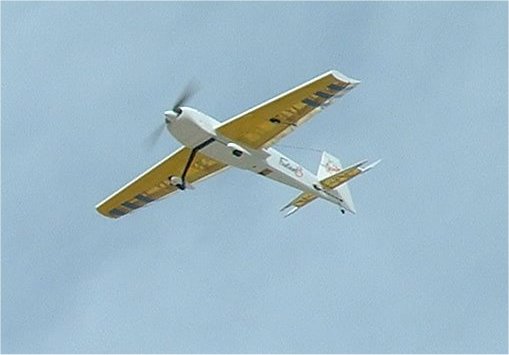

#41
Dick, it's getting so ARFs are very very good airplanes! That one is electric powered and would be more than enough plane for me.. the glow versions I've seen fly equally well.
The prices are "attractive" in the amount of time not spent building, and the construction is pretty good.
That's Tony F's Funtana BTW..
