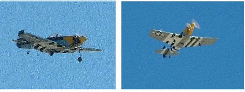

I have a full scale P 51 Mustang. I am having trouble setting my flps and elevator mixing so I can put in some elevator trim when my flaps are deployed. I am using a JR 662 radio. The only problem I do not like about this rabio is it ONLY has one setting for the flaps. I would I to set them for take off at 7 degs but I need more flaps for landing. Should I buy another JR radio taht has the landing mode and several flap setting or can some one give me some lite on what I am doing wrong.
I have landed the plane seval times with no flaps, but I am coming in pretty hot on a grass field and the grass does help to stop me. I have stoped flying the plane until I can get the elevator set with my flaps and also I need to settle on which flap setting I am going to stay with if I stay with this radio.
Pilot P51
Old 03-10-2004 | 11:15 AM
Joined: Jun 2002
Posts: 5,211
From: Palmdale, CA
Default RE: Need help with flaps + elevator
For a 2-position setup, you should use the case where you need the flaps the most, all the way down for landing, or retracted.
The takeoff condition doesn't normally need flaps.
I've tried a variable channel with all positions dialable via a knob, but that's much clumsier to use than switching.
A P-51 of course MUST have flaps down to land!
Anything else just doesn't look right!
