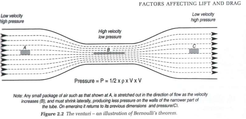

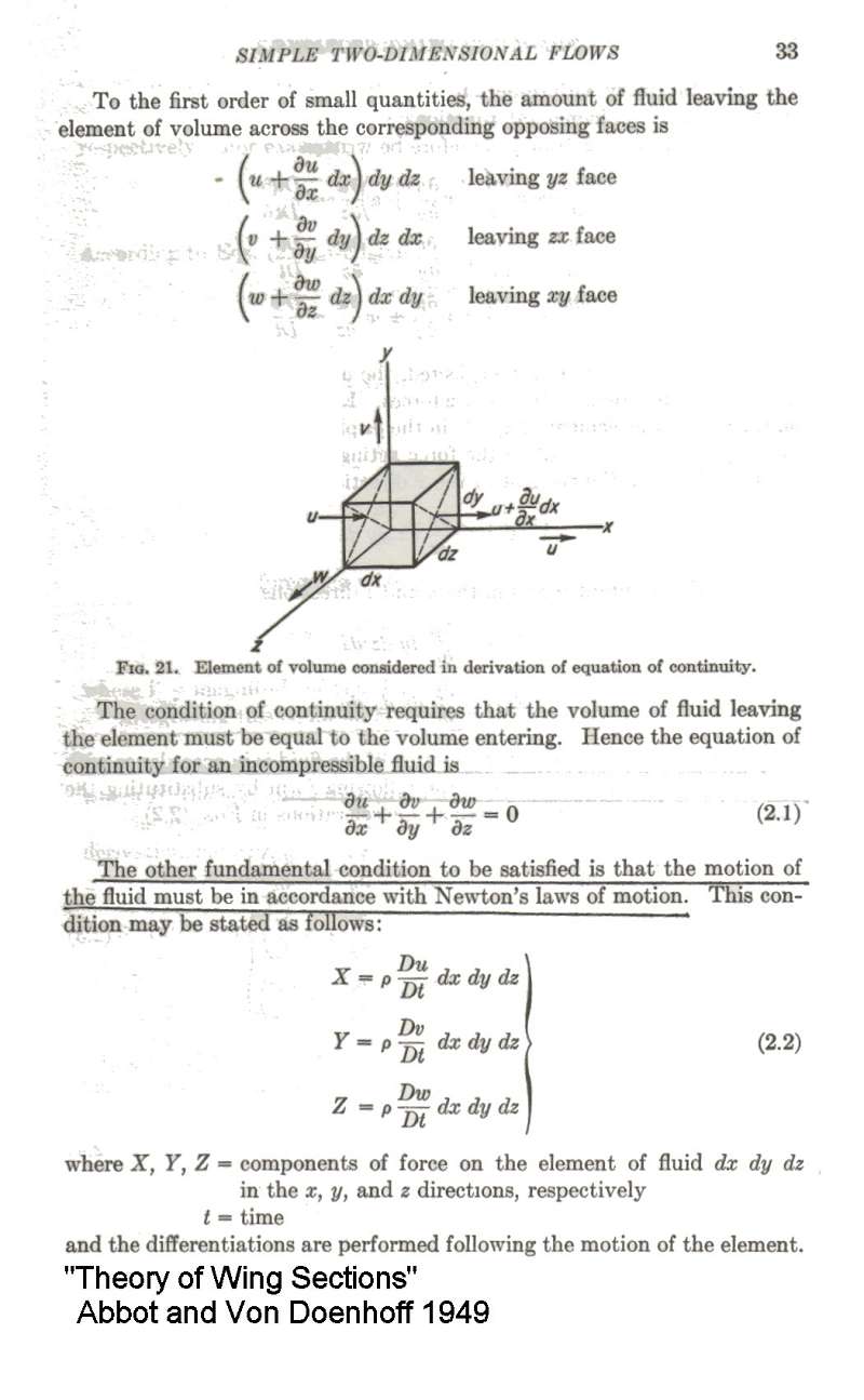

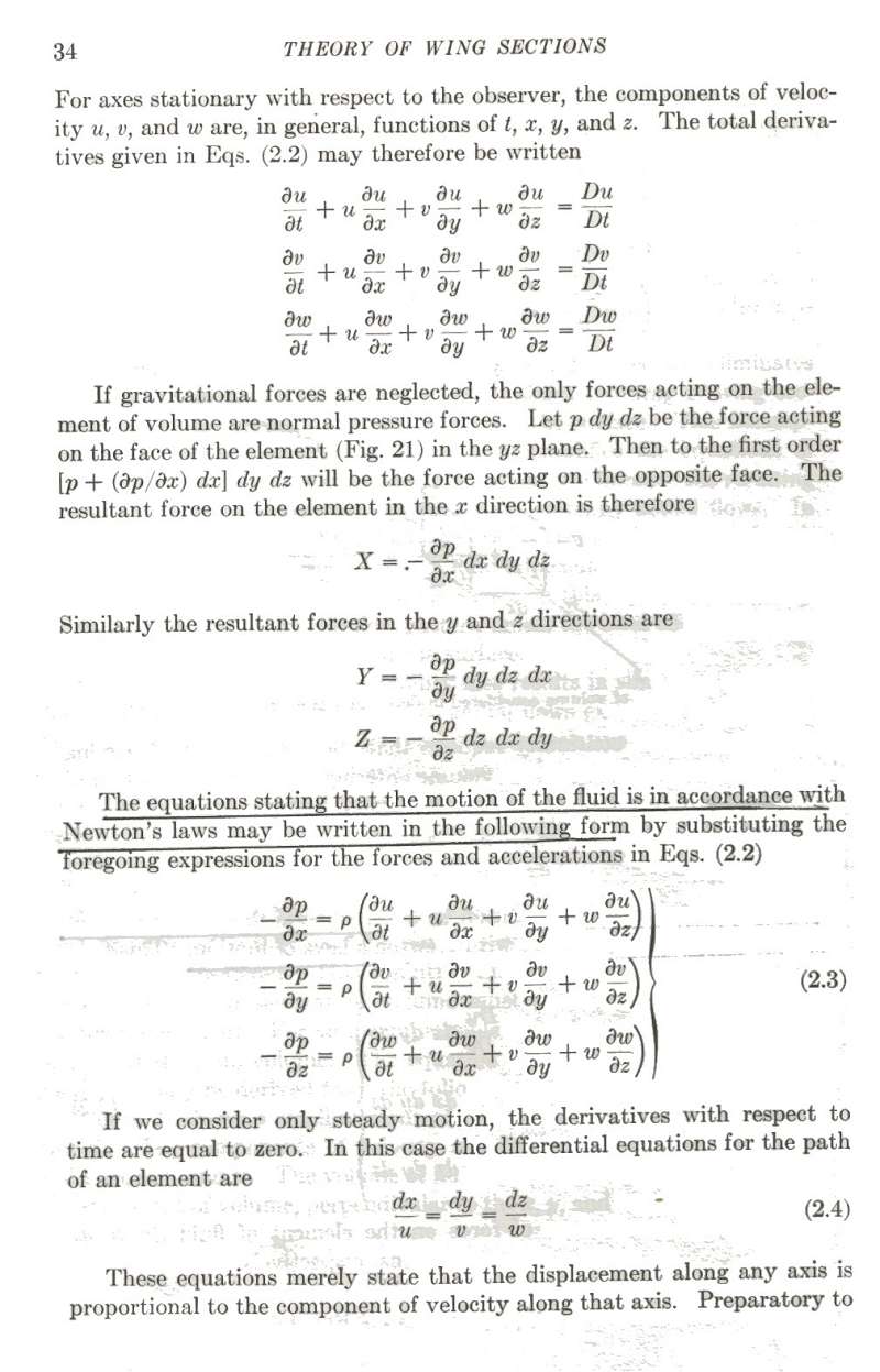

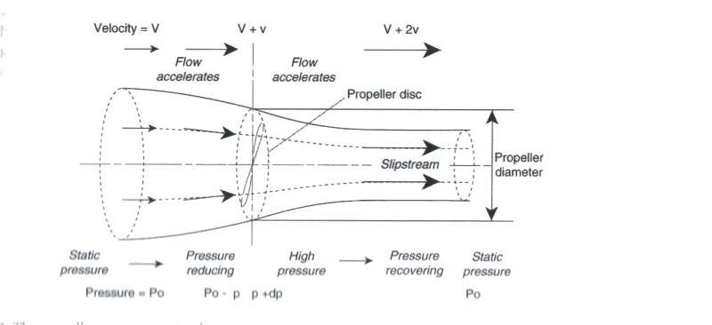

Like Lou, this stuff brings back memories.... and the old flight test motto... "Fighting back the forces of ignorance and superstition one more day"
Martin Simons* book is invaluable.. I got mine recently in about a week from England thru Amazon. com (shameless plug! )
He lays out most of what has been discussed and cussed here...
figure 1 shows Bernoulli... the change in pressure due to a change in velocity.
Figure 2 shows the air ahead of the wing is influenced by the wing's presence (up to sonic velocities) and thus a "inflow-upwash" is created...
And Figure 3 shows how a propellor does the same thing..

Jon, your post was very clear and I agree with you 100 percent.
Paul, your example of the venturi is great, The total pressure within that venturi is the same at every point, neglecting pressure losses due to skin friction. As the flow accelerates through the venturi the static pressure is reduced, and the dynamic pressure is increased. If you installed a pitot tube at any point in the venturi it would measure the same pressure, total pressure. But if you attached a static port at any point in the venturi it would measure the local static pressure, which will not be constant. Taking the difference between total pressure from the pitot, and static pressure will yield dynamic pressure. This is how airspeed indicators work, which Paul talked about in great detail in previous posts... It requires very careful placement of the static port in order to read atmospheric pressure at that altitude. Mounting static ports in front of the aircrat on the same tube as the pitot port makes the most sense. In cessnas with one static port on left side of the fuselage I can make the airspeed indicator read backward by doing slow flight in a slip with full right rudder... wich indicates that the static pressure on the fuselage is greater than pitot pressure at the pitot tube at high angle of attack and sideslip angle in a 152 or 172. In flight test a trailing static system is often used which uses some kind of calibrated cone that is doesn't care what angle of attack or sideslip the aircraft is in.

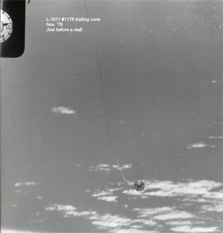

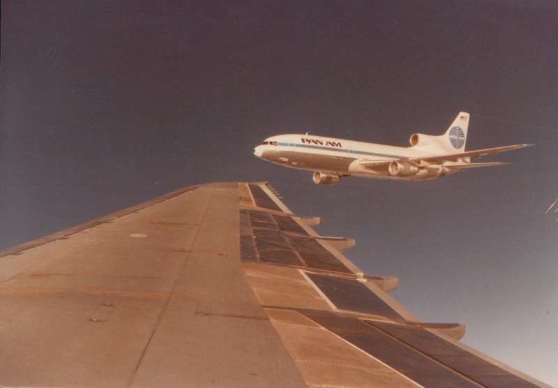

All Tristars had provisions for a trailing cone. It was used on the first production acceptance flights to calibrate the airspeed system.
A conduit from the aft pressure bulkhead in the cabin up inside the leading edge of the to the rear of the fin tip let us install one any time it was needed.
We used two types. The Douglas cone system used a 1/2" nylon tube, which was keep in a water tank when not used to keep the nylon flexible. The sensor was an aluminum pipe with a calibrated series of ports machined into the tube side. Generally it was 150 feet behind the plane in flight.
The Boeing system used a larger diameter nylon tube with a 1/8" steel cable running all the way thru it, from a location at the cabin end to the cone itself. Both types of systems had the cone about 15' behind the sensor.
We would deploy the cone after takeoff, but before the plane got to cruise speed. Once it was out, it remained out until the plane slowed for landing. On the few times a cruise speed retrieval was attempted, it was found to be impossible to pull it in!
The trailing cone system was developed as the earlier system using a streamlined lead block for weight was found to be unacceptable when doing manuvers such as stalls. It would frequently fly -around- the airplane, or thru it!
The nylon tube and f.g. cone was less capable of damaging the airplane.
I spent many hours watching these things... we frequently had a window with an extension outside the skin of the plane with a mirror so we could see what was going on behind the plane.
During two types of tests, the cone system could be expected to be damaged/destroyed/lost. Stalls. all by themselves weren't bad, but if the pilot hit the rudders... a giant wave from the fin tip vortex would travel down the hose, and usually snap the cone off.
Vmca tests, minimum speed for control in the air, were generally done low over the ocean, abt 1500', with one engine dead. Not idling, it was turned OFF!! not running! The pilot would then see if he could get the plane to fly as slowly as theory predicted! Knowing it required something on the order of 5,000 feet to recover from a symmetrical stall... I always wondered about these test conditions.
With the constant rudder required to maintain heading, the cone would be beat to death. THe cable in the Boeing system wouldn't let anything fly away, but we'd always bring back a useless mess of snapped snarled tubing from these tests.
The Boeing system had another "feature".. during electrical activity lightning could enter the cabin down the cable to the tie-off point!
Sometimes the steel cable would vaporize, and the whole thing depart out the fin!
We scattered them all over So. Cal and the ocean.
Despite a reward notice on the cone itself, we never got one back.
First picture... The Tristar is close to the stall break point, the cone has dropped behind the airplane, with the hose showing no tension on the hose..

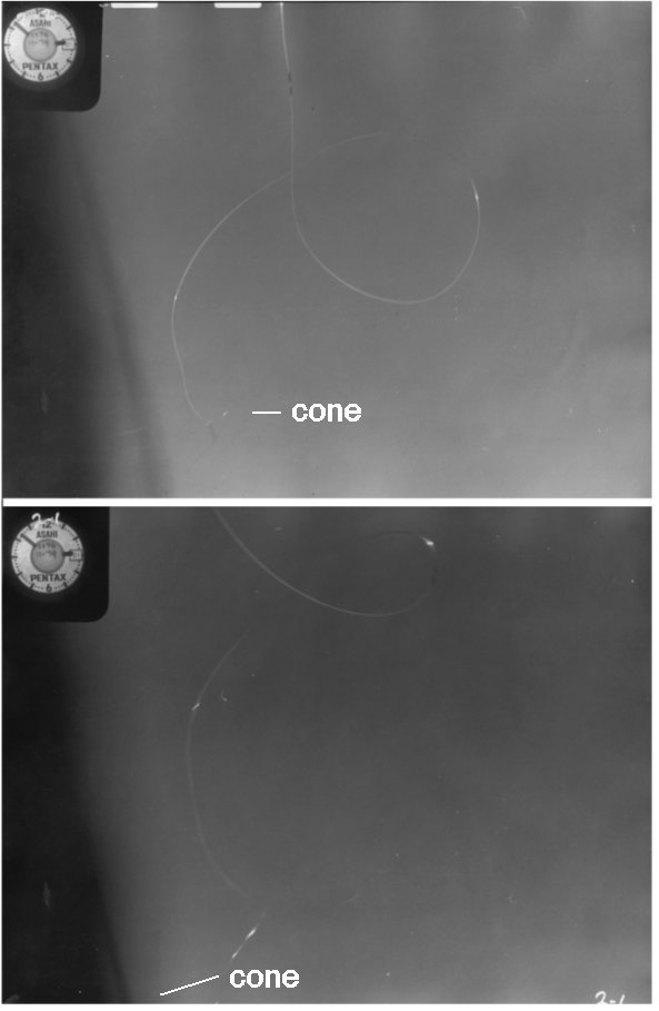

2nd picture... the wave from a rudder pulse going down the hose... a real "E-ticket" ride coming! The cone will be VIOLENTLY jerked to the right...
3rd picture... a couple of waves in the hose due to rudder pulses..
4th picture.. when it's being used properly

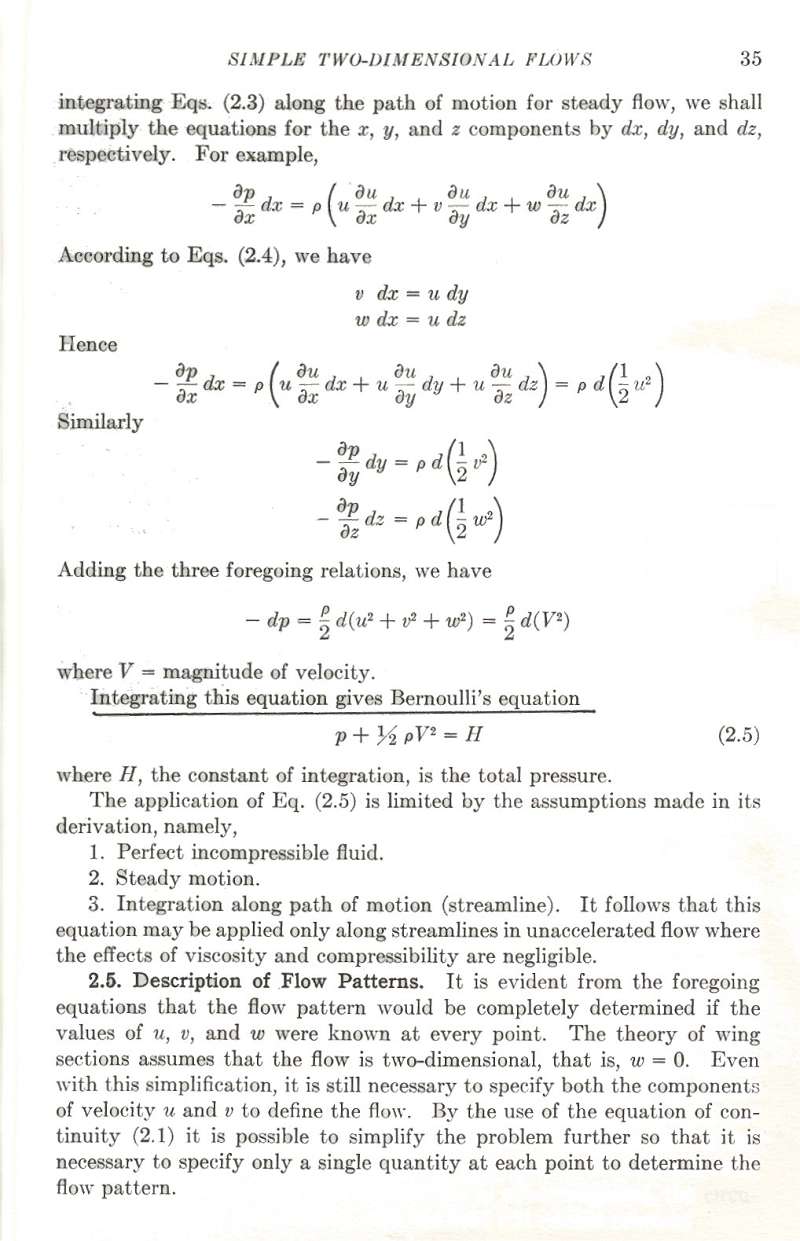

Actually, Lou, it's in my nature as an engineering pedant to prefer to see terms which are defined as specific things to be used correctly, not modified without notice of the modification.
The Bernoulli equation:
H=p + v^2*rho/2
H is the total pressure.
It consists of the static pressure, which can not be changed for our purposes, and the dynamic pressure, which does change as a function of velocity, either over the airframe or in the tunnel, and the air density rho.
For level flight, rho is usually considered a constant.
p is the static pressure.It is independent of the existence or effect of the airframe.
v^2*rho/2 is the dynamic pressure. That is what works on the airframe.
It can be fairly stated that static pressure changes on the upper surface of an airfoil due to airflow.. But then it is no longer -the- static pressure, and there is a corresponding change to the pressure on the lower surface, which is also not -the- static pressure once it's changed, but must be considered -with- the pressure change on the upper surface as they act simultaneously.
As JohnG points out, such changes can both be "negative" relative to the ambient static pressure but one can be " more negative" than the other, and the sum of the two, not each seperately is what the airframe responds to.
It's the non-rigorous use of specific terms which gets my interest, either when they're used too loosely, or just plain wrong.
When used loosely, they can lead to misperceptions, and when used wrong, they can generate serious problems if the bad definition is used to try something which is in itself not capable of working because the concept it is designed to is wrong.
Some of the "technical" explanations seen here appear to be more a subset of the "infinite number of monkeys".. typing Shakespeare.. with the more limited vocabulary of engineering making it easier to assemble technical terms at random and construct sentences which obey rules of English grammar, but in actuality have little information content, and what content there is can be totally backwards to the real world, and as mentioned can cause real harm if followed.
This is why I continually refer to other sources than just what is presented here. Sometimes what is seen hear is pure fantasy. Other times it's just fine, but there's enough fantasy presented as fact to create a "caveat emptor" attitude... Free advice is worth what you paid for it.

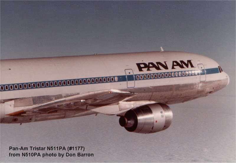

Lou the Tristar program had more influence from the guys we picked up from Boeing than Marietta, as I recall.
The Georgia guys did more of the autopilot stuff, while the Renton's did the aero.
Most of them returned to their respective "sources" when the L-1011 program failed.

It seems that Abbott and Von Guenhoff went through the exact derivation as James Dwinnell did in my old aerodynamics textbook. We are in complete agreement concerning both the origin and constraints of the Bernoulli equation. I also found the Roger Long article quite interesting, especially the mention of the Coanda effect. That is something not predicted by theory but since it is an observed effect we just name it and drive on.
Now lets look at some implications.
First, the air doesn’t “flow”, it just sits there waiting for something to happen. Then a wing passes by supporting an airplane in straight and level flight. After the wing has past, the air that once was resting is now moving downward, and slightly forward. There was obviously some force acting on the now moving mass of air and there must have also been an equal and opposite force acting on the airplane. The force on the mass of air put it in motion because there was nothing other than the inertia of the mass to resist it. The airplane remained steady on its course because the force on it was resisted by an equal and opposite force due to gravity. So far Newton’s laws of motion are satisfied and it is obvious that the force maintaining the aircraft in flight is a reaction to the wing deflecting a mass of air downward. The wing in its essence is just an air deflector.
Now because Mr. Euler, Bernoulli, and company are so smart, they figured out how the wing does it, and here is how.
The wing moving through the air parts the air with some of it passing above and some below. The air moving over the wing is bounded below by the surface of the wing, and above by the air that is far enough away to not be immediately effected by the wing’s passage. This forms the stream tube in which Bernoulli’s equation applies. Pressure is reduced above the wing and across the entire cross section of the stream tube according to the relationship he defined. Whatever pressure distribution then exists along the chord of the wing, a mirror image of that distribution also exists at the upper boundary (Neither can exist alone. Where one is, the other is there also). Granted that boundary isn’t as well defined as the solid surface of the wing, but it is real nontheless. The free stream air at the boundary moves downward toward the area of reduced pressure (and having been set in motion, continues this motion after the wing passes). The wing doesn’t move upward since the net upward force is balanced by the weight of the airplane. A similar thing happens to the air going below the wing but the pressures are less negative or even slightly positive depending on the angle of attack. The final net effect of the wing on the air is to accelerate it downward, and slightly forward.
A thing that is heavier than air cannot fly except it moves air downward. Helicopters do it with rotors, birds and bees do it with the complex flapping motion of their wings, and a fixed wing does it by causing a pressure field to be formed when it is in motion that “pulls” the air downward by its’ passage. For all of its complicated formulas, and mathematics, in the final analysis, aerodynamics is the study of how to accelerate air to produce a force to sustain, propel, or maneuver a flying machine.
