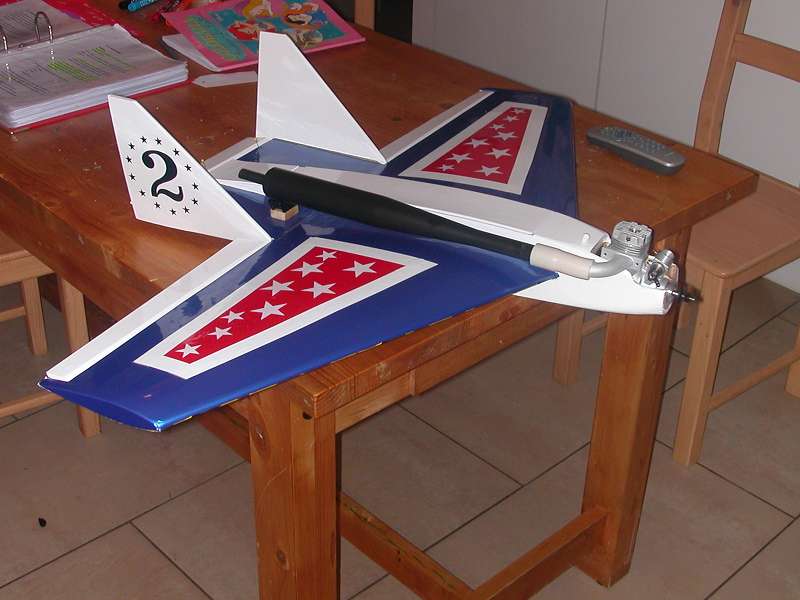

For that kind of thing, I wouldn't bother with messing with winglets, for all the reasons mentioned above, and in those threads that were mentioned. But a lower-drag wingtip might help a little, or it might not.
However, I would see about smoothing out the engine/pipe installation, lots of drag there that can go away. And maybe a fillet along the wing/fuse joint to smooth that out as well.

Salmonbug, that cutoff wintip that you have already is probably a darn good option. I actually wouldn't mess with it. I would worry about all that profile drag that you have on that thing.

salmonbug & strykaas,
I'll assume you are both flying the same plane. Looking at the picture the salmonbug posted, I would say there are few things you could do to get some drag reduction. No wingtip treatment for induced drag reduction would be among them. You are optimizing your plane for high speed flight. At high speed, the CL will be small, and induced drag will be correspondingly small. There are several things you could do to reduce profile drag:
1) Put a nice fairing behind the engine, leaving a gap or channel for cooling flow.
2) Put nice rounded wing tips on the wings. Some people will tell you that a square tip, as is on the plane now, will reduce induced drag. I don't believe that, but I know that a rounded tip will reduce profile drag, which probably matters much more for your race.
3) Make some nice smooth fillets for the inside corners where the vertical stabilizers meet the fuselage. Some soft balsa stock could be glued there and carved/sanded to nice, smooth, rounded fillets.
4) Add some fillets where the wing joins the fuselage.

What Bank said, and...
Add lightness! Take out all the parts you don't need for THAT race!
The one's you must have, use the minimum amount of material.
The lighter plane has a bit less drag.
Move the c.g. back as far as you can stand..
That also cuts trim drag.
But if there's turning involved... you will have to outfly him.

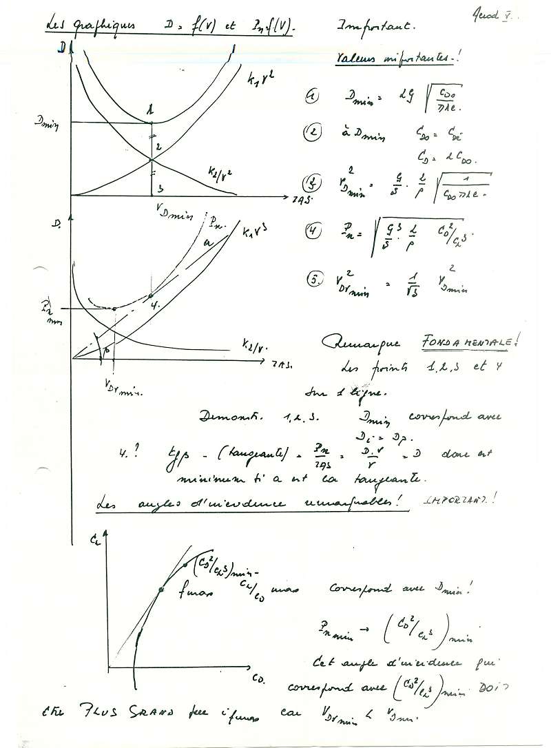

Induced drag goes down as speed goes up, but it will still be the predominant form of drag on the aircraft at speeds below about 200 mph. (That REALLY depends on the value of C_Dp for your particular craft). In other words, reducing it will get you the greatest gains in drag reduction.
Lightening the aircraft's weight will effectively reduce the C_L needed to keep it aloft. Your trim will be different though and now you have trim drag to combat (off-design flight). The best option in this case might be to reduce the incidence of the main wing.... that may be going too far with modification to your aircraft though. You need to target a speed and lower the wing incidence to match it. I would think that the lower induced drag would really win out over any bad trim drag that you may encounter.
I am pretty sure that this is incorrect. Why do you think that induced drag is the predominant drag component below 200 mph?

The predominant form of drag really depends on how much of each form of subsonic drag that you have. Parasite drag will definitely become an increasing problem with increasing speed, but we need to consider "how much" of each form of drag that you have. If you have say, 70% induced drag at the speed you are flying at, it makes more sense to try to reduce that 70% rather than go after the 30% of parasite drag. See what i mean?
http://142.26.194.131/aerodynamics1/Drag/Page9.html

OK... check out this simple graph on the following web page:
Basically, it shows that induced drag dominates the low speed regime in aerodynamics. Obviously it really depends on the aircraft. Can i quantify it for the particular aircraft in question? No. I dont think that anyone could without the wind tunnel tests mentioned. It's a question of where that minimum lies for the particular craft in question.
Nonetheless, induced drag is an important drag force on model aircraft... simply due to the fact that we are operating at low mach number. I mention mach number because induced drag goes to zero as we approach the speed of sound. It is at it's highest at the lowest speeds that we would fly at.

altough the drag/eas curve is one of the most remarquable one in aerodynamic. I believe that in our application it's more intersting to base our speculation on the PN/Eas curve.
99 procent of us fly with internal combustion engines turning a conventional propeler after all......
here is a synthesis of the comparaison of the two curves I made 15 years ago. If you want more explanation and theory about some interesting points on the curve, feel free to ask.
compressibility drag has been omited in those curves
