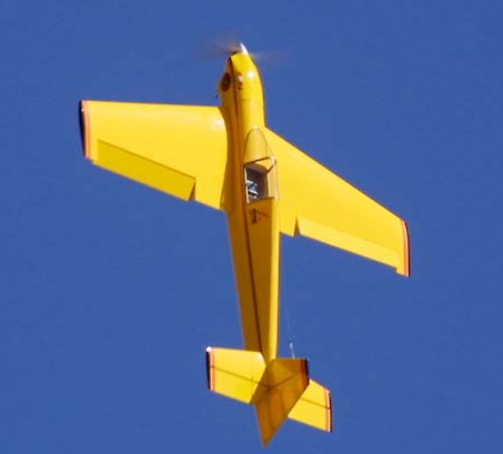

Like this?
Like this?
The yellow model I show, weighed 11 lbs with tuned pipe ZDZ40 - this was true -INSTANT unlimited performance - literally OOS vertically in a few seconds.
Unlimited in my book is a VTO setup.
My 13 oz foamies are also "unlimited " drawing 9 amps on a 4100 Himax.
