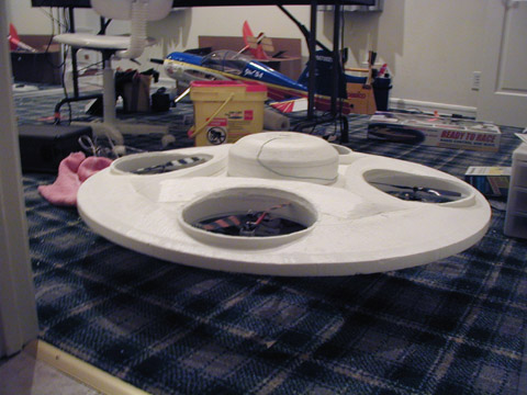

I have a scratch build rc ufo. weighs about 44 oz and is 38" diameter. the cg is well below the propeller line (by about 4-6") but when i try flying it, it will rock bakd and forth to such an extreme that it is uncontrollable. any ideas what may be causing this?

circular. how do i fix it? i thought by cg was low enough the center of the props are about 24" apart and the tips about 14" apart.

there is no fin. it is a vtol aircraft, with the propellers up top and the cg down below.

yes. BTW, after some thought, i dont think fins would work anyway because my airspeed is just about zilch. i have mixed them so i control them in pairs for aileron and elevator, all together for throttle, and linked in pairs so i can speed one pair and slow down the other causing the torque imbalance to turn the model. they are counter rotating props. i do have some control but it does not wayt to stay vertical. it just rocks back and forth until it falls out of the sky (about 1-2 cycles)

already got them, i forgot i had turned them all the way down, but they are mounted. (it is fun to be me) but i am still curious as to why it does that. it should act like a pendulum and senf center i should think... i would like to try and solve the problem without the aid of gyros as much as possible, but when it starts to require extreme measures i will just let the gyros pick it up.

However, it sounds like you need to add lateral stability - like someone earlier said. If you look at the fan forces, if they are all thrusting straight up, there is nothing to restore the UFO to a level hover when disturbed. WHat you need to do, is tip each fan unit so the exhaust is pointed slightly outward from center. Either that or modify the exhaust slightly outward using a vane of some sort. In this case lateral and longituinal stability are the same mechanism. THIS (angled jets) is what the Harrier uses for stability - the puffer jets are for control.
It works on the same principle as dihedral, to a certain extent. The "down" side automatically experiences more lift and the "up" side gets less -> return to level flight.

that is a good idea. i will try putting a small angle that vectors a small portion of the thrust away from each motor. do you think that will make a difference? i cant really tilt the whole fan unit becuase it is alreayd epoxied in place and it would be huge major surgery to break them off and i would most likely have to replace the entire CF structure to do that...

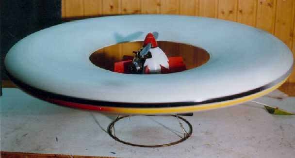

Is this UFO your own creation? If not could you please tell us about the device. Where is it made, if you have a URL for the manufacture, the cost, or any other details. This looks like a very interesting device.
You may also like to look at the TurboPlane, a VTOL aircraft from Austria. It was made in the 1980. You can check out the original craft and photos of my copy of the device at:
http://community.webshots.com/user/poppyparrot
You can see movies of the craft in flight at the English/German site as well as more photos of my craft at:
http://www.turboplan.de/
Poppy Parrot
