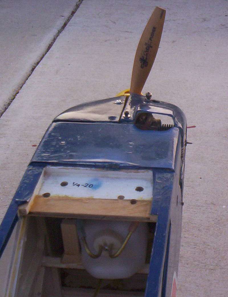

My push-pull Kadet, at 13 pounds, will fly equally well front engine only or rear engine only. Two 40 FPs, which aren't the most powerful..
The rear motor MUST have a cooling air scoop. Even uncowled it would overheat.

I guess if the fuselage is nicely streamlined (not that Paul's airplane isn't :-) the air presentation to the prop isn't that critical. That does leave you with the difference in drag (due to difference in velocity) over the length of the fuselage as the big factor. It doesn't show up in Paul's flying but should in a cruise power comparison where a few mph or fuel flow can be measured.
It certainly indicates that there isn't enough difference in the model world to drive a design.

Here's the rear motor installation.
The upper scoop made all the difference in engine cooling. The small one on the side was supposed to be enough, but it didn't do the job.
The gas tank is put in conventionally, with the fuel and pressure lines wrapped back to the motor.
Both motors use the same throttle servo.
There's a 10x5 prop on the front, and a 10x6 pusher on the rear.
When both motors are running, it flies like an .80 powered Kadet is supposed to!
The liquid cooled version doesn't have any provisions for aircooling the engine.
The only scoop is on the starboard side for the carburetor.
The jet version scoops would be a good option, but not scale unfortunately.
