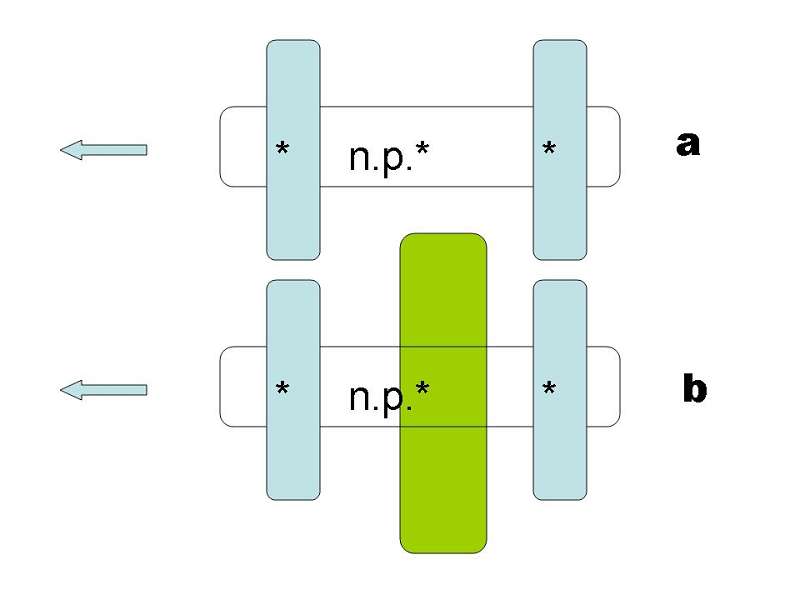

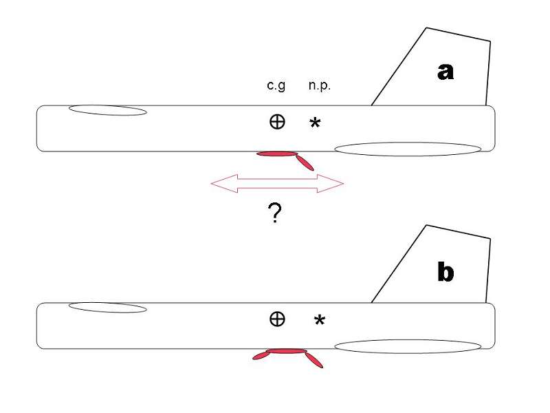

Dear fellow designers, I would very much appreciate your input on the use of a flap to be mounted on a canard currently taking shape on my drawing board. The idea is to mount the flapped surface in such a way that its deployment will have minimal effect on airplane pitch. My questions are as follows:
a)where should I place the flap relative to the c.g. (or to the n.p.) ?
b)do you think a combined flap/slat surface would be feasible and more effective ?
My spontaneous thought...
... would be to have the 25% chord point of the flapped surface to coincide with the c.g. as depicted but before I proceed please feel free to have your viewpoints on this….Thank you….and…..Cheers/Harald
PS….yes indeed I could combine lowered flaps on the main wing and foreplane via a mixer to achieve this but for certain reasons I will not do that in this case….(please disregard my two empty uploads-dunno how to delete them).…DS
... would be to have the 25% chord point of the flapped surface to coincide with the c.g. as depicted but before I proceed please feel free to have your viewpoints on this….Thank you….and…..Cheers/Harald PS….yes indeed I could combine lowered flaps on the main wing and foreplane via a mixer to achieve this but for certain reasons I will not do that in this case….(please disregard my two empty uploads-dunno how to delete them).…DS

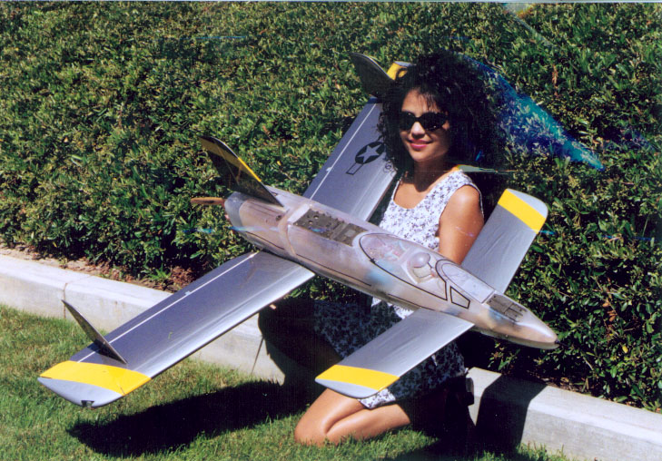

I designed and built a canard with flaperons and leading edge slats a few years back. I found that I could not use the slats, let alone the slats without the pitching moment of the airplane going way beyond what the canard elevator (full flying in my case) could handle. So you are absolutely correct that a flap arrangement had better take into account the pitching action. And, it is not the change in pitching moment of the airfoil section itself but the fact that a canard is a BIPLANE and the rear plane, in my case, suddenly had tons more lift than before.
The Beech Starship, as I recall, has flaps but the sweep angle of the canard surfaces changes to move the canard forward when flaps are deployed, which is clever. I assume it works.
The big problem with your idea is that you are adding a third major surface which will affect the np of the airplane by moving it way forward, just as if you moved the main wing or added surface to the front of it. I suppose you could add a surface that "weathervanes" in such a way that no lift is imparted to the fuselage until you power it into an angle of attack??

Here's a shot of my canard (currently a hanger queen because it was just too heavy and complicated)

Hi guys and many thanks for your replies...
.... will try to answer the best I can:
cwrr5: Yes, the reason for the flap is to create drag and produce more lift at lower airspeed to shorten take-off and make approaches steeper. I fly from a rather confined field with big pines and firs. My avatar-canard was tough to land forcing me to approach between two big pines. Any “cool-factor” of the flap would be a bonus…never mind..
Allan: adding a third surface in between two canard wings(b) must NOT in my mind necessarily move the n.p. at all if new wing is properly located. See my attached example with a third larger wing added but with its 25% chord point exactly overlapping the n.p. of the original canard(a)....n.p. stays the same…right..?
Paul: the position of this third wing must be critical to avoid a pitch response assuming the c.g. of the ship is unaltered..right..?
All: as to the pitching moment of the third mid flap my assumption is that it would have a very marked “nose down pitching moment” when flap is lowered and that would further “load down” the already heavily loaded foreplane. To compensate for that I suggested in post #1 to move it a bit forward and coincide with the c.g. rather than the n.p. of the plane. That was my initial TLAR type of reasoning…but shoot it down if you will..!
So the Ferret is your creation Allan.!!….I was so fascinated by it I had to buy a back issue of RCM just for the sake of the Ferret but I´m sorry to hear she is just hanging there now…..more pix..??...pliiiiiis…!

Heeeey...... I still have my copy!!!!! COOL!!!! I spent HOURS looking at that thing(and drooling). We got us a celebrity here!

JohnG's leading edge flap concept on the aft plane might be just the thing to increase max alpha, max Cl and also aftplane stall speed.
Remember flaps increase camber and decrease the max alpha of stall on a given wing. I have a model which cruises on third power with the body 5 degrees below horizontal in level flight with flaps down and stalls with the body horizontal - the visual cue of body angle as an indicator of airspeed is v. misleading with flaps deployed.
I'd build aft leading edge flaps, standard foreplane flap/elevators (using computer mixing). Another option would be to build oversized ailerons on the aftplane with 2 servos and use mixing to dial in aft plane standard flaps.
Build in fleixibility with your design - and use radio mixing to use whatever works.
Good luck! - and would really like to hear how you get on....
the canard my father designed last year takes off fine - though it needs a longer run than a conventional planform because the foreplane is naturally more heavily loaded, and is operating at a lower Re than the aftplane...
however it does seem capable of an aft plane stall - It's like both wongs just go and the thing drops out the sky flat - the nose doesn't drop that much.... You are probably going to say that the CG is too far back - but that doesn't seem to be the case - e.g. in low speed cruise I can hold in full up elevator and it does an impression of "having non-circular wheels on the front" - the nose bobs up and down alternately stalling mildly and recovering. It's just in very slow flight that the full both wing stall can occur and very rarely.
The reason why I bring this up is that an aft wing stall is highly undesirable on landing approach! Adding flaps to the canard only could introduce a situation where the stalling speed of the canard is below that of the aft wing - of course dependent on relative incidences, airfoil selection, reynolds number.

When I did the 1/3rd scale Berkut (RC-wise, a long EZ with retracts - See http://homepage.mac.com/mikejames/rc.../berkut01.html ) I had the same issues that Allen has just mentioned. Little or no rotation until a high velocity, lacking elevator authority in general, and the fast landing approaches that go with that. The Berkut setup is the same as Rutan's, with a slotted flap-type of elevator surface on the canard, which I duplicated. Now, assuming the CG isn't simply too far forward...
My solutions were experimental, and were a three-step approach...
First, I tried to fly the airplane with the scale airfoil on the canard. (and scale chord, of barely 4 inches at 1/3rd scale) From past experience, I've learned that one of the "break points" in model aerodynamics (for planes, say between 5 and 15 pounds) is that when the chord of an airfoil drops below about 5 inches, you no longer have the predicted performance for that airfoil. (especially at speeds under about 30 mph) The Berkut would not rotate at all with the scale canard and CG, and ran off the end of a 300 foot long runway, with an OS 1.60 at full power. (Nice engine, by the way)
Step two was to switch to a Clark Y airfoil, increasing the chord by one inch, (to 5 inches) and increase the span about 2 inches on each side. I also increased the incidence of the canard one degree, and "jacked up" the nose gear a couple of inches to put the airplane at a higher angle of attack for takeoff. The airplane would then rotate in about 250 feet, but at a pretty hefty velocity. It had to be flown at full throtte all the time, and would descend in turns, so we had to alternately climb, turn, etc.. We managed to get it down without a crash, but again, at high speed.
At that point there was a huge amount of input from my friends at the field. The most common thoughts were that it was "too heavy", or "needed more power". I believed that it was an airfoil issue. Why? Simply using the "That doesn't look right." rule, it seemed to me that the airplane ought to be able to fly at a lower speed. After all, I did all the wing loading, Reynolds numbers, MAC, CG, stuff before I built it.
So, step three was to switch to an Eppler 197 aifoil, (Thank you, Andy Lennon.) and increase the span 2 more inches total. ( one more inch on each side ) Adding these dimensions, the plane still was very close to scale, and most people wouldn't notice. Knowing that canard airplanes have a wider than normal CG range, and since the plane had been stable so far, I moved the CG back one inch. (not much, on a 1/3rd scale plane) I removed the shims I had used to create the additional canard incidence, putting it back to the original setting. I rotated the nose gear back to it's "fuselage level" position.... That was a leap of faith.
Voila! The plane now rotated at "normal" speed, in about 100 feet, climbed agressively, and had enough power in the mid and low throttle range to "yank" the plane into a forced stall position, where it showed the proper canard performance of settling into a level, stable, "pancake" sort of decent. The plane would go back to normal flight mode by decreasing elevator pitch or adding throttle, exactly as it should. We dead-sticked it, and it landed as well as any similar size plane.
So, this HUGE difference in performance was the result of increasing the canard chord from 4" to 5.25", and increasing the span about 6 inches overall... hardly noticable at 1/3rd scale. If I had taken the advice that it was "too heavy" or "needed more power", I would've been chasing the wrong answers.
Of course, what I did may not translate to your plane, so who knows? But, that's my recent experience, and also my reasoning for thinking that a better canard will solve your problem with no need for flaps. (Or, you could use a speedbrake, instead of flaps, if needed later)
