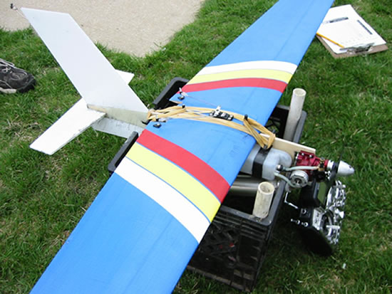

I'd like to return to this thread for a couple of comments. I'm working on a plane for the same class as The Tick,,,,,,,,only I'm not an engineer.
Specifically, I'd like to see some reccomended airfoils.
The plane is A class, slow combat, .15 engines (box stock), 40oz. Minimum weight, and minimum 400 sq. in. wing area.
We are looking for adequate speed, with maximum turning ability while holding the speed thru the turns. But we need something that does more than turn left and go fast. I am interested in a high aspect ratio wing with a span of 54" to 60".
I have looked at S8036, S8037, E203, E197, and E209, and combinations of some. I haven't found the performance I am looking for.
Suggestions. I have Profili and cut my own foam.

What you need is a variabl camber airfoil (flaps). If flaps are permitted then a relatively thin airfoil with flaps mixed to the elevator will extend the range of coefficients of lift and with the low drag you are looking for. To keep from loosing too much speed in the turns, the flap travel should be limited to about 5 degrees. With careful design of the hinge line and a thin airfoil, the drag won't go up much with so little flap but the increase in lift will be substantial. Go with the MH33 or S6063 and 22% flap width. Use full span flapperons. Don't make the tip chord less than about 75% of the root chord unless you want easy spin entry and snappy snap rolls.

Thanks Ollie. That last sentence was one I was wondering about, and didn't have the answer.
I'll try the flaperons.
Appreciate the help.
