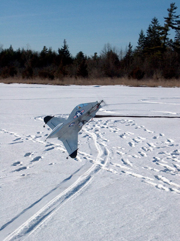

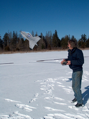

Rule of thumb is 15 to 20 % Built a foamy Convair Pogo and set the CG at 20 % . Being sceptical, I built a 9 in. glider with the same planform and the CG came out at 20 %
