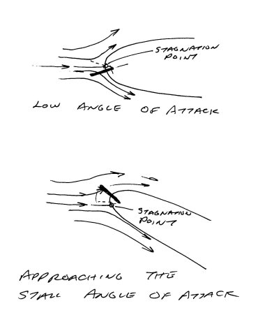

I'm going to throw this question in here and see if someone has an idea. I remember on a full size Cessna a pivoting metal 'flap' device that activated the stall warning buzzer. This was on the LE. I don't know what other types may be out there. To replicate this on a model, I'm wondering how to create this. I'd like to do this on a model with tv tx and an audio channel. What puzzles me is the relation of the airflow to the flap at high AOA. Any thoughts?

Cessna most likely determined the position by empirical means. It probably was some variation of mounting it on the leading edge and moving it around until they got consistant performance at stall.
I do remember from over 40 years ago that it was part of the preflight to turn on the master switch and push the little tab upwards to chech for reeedom of movement and that the stall warning horn was functioning.

I suspect you're correct as far as the placement is concerned though there may be more sophisticated methods for designing these in larger A/C. As I recall, the Cessna's 'flap' was more inboard. I had some hours in a Piper Cherokee but recall nothing as to how it worked. Can you explain the inertia aspect, and how that translates to models. With my limited flying experience in the above planes, you 'feel' the stall coming on. Trying to compare the relationship of the speed curve between, e.g., 'slow' flying and a stall. I recall years ago flying an old Schweitzer sailplane wherein the the difference between speed at level flight and stall was maybe 2or 3 knots.
There is a line along the wing leading edge where the flow divides with some going over the top of the wing and some going underneath. That line is called the stagnation point. It is close to the nose of the airfoil at low angles of attack and moves downward as the angle is increased. The stall warning vane is located such that as the wing approaches the stall angle the stagnation point moves past the vane causing it to be blown the other way by the change in flow from below to above the wing. The warning must actuate not less than five nor more than ten knots above the stall speed.
The switch is positioned to the initial location during production and it is checked during production flight test. There is an adjustment available of about 3/8 inch.
For an aircraft like the Cessna 172 and Piper Cherokee, the stagnation point moves a sizable fraction of an inch. For wings the size of a typical R/C model the range would be almost micrometer size. Although the same principle applies, in practice it would require a level of precision that would be difficult to say the least.

As far as a vane to sense stagnation point, on a wing sized for a .40-. 60, airplane the movement would likely be somewhere around 1/16 inch. Though such a small and precision device might be made, it’s not likely to be rugged enough to withstand the rigors of model airplane operation.

Angle of attack is the angle between the direction in which the wing is moving relative (relative wind) to the chord line of the wing. It bears no relation to the horizon. It can be low in a climb and high in a glide depending on the elevator position. During my full-scale aerobatic training, I would occasionally pull too hard at the top of a loop and stall the wing while the airplane was inverted.
The two holes in the ball would be located as shown. At zero AOA, pressure would be equal at both holes. At a positive AOA, the lower hole would have a greater pressure and the upper one would have less. It would be possible to calculate the difference but I suspect that for any real accuracy, it must be calibrated with a measured angle. For model speeds, the pressure difference would quite small and very good accuracy would be required to give meaningful results.
