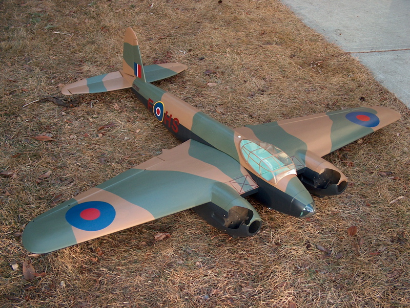

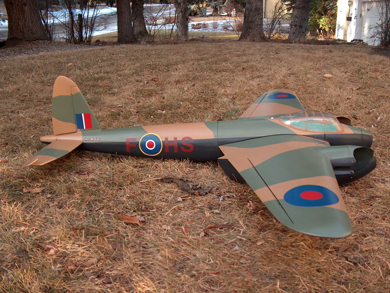

Here are the latest pics. It will weigh something between 4.5 and 4.75 lbs, so I'm pretty close to being on target.
The port wing has a positive incidence of +1 degree. (I rushed that part [:@]) Hopefully, that will trim out easily. Any thoughts?

Really nice plane,
and it looks like you have the world's cutest copilot....
Bob

I bet you call her "Skeeter".
one degree is 1/4" in one foot --that is a lot .
I bet your alignment error is less than that.
Nice mossie

I put a lot of washout in: 3 degrees.
It's all ready to fly now. Test flight soon. Maybe this weekend. I'll let you know.

The 8055 is a little thicker and has a little more camber. Both of those traits will make it a little more stall resistant. But I would still use 3 degrees of washout. The taper on that wing is extreme and you don't want something that small a span suddenly tip stalling. The extra camber will help to make up for the losses in lift due to the washout.

It flies!
It is quite windy, and I probably should have waited, but I tried it today. Overall, I'm pretty satisfied.
It is quite forgiving, but not over-powered. The engines were giving me just over 13000, turning MAS 8X4's. Once they are a little more broken in, I'll switch to 7X6's, and see if I can get a little more. Sounds great though!
I did not detect any tendency towards a sharp stall or tip stall.
It really needs rudder for a co-ordinated turn. In fact, once you are in a turn, it wants a little opposite aileron, and lots of rudder.
The alignment problem is definitely noticeable, but it does trim out.
It flies like a bomber: stable, and happy to be flying level or in a shallow bank. This is not an aircraft for maneuvers. But the ground-handling is excellent, and a long scale take off looks very nice.
As expected, the wing loading is quite light, so it got tossed around a lot close to the ground, and was damaged in a cross-wind landing. No structural damage -- just shell which should glue back easily. Also, the wing mounting blocks detached.
