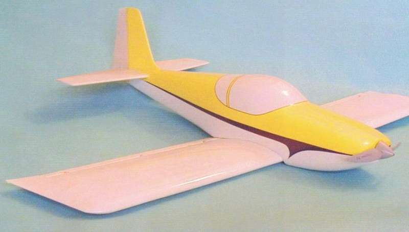

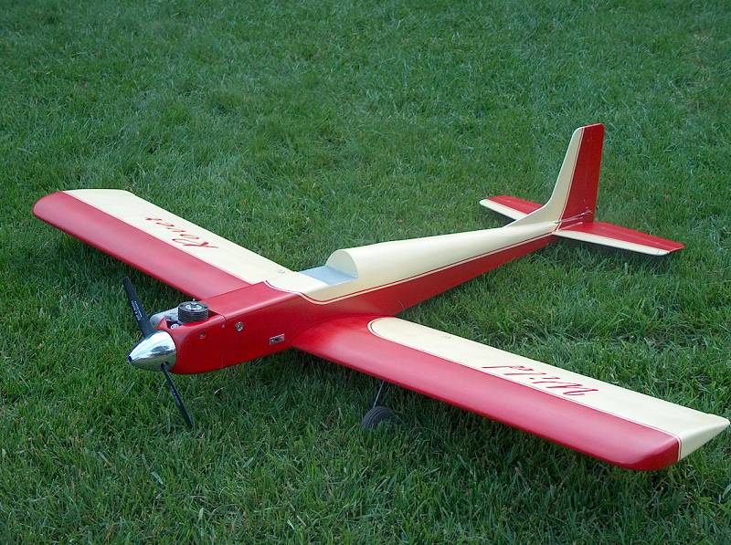

I kitbashed a 4*40 to take the Selig, so that I could see how it performed. My intention was to compare it against a stock 4*0 that I also had.
It might have just been me, but I 'seemed' to notice an increase in speed from the stock airfoil (not sure if that was real or imagined), but it satisfied me enough to want to use it for my scratch-built scale plane.

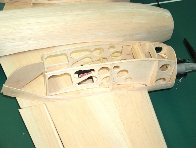

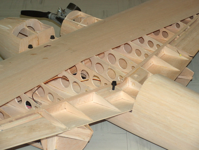

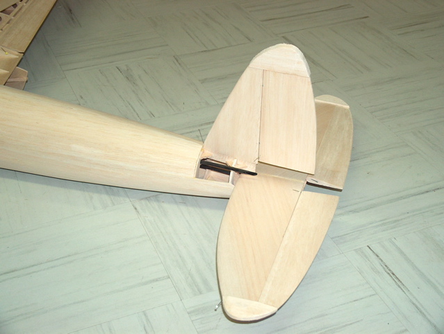

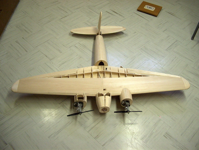

I dropped the Mossie project over the summer, but I'm back at it. Here are some progress photos. I rushed it in some places, so it is not a fine example of craftmanship.
I built another little craft to 'test' the Selig 8036. It is exactly what I was looking for. Thank you.
I weighed almost everything together today. With radio, motors, batteries, fuel tanks, wheels I am at 3lbs so far. So I should be comfortably under my target weight of 4.5 lbs. This will give wing loading in the 19-20 oz range.

Lovely job you're doing there. I think you'll find that if you can stick to the 4.5 lbs it'll be a nice flyer with a pretty decent landing speed.

Steve: here is a picture of my Selig 8036 test bird, which I built to look like a 30's racer. I think I put about 3/8" washout on a 8.5" chord, so that's a lot. It has never tip stalled, though I have pushed it to try. Also, slows right down and lands like a trainer. I would not hesitate to go with that.
Bob: good to hear from you! De Havilland Mosquito, not Comet. I reduced the taper, and lengthened the tail moment for more volume -- makes it look a little different. I have finished the nacelles, and last night I molded the canopy and cowls (See Tips and Techniques thread - 'Vacuum Forming ideas') How's your racer coming along?
Lou
Lou
