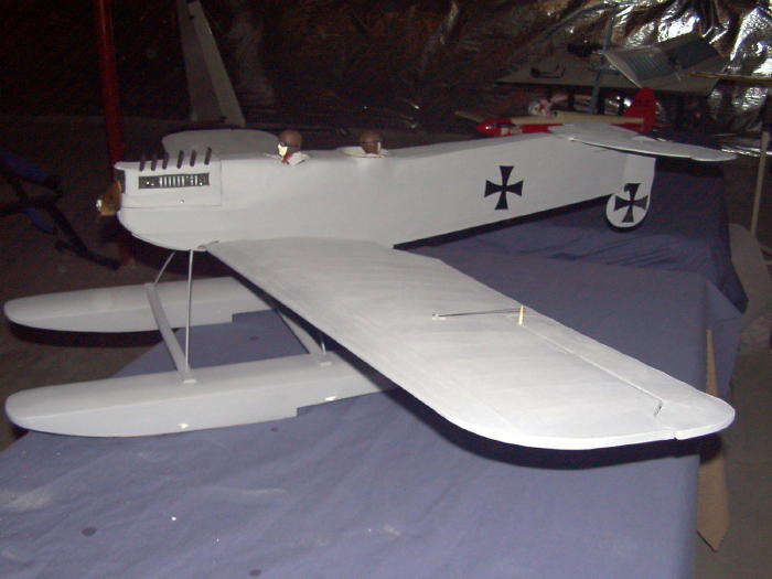

Default Rudder below thrust line
Here is a photo of a model I have made. It is a 1918 Hanza-Brandenburg W-29. As you see the rudder is strange. I have not flown this yet but it taxies great on the snow. The rudder has lots of travel and lots of authority on the snow and on the pavement too. The rudder is right in the propwash. There is no water rudder on this nor the full size.

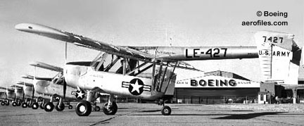

Default Upsidedown
Jim
Finn: nice looking model but did the German's copy the Americans or the other way around? 1946 Boeing scout plane below.
Old 03-06-2003 | 10:40 PM
Jim Finn's Avatar
Posts: 660
From: Lubbock, TX
Default Rudder area above & below thrust line?
The w-29 is from 1918 so I doubt they copied a 1940's plane.
