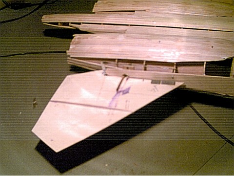

I have attempted here to calculate the MAC and placed the pivot point at 25%. the 'actuator' is at the rear and the fuse and will link to the servo which will be inside. I placed some weights, as you can hopefully see, to balance the taileron, which is quite tail heavy. The question here is whether this the way to set up this surface to provide the best operation? If it matters, the surface will built up (lightening holes in the ply), sheeted, and glassed. It will be more or less symmetrical airfoil. Any thoughts? Bill S.

Balance it just a bit tail heavy, to provide some inertial damping.
The hinge point a percentage or two ahead of the 25% point provides aerodynamic damping.
I've done field tests with full-flying stabs like what's shown in the pic you posted and I found that it's not really necessary to static balance the stab when the pivot point is at ~23% MAC. The aerodynamic tab provides more than enough force to counteract the weight of the stab that's aft of the pivot.
Looks like you're building a Flanker. Is that your own design? What's the power system going to be?

Yep, it's a Flanker, 9' OAL. Bertelli plans, much modified (for example, he drew fixed stabs and elevators). Being on the poor side, I've got 2 'low mileage' JPX 260P's, trying to shoehorn everything into the fuse is a challenge. The propane tanks just do fit into the intakes. I am looking at the new Jet Joe turbines with interest. Scratch building the gear due to the wierd geometry of the mains. I've got a Japanese made video of the Su 27 that's got some of the best photography I've ever seen (called Ram-K)which allows one to see all the control surface movements. Getting ready to cut in the LE flaps, as soon as I work up the courage-fearing making a mistake! The tailerons will use 1/4" shafts in 1/4 X 5/8 bearings mounted in AC ply bearing blocks. Probably two servos each side.

It sounds like you're talking about putting the 'T' into the stab. This should work fine or you could cross-drill the shaft and run the cross-pin through the shaft.
I'm not sure where on the stab's MAC the pivot point lies, but if it's anywhere from 20-25%, then I'm not sure you'll need 2 servos per elevator side. The aerodynamic balance is pretty effective.

I am hoping you are correct about the servo. This was a suggestion by someone else based on how he set up his '27'-though I don't know the facts how he did it. Some have put the actuator arm directly on the pivot tube. I have put the arm-or actuator- on the rear (like the full scale) of the taileron. This where I calculated the 'mass balance' point to be. The effort to move the surface that way is extremely light. I plan to 'imbed' the 'T' in the ply(1/8th light), make ribs, top and bottom, drill some lightening holes, and skin them with 1/64th ply. That stuff soaks the CA well and is tough as nails. The LG has taken me so long to design/buildthat it has slowed me down. I am building some 'scale' working disc brakes for it and have the rotor built and the caliper about done. The piston turned out to be easier than I thought. I use a short piece of 3/8th alum rod turned to hold an 'O' ring. So far it takes very little air pressure to make them work. The 'pads' have yet to be worked out. I am thinking of using some RC car pads to try, thus far I've tried sandpaper glued to the press plate to test the theory.

The wooden control horn for our kit is embedded into the elevon itself. The pivot only carries the weight of the tailplane and acts as a hinge. I attached the control arm directly to the elevon pivot on my Halair MiG-29, but I didn't like that. It worked okay, but made it a pain to remove the elevon.
Looking at the pic you posted, it looks like the control horn is located way aft of the pivot. If this is the case, then the only problem I can see is this arrangement will limit the amount of throw you'll get from the system and the tailplane will need a lot of throw for elevator action.

I have noticed the amount of throw does seem to be pretty extensive-working it strictly by hand at this point. What kind of throw do you think will be required? I will next work on the 'tunnel' thingy under the rudder which houses the actuator, to see if the movement is what I think it should be- that is, if it will all fit and work properly. That's the full scale way which uses a hydraulic cylinder. The "Ram-K" DVD I mentioned shows the preflight movement to be about 40-45 degrees movement up and down, but very small movements to actually rotate or roll the plane. Leather huh, hadn't thought of that. The sandpaper was only a test, 'til I came up with something better.

Remember, low aspect ratio swept surfaces like this have shallow lift curves, that is, the lift per angle of attack is relatively low. So, you are going to need a good bit of throw, and they will be relatively easy to fly smoothly. Plus, you need to have enough throw on the surface to go to full elevator and still more to deflect for aileron effect.

I checked the angular offset for our kit's recommended throws. Measuring the elevon control arrangement which would use the most throw when full aileron is mixed with full elevator, it rotates 28.5 degrees at what would be full-up elevator and full aileron deflection and a few degrees less at full-down elevator and full opposite aileron at high rates and just over 19 degrees at low rate.
This is with the CG at 25% MAC and the model is very controllable and comfortable to fly without being overly sensitive. Other than having a great deal more inertia to deal with from a much larger model, I wouldn't imagine you'd need more control throw than this. At the very least, this gives you a good starting point.

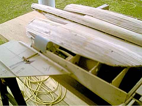

Thanks for the info/ comments. I hadn't thought about the lift curve so as I progress, I'll watch the throw. I watched the Su video of your plane, Dan, and it looks like it flys quite well. I'll try and upload a couple of pics. Right now I have a BB 48 oz servo and 4-40 rod, but just for a mockup. The surface moves quite easily but too much 'give'. I'll need aluminum arm and probably 3/16 th to 1/4" rods

Let me try once more to get the right pic!

Yeah, you don't want to have the elevon pushrods bending under load. Daren almost lost his prototype model that way.
Your model is looking good so far. Thanks for the pics.
